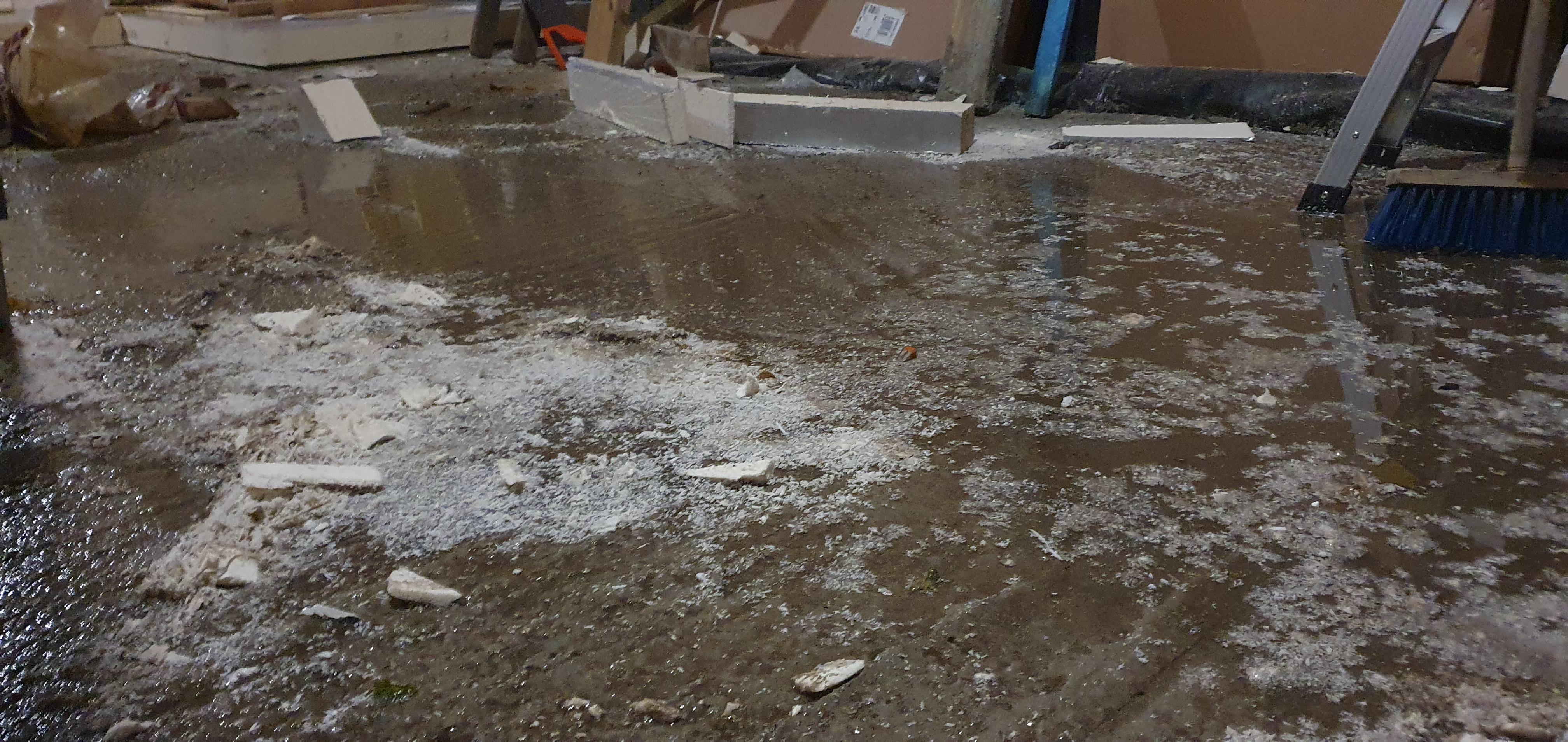

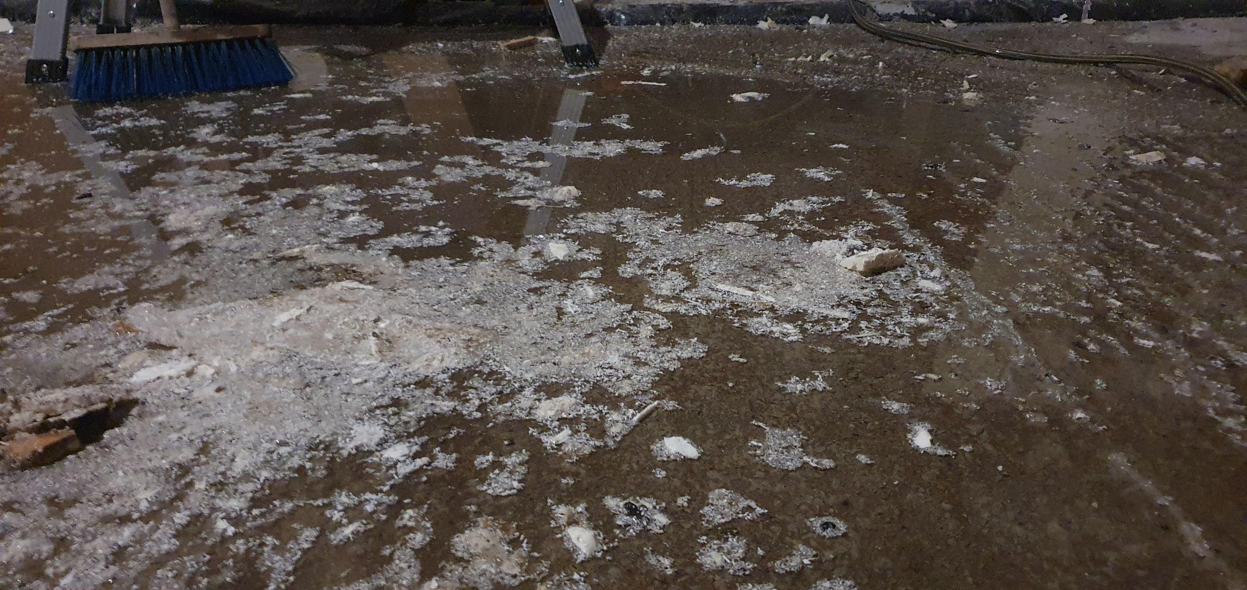

CARBr6 Posted November 1, 2021 Posted November 1, 2021 Before I managed to get the roof on my extension we had a deluge of rainfall and now I have a few mm of excess rain water pooled in various points in my extension. I have tried using a water butt pump (as that was the only pump I have) and that worked for a short while. But now the water is so shallow that the pump can't suck it up any further. I need to get my celotex boards down so I can move along with the project. Does anyone have any hints and tips for removing pooled water in your build (aside from drilling holes into the floor for drainage) TIA
Roundtuit Posted November 1, 2021 Posted November 1, 2021 Brush it off, or if the surface is smooth enough, floor squeegee? (foam blade, not solid rubber, are best)
Gus Potter Posted November 1, 2021 Posted November 1, 2021 Try a softer broom. Chase the water to the low point. Rope in a helper with a dust pan, hand brush and pail.. scoop water into pail. Dry the last bit with an old towel. Check your damp proof membrane positions. Now you will have a nice clean surface to lay your cellotex on?
saveasteading Posted November 2, 2021 Posted November 2, 2021 3 hours ago, Gus Potter said: Check your damp proof membrane positions. Do you have a dpm under the concrete? If so the PIR boards will trap the water in the concrete for ever. That would be a bad thing. I will have to think why, but it just is.
Hilldes Posted November 2, 2021 Posted November 2, 2021 (edited) Ditto @markc This was one of the best £80 I spent on tools for my build. It rained on the dpm for our slab and we needed it totally dry for the tape to join dpm. This was brilliant in wet mode for that. Used it extensively in dry mode as a dust extractor for cutting wood and pir insulation also… https://www.toolstation.com/draper-20l-wet-dry-vacuum-cleaner/p63354 Edited November 2, 2021 by Hilldes 1
