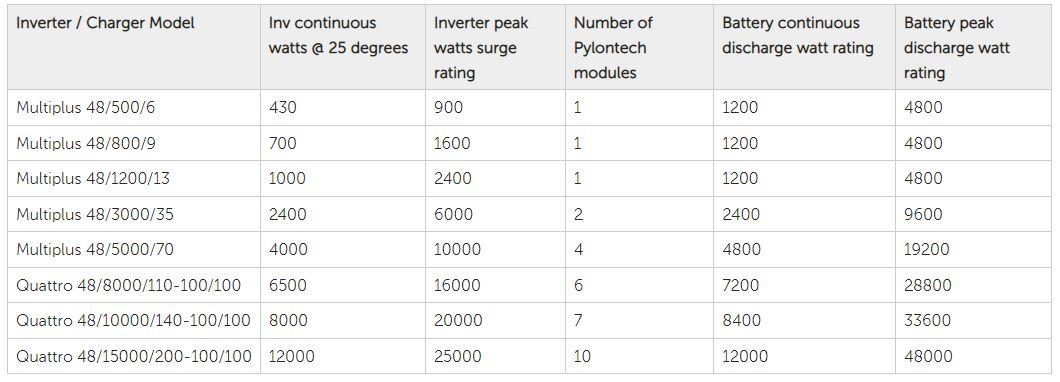

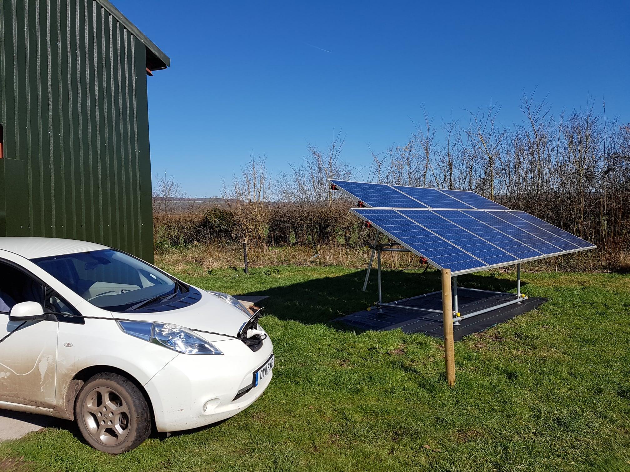

Smallholder Posted November 4, 2021 Author Share Posted November 4, 2021 (edited) 2 hours ago, gc100 said: Could you give me more information on this battery storage you are planning to use? I would like to get some for my solar but it’s not adding up currently but that seems ‘cheap’ When I built the solar setup for the barn, I had a good look at battery options and ended up going with Pylontech US3000 batteries. These I got for under a grand each (48v, 3.5kWh capacity and 90% D.O.D), and they can be daisy chained up to a max of 8 units, without any need for additional hardware. I initially got one battery, then added a second about 6 months later. There was a lot I had to learn to create this fairly small and simple set up. One example, was that each battery has a max current that it can take in terms of charging/discahrging. So if you are looking to take a relatively high load out through an inverter, you may need more batteries so that the load you're taking can be split across these batteries. See image attached. Edited November 4, 2021 by Smallholder 1 Link to comment Share on other sites More sharing options...
