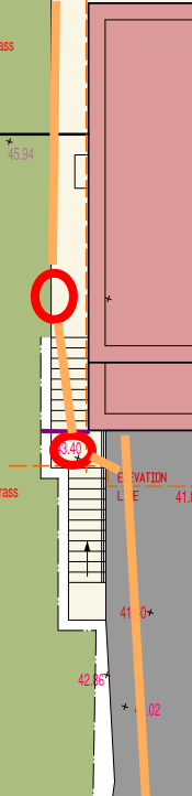

Moonshine Posted October 27, 2021 Author Share Posted October 27, 2021 Thanks, i think i will do it in two back drops of about 1.5 - 1.8m each, something like this, the red circles being the back drops. in that image what is the connector from the 110mm bend to the IC inlet? Link to comment Share on other sites More sharing options...

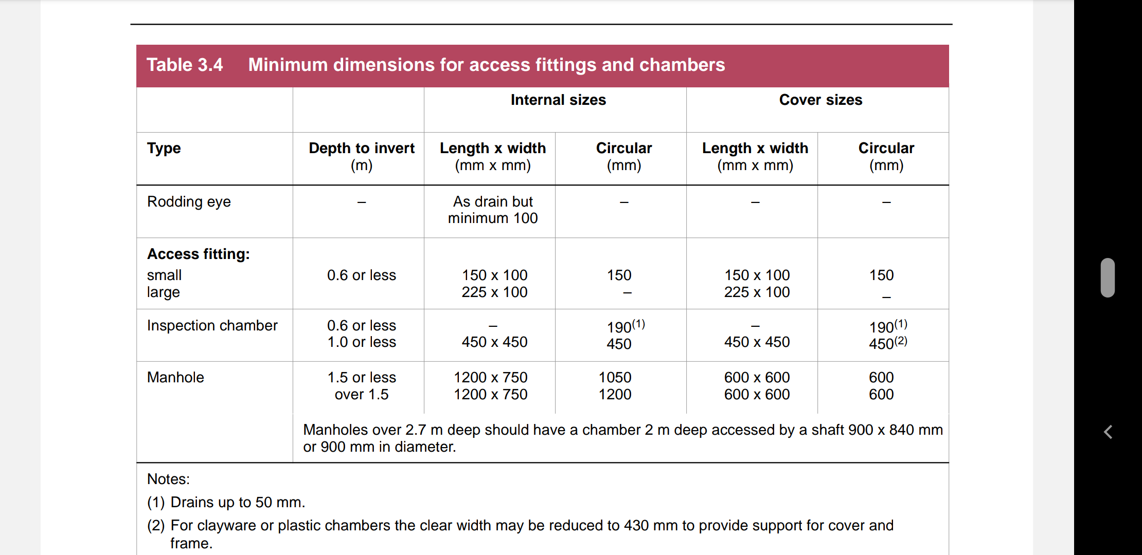

Conor Posted October 27, 2021 Share Posted October 27, 2021 (edited) Check the regs. I'm pretty sure you'll need to use a 1200mm ring for that kind of depth. We used 1200mm concrete rings and cut slot in midway up for the inlet. From the NI building regs: Edited October 27, 2021 by Conor Link to comment Share on other sites More sharing options...

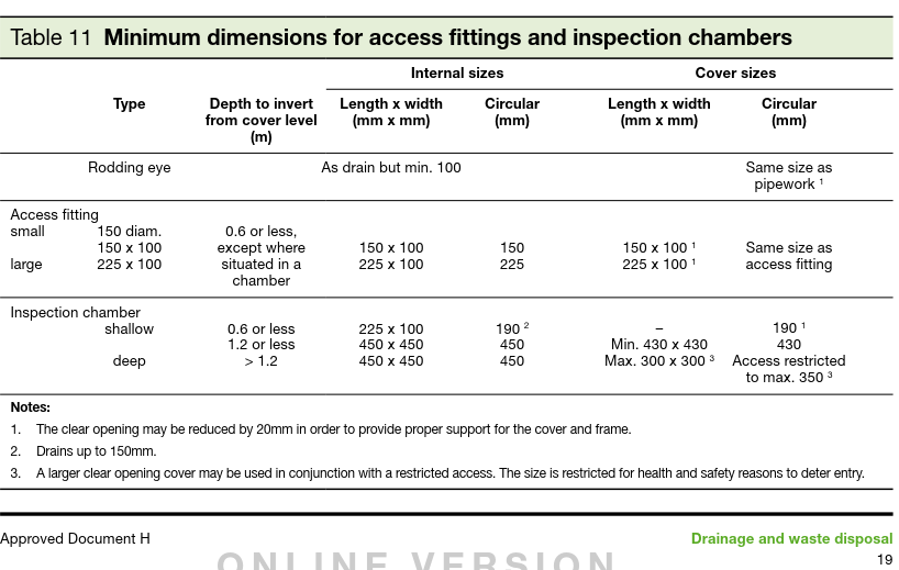

Moonshine Posted October 27, 2021 Author Share Posted October 27, 2021 3 minutes ago, Conor said: Check the regs. I'm pretty sure you'll need to use a 1200mm ring for that kind of depth. Good shout, though table 11 of ADH says 450mm diameter for 1.2m deep and deeper, but with access restricted access as per @Dave Jones Link to comment Share on other sites More sharing options...
Conor Posted October 27, 2021 Share Posted October 27, 2021 That's for an inspection chamber tho. You're creating a backdrop manhole, which should be constructed to allow, not deter access. I'd speak to your BCO to see what is expected. Link to comment Share on other sites More sharing options...

Gordo Posted October 27, 2021 Share Posted October 27, 2021 (edited) 5 hours ago, Conor said: That's for an inspection chamber tho. You're creating a backdrop manhole, which should be constructed to allow, not deter access. I'd speak to your BCO to see what is expected. The England guidance is different to NI guidance on depths of IC. ICs are not intended for people to enter where as MHs are. That’s why they have to be larger. In England they accept ICs at greater depths with a restricted opening at top to stop people trying to enter it. You have to use remote tools for clearing a blockage. a dropped MH could have rodding access to the vertical stack so you can rod down to lower level drain. Edited October 27, 2021 by Gordo Link to comment Share on other sites More sharing options...
