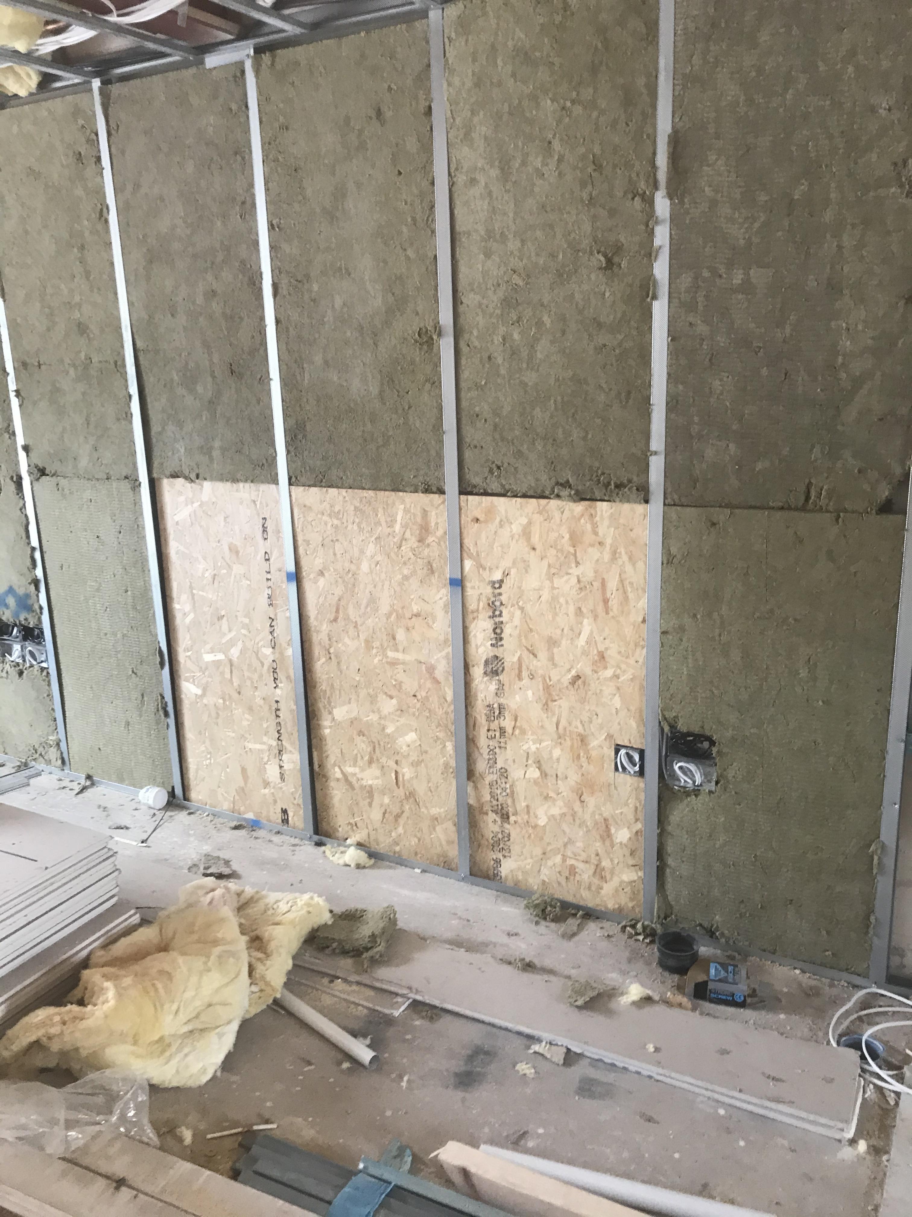

I used that silicon isolation adhesive stuff and set new studs about 10mm off the existing brick wall, I isolated, as best I could the top and bottom from the house by trimming the floorboards back from the wall removing the physical connection to the wall where they had been mortared in.
I then stuffed it with an sound insulation rockwool type thing. I then boarded it and had it skimmed. It works well. The isolation and hefty wad of rockwool stuff I think did the trick. Nothing too fancy to be honest, just using basic techniques to isolate.
It works well, if I was doing it all again I would have probably done an OSB sheet then plasterboard, reason being we experimented with this in the build and have some really good sound properties by just using thick studs, OSB and PB. It more or less looked like a timber frame version of what Nod posted above.
Maybe even used soundboard then normal PB but at the time I had 100's of sheets of PB so it suit to use that.
I didn't go in for proprietary systems because they all seemed like solutions to problems that could be solved by being clever with fixings and insulation. I did contemplate resilient bar but decided I didn't like the way the wall would be supported.

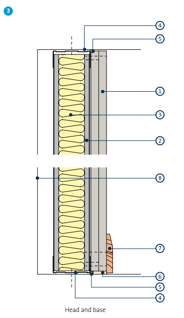

19 minutes ago, Adsibob said:
Now I'm confused as @nod is saying to forget C-studs but the Brtish Gypsum link you've linked to gives the option of C studs.
C-Studs can only be used if you use a fixing bracket to the wall (as below) in the Gyplyner system (not as effective acoustically as you have connections to the existing wall), for the Gyplyner IWL (independent wall liner) it needs to be I-studs for rigidity.
Gypliner GL12 Bracket 395mm - ADA Fastfix Ltd
below if the key to that figure.
My C-studs are connected to the floor and ceiling using the U-channels, it doesn't touch the party wall at all.
You wouldn’t use them on c stud
They for gypliner
You would use c stud tack to make brackets
