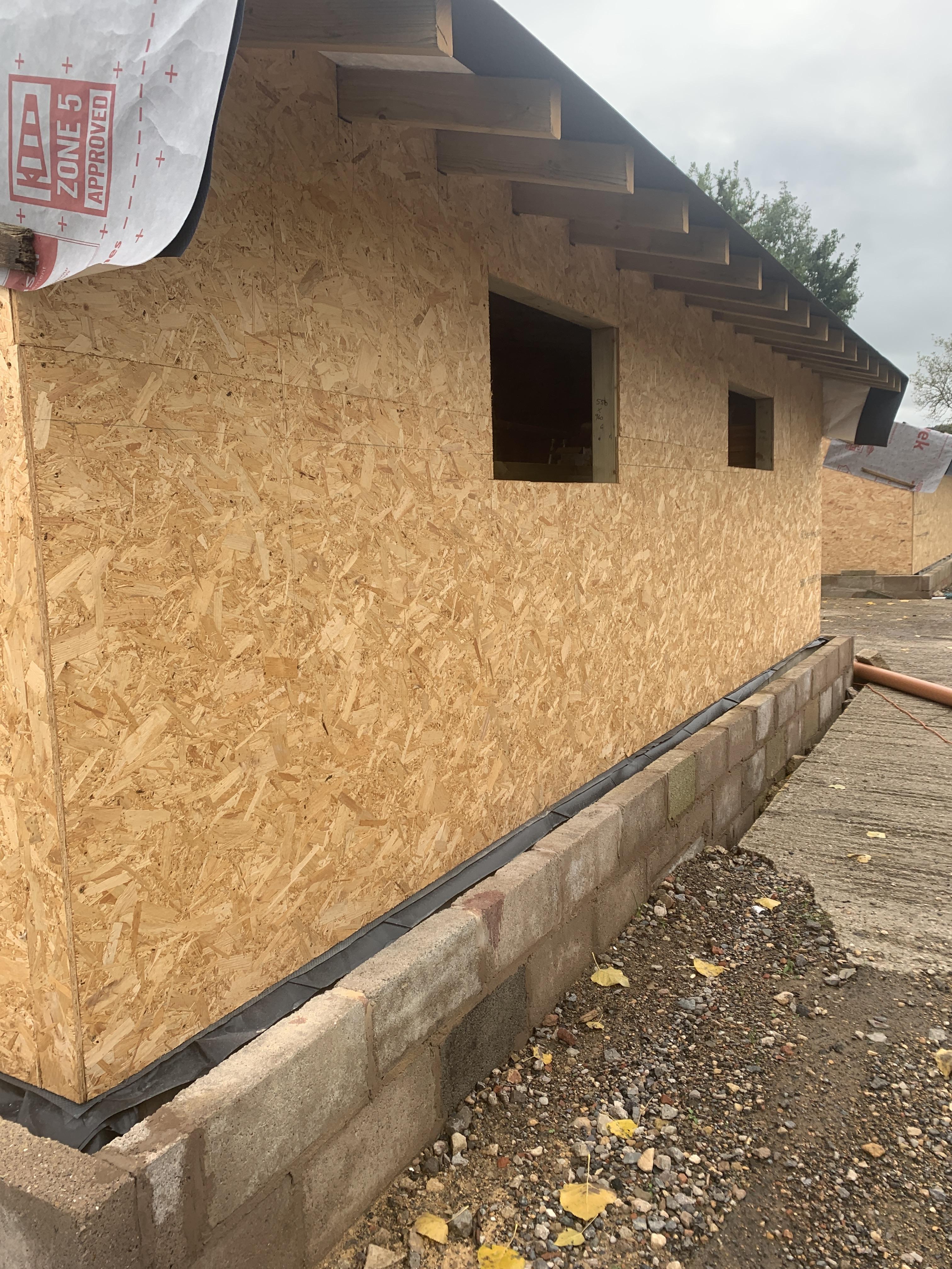

jen and mark Posted October 29, 2021 Author Share Posted October 29, 2021 Link to comment Share on other sites More sharing options...
jen and mark Posted October 29, 2021 Author Share Posted October 29, 2021 How do I upload more photos? Link to comment Share on other sites More sharing options...
markc Posted October 29, 2021 Share Posted October 29, 2021 Click to choose files at bottom of box then select pics from your library Link to comment Share on other sites More sharing options...
jen and mark Posted October 29, 2021 Author Share Posted October 29, 2021 Tried that - it says 'you are only allowed to upload 5.86MB'? Link to comment Share on other sites More sharing options...
markc Posted October 29, 2021 Share Posted October 29, 2021 Just now, jen and mark said: Tried that - it says 'you are only allowed to upload 5.86MB'? Ahh, I never use hi res for pics so never have a file size problem. Link to comment Share on other sites More sharing options...

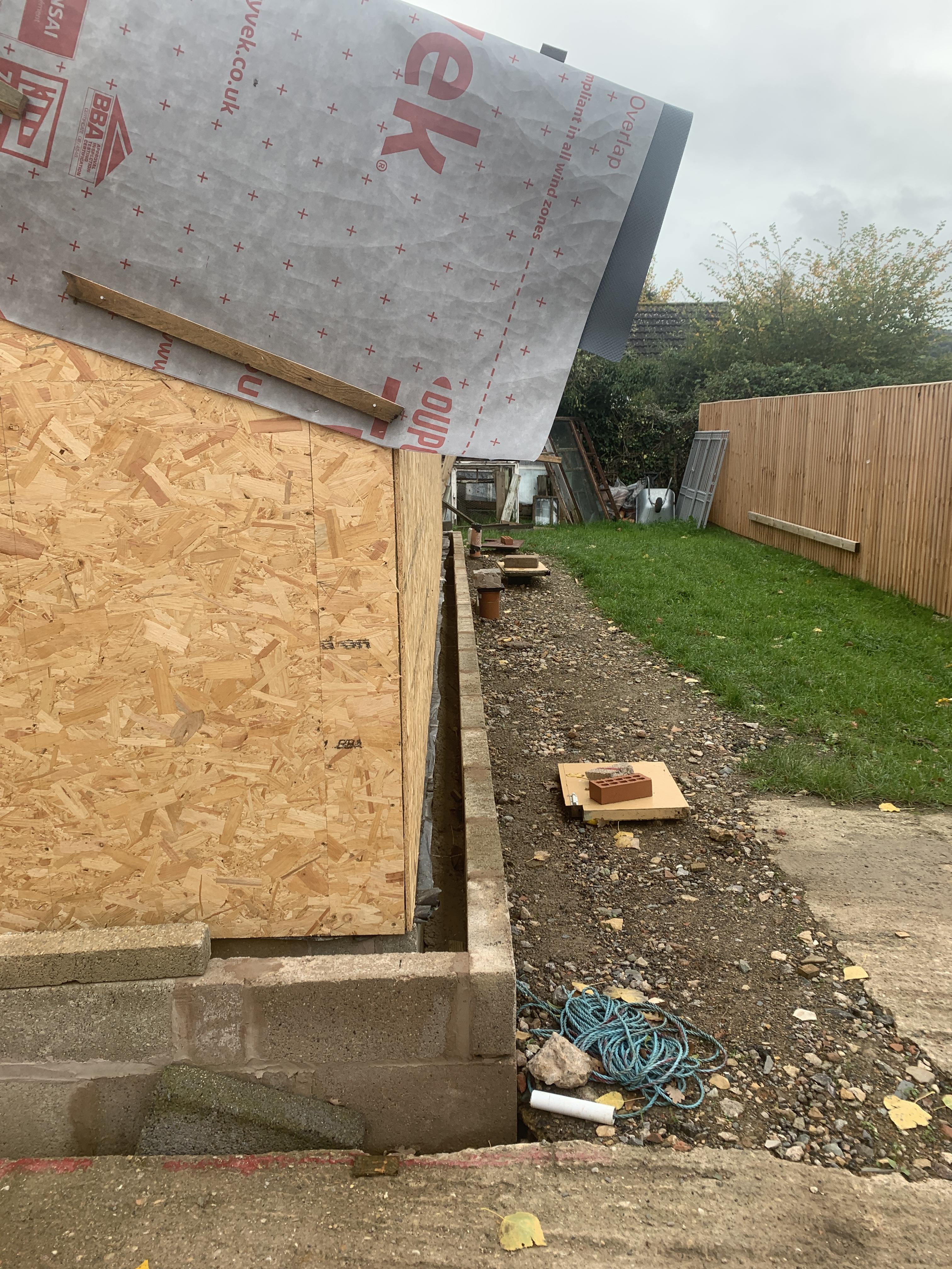

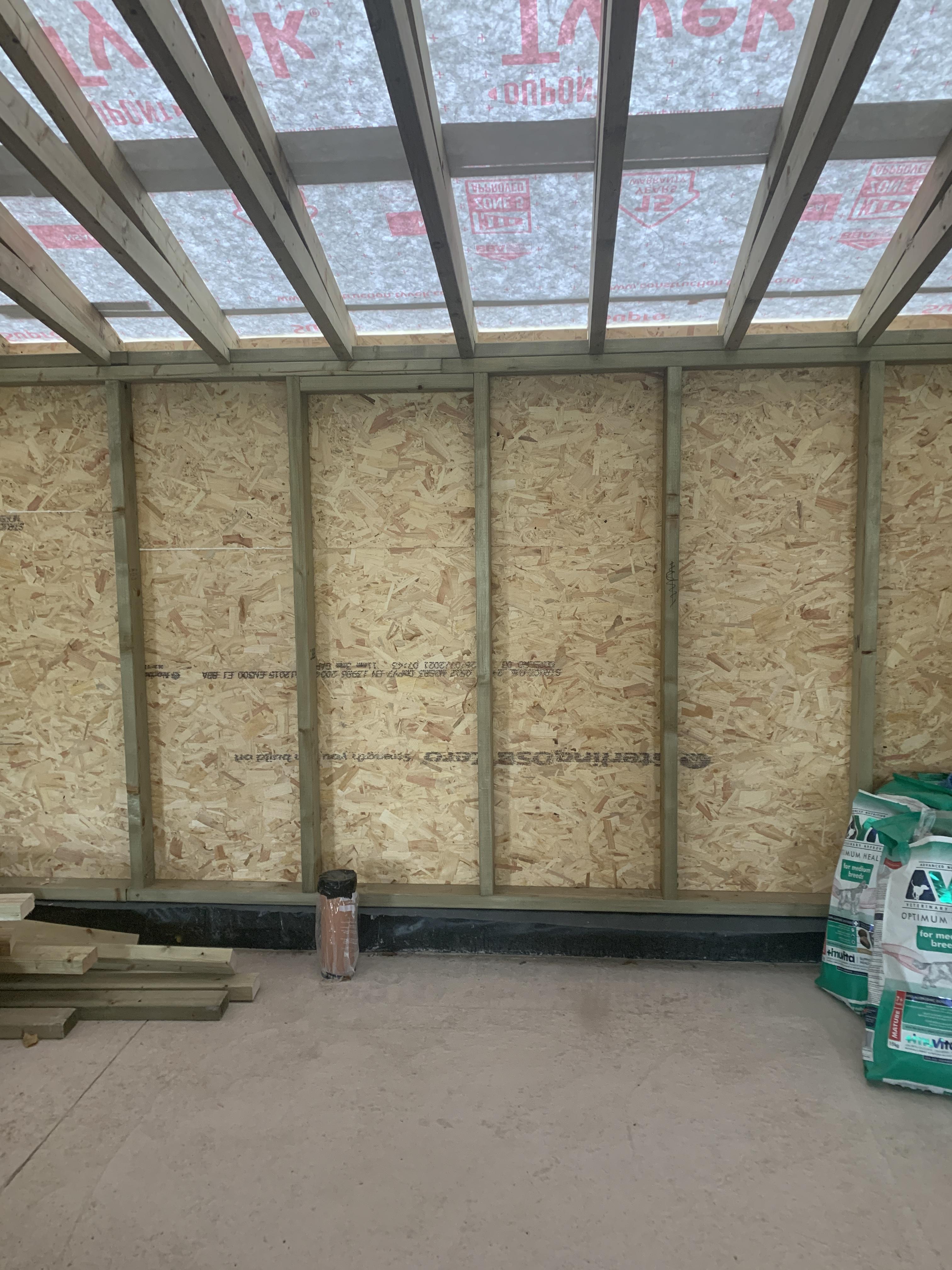

Iceverge Posted October 29, 2021 Share Posted October 29, 2021 Thanks for the pic, How wide is the cavity shown and I'll try to determine a cheap solution. Link to comment Share on other sites More sharing options...
jen and mark Posted October 29, 2021 Author Share Posted October 29, 2021 I'll try one at a time! Link to comment Share on other sites More sharing options...
Iceverge Posted October 29, 2021 Share Posted October 29, 2021 150mm? Link to comment Share on other sites More sharing options...
jen and mark Posted October 29, 2021 Author Share Posted October 29, 2021 Cavity ranges from 100mm - 120mm and outer stud would be 2x4 Link to comment Share on other sites More sharing options...
jen and mark Posted October 29, 2021 Author Share Posted October 29, 2021 sorry, 100 - 110mm Link to comment Share on other sites More sharing options...

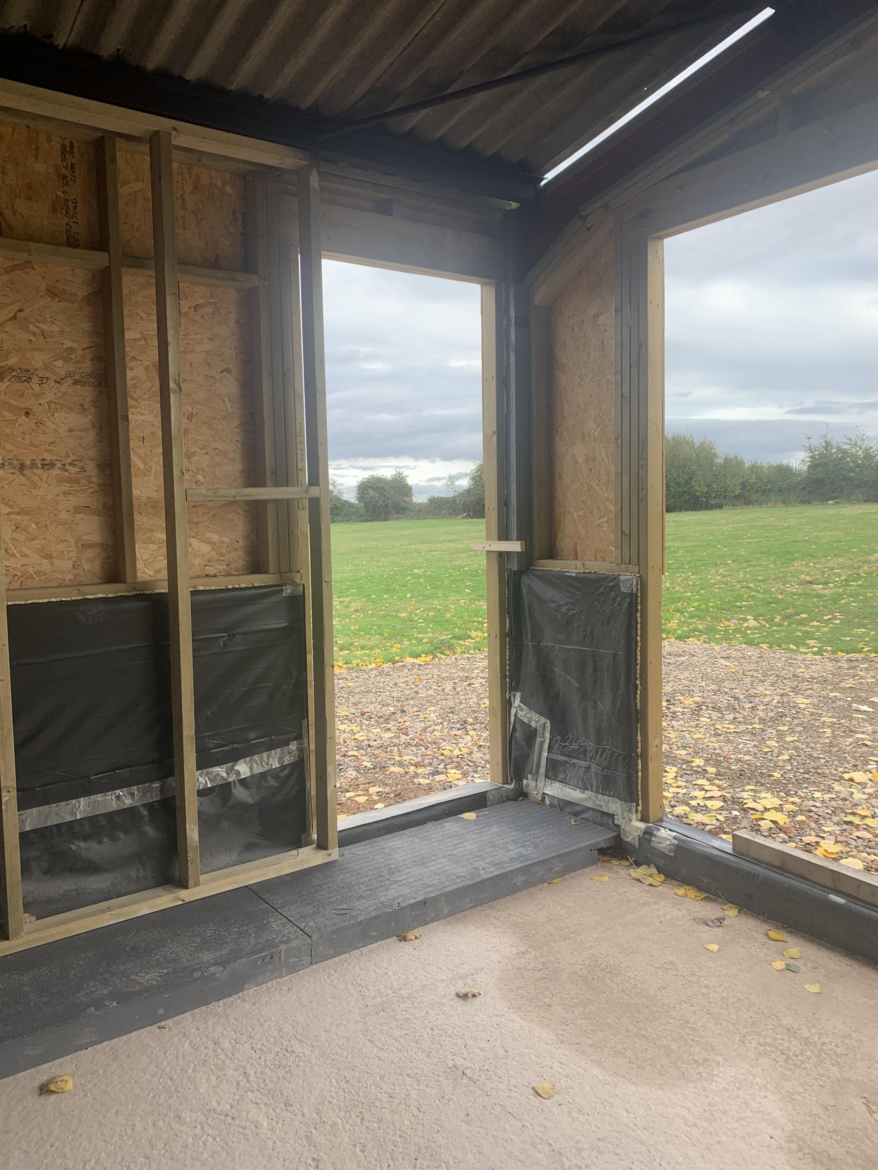

jen and mark Posted October 29, 2021 Author Share Posted October 29, 2021 Inside stud wall for services Link to comment Share on other sites More sharing options...
jen and mark Posted October 29, 2021 Author Share Posted October 29, 2021 Inside main barn showing outer block and stud wall and 25mm cavity then inner stud wall just being built. 100mm Ravatherm insulation below 1st sole plate and 2nd sole plate on top Link to comment Share on other sites More sharing options...

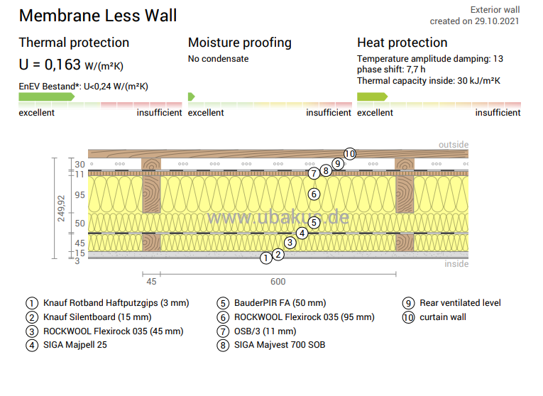

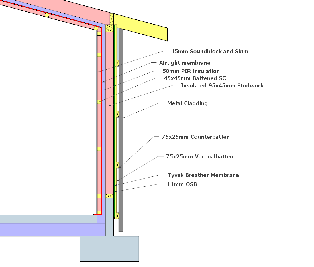

Iceverge Posted October 29, 2021 Share Posted October 29, 2021 (edited) Thanks for getting back to me. I've had a think. Firstly winter is coming. You need to get this closed in as quickly as possible. If cost is a priority I'd forget double framing. Timber and sheet materials are gone far too expensive. It was pioneered in the States where they get extremely cold and prolonged winters and lumber is (was?) cheap. Neither are true at the moment in our fair isles. It might seem like a kick in the teeth but I think you are better off knocking down the 2 courses of external blockwork and getting on with your external cladding. I would also take down the internal studwall being built. My proposed build up is as follows. 15mm Soundblock plasterboard + Skim 45x45mm battened service cavity @600cc insulated with 50mm Frametherm 35 or similar. Airtightness membrane. 50mm PIR. 95x45mm structural stud with 100mm Frametherm 35 insulation. 11mm OSB sheathing, Tyvek breather membrane. 75x25mm treated vertical batten. 75x25mm treated counter batten. You could increase the PIR layer if you're really chasing U values but 0.16 is more than adequate I wager. If PIR is too dear you could omit this but it will really help with the 4ft section of block wall to bring that up to a good level of insulation. by forming a continuous layer of it you would really minimise any thermal bridges with the existing structure. Nothing to stop you using seconds for the PIR. However I would be slow to go above 50mm+45mm service cavity as screws get expensive above 150mm. https://www.secondsandco.co.uk/product-page/50-55mm-kingspan-non-foil-1-2-x-2-4 I reckon that it'll be £18/m2 less and a lot less labour. I'll have a look at the roof if I get a chance tomorrow however a quick google suggests it is a very expensive way of purchasing insulation. Are you absolutely totally committed to this thickness? Edited October 29, 2021 by Iceverge 2 Link to comment Share on other sites More sharing options...
