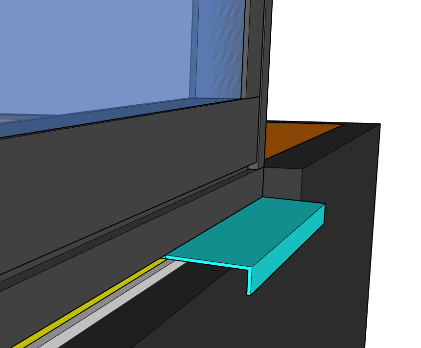

Iceverge Posted October 26, 2021 Posted October 26, 2021 I'd be tempted to put an aluminium sill dripping into an channel drain to deal with this with insulation behind.

Hilldes Posted October 26, 2021 Author Posted October 26, 2021 On 26/10/2021 at 13:07, Iceverge said: I'd be tempted to put an aluminium sill dripping into an channel drain to deal with this with insulation behind. Expand Yeah, I'm thinking a cill like this.... - in turquoise that oversells the insulation and whatever covering I'll use on the outside of the insulation. I did want to specify cills with the bifolds but the supplier did not have them as an option. I know of a company that produces pressings to order (they produced the cills for my Velfac order). I'll need to continue the external covering for the insulation into the reveal - which might be easier with render than other options such as slate. Not sure though on the need for a drainage channel - given the paving will be some way below the cill and will be sloping down away from the house.

Iceverge Posted October 26, 2021 Posted October 26, 2021 On 26/10/2021 at 18:34, Hilldes said: Thanks @gravelld would be tempting to use PIR given I have some left over from inside, but somehow does not seem right below ground. Expand I think any plastic insulation will be just fine so long as it's not sitting in a pool of water. That sill looks A1 so long as it won't break from someone standing on it.
Hilldes Posted October 27, 2021 Author Posted October 27, 2021 On 26/10/2021 at 21:43, Iceverge said: That sill looks A1 so long as it won't break from someone standing on it. Expand That is the key challenge I think as it will be cantilevering 70mm.

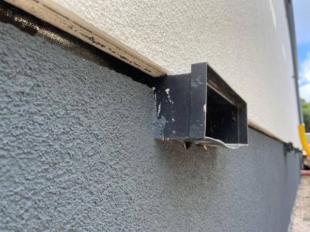

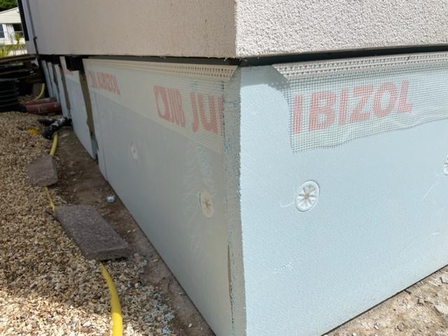

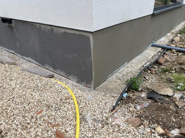

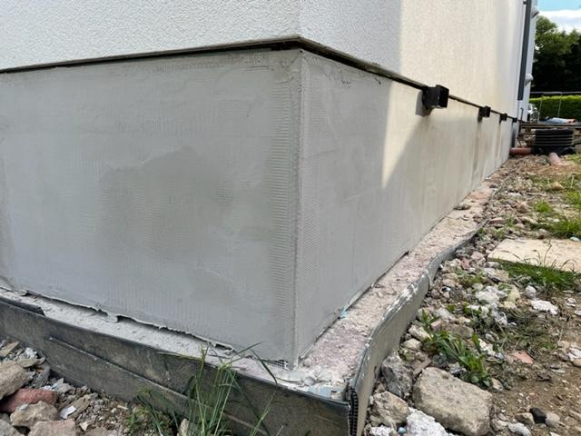

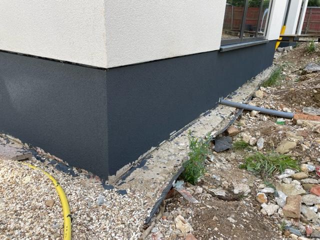

Hilldes Posted June 21, 2022 Author Posted June 21, 2022 So the area below DPC is now completed. These are JUB products: 50mm XPS Insulation - fixed mechanically and chemically (the glue was the same product as base coat render I think). Fixed to 140mm concrete blockwork. Base coat render (right) then primer for top coat (left) Top coat render
