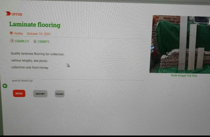

Trying to explain to my mate why cladding his workshop in laminate flooring he's planning to get from Freecycle etc is not a good idea. For example:
- Some have MDF cores. Moisture will get at it from the back.
- Joint profile is completely wrong for shedding water. Multiple entry points for rain to get in.
-  Even a blockboard substrate probably isn't made suitable for external use.
Help me out with a sentence or two why it's a really bad idea!
I saw what happened when the FiL made a shed by cladding an old greenhouse frame in MDF and covering it in roofing felt. Eventually the MDF became so sodden, the weight of the felt alone broke the MDF apart.
I got the perfect answer, one word to.  Shame there is a swear filter.
I don't think you will.
Get him to put some MDF in his chosen surface protector  outside for the winter.
