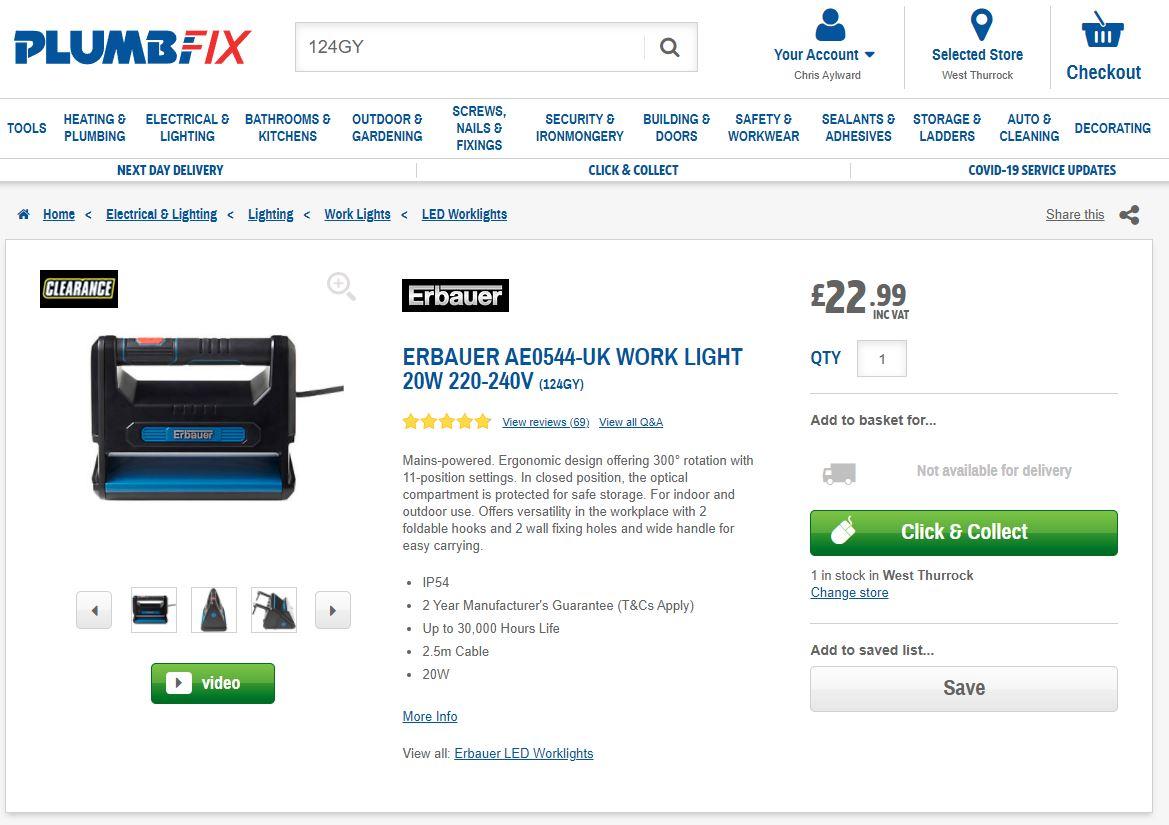

bikerchris Posted January 15, 2022 Author Share Posted January 15, 2022 21 hours ago, SteamyTea said: That is about 2/3rd of my total lighting load. I have to confess, I'm temporarily using this to light the room https://www.screwfix.com/p/erbauer-ae0544-uk-work-light-20w-220-240v/124gy?_requestid=92042 Link to comment Share on other sites More sharing options...
