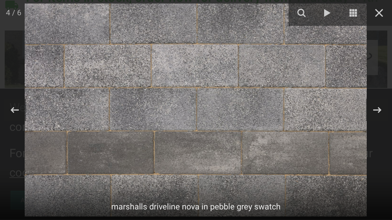

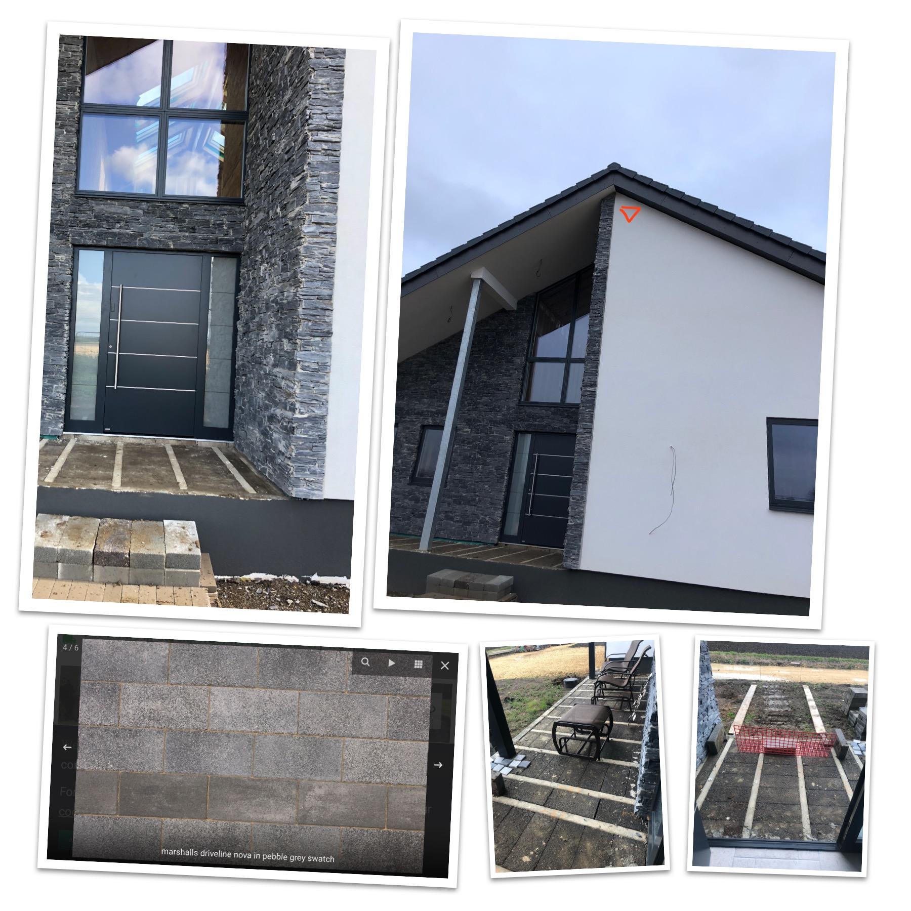

Mandana Posted October 5, 2021 Author Share Posted October 5, 2021 One of the landscapers had a good idea today which was to wet each of the samples we can and stick them in the freezer. I did that (wet them twice) and I got my answer as to what we can have on the wheelchair slope … and it’s not porcelain! If I want to break my coccyx again or have even more titanium in my spine then porcelain would be fine, but no! The porcelain was an ice rink!! Far too dangerous, so instead we will put the same as we’re putting on the garage slopes - Marshall’s Driveline Nova course. Not aesthetically as beautiful, but far safer. Link to comment Share on other sites More sharing options...
