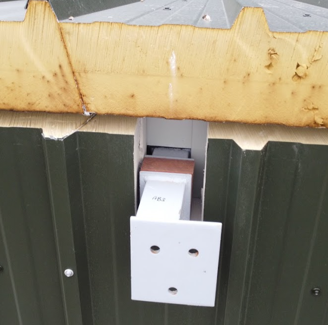

We've used armatherm structural thermal breaks in a variety of places, which like the Farrat are I think commonly used for steel balcony connections
https://www.armatherm.co.uk/products/frr-structural-thermal-break-material/
They can provide bushings and washers as well
thermal bridging
Not expensive.
I believe stainless steel bolts give reduced heat transfer.
While I'm not a professional, even if I wasn't concerned about heat transfer I wouldn't want any structural steel running through the envelope on a building intended to last 100+ years. What if the outer end gets wet and rusts? Wouldn't want to have to replace the entire beam. In that, I'd want the balcony to be replaceable independently of the main structure.
We don't have any balconies, but we have an awning bracket which is similar. The stuff that looks like wood is the armatherm FRR:
  • Like 1
