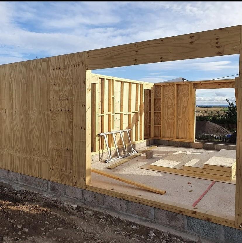

Mike_scotland Posted September 27, 2021 Author Share Posted September 27, 2021 5 minutes ago, SteamyTea said: Yes. The thing to remember is that you need to stop cold, outside air, blowing across/through the insulation. If air flows across/through insulation, it is the same as having a greater wall area to loose energy through. im not sure what it is, i thought plywood was not waterproof but OSB was hmmm ill need check with my builder this evening for clarity. Link to comment Share on other sites More sharing options...
BMcN Posted September 27, 2021 Share Posted September 27, 2021 5 minutes ago, Mike_scotland said: im not sure what it is, i thought plywood was not waterproof but OSB was hmmm ill need check with my builder this evening for clarity. I would expect your kit will be sheeted in 9mm OSB to provide racking strength and then covered in a breather membrane. Also I would let your installer/manufacturer spec the size of the ASHP. Mine is a similar spec and size to what you have suggested and I have a 10kw ASHP with 300L tank. Link to comment Share on other sites More sharing options...

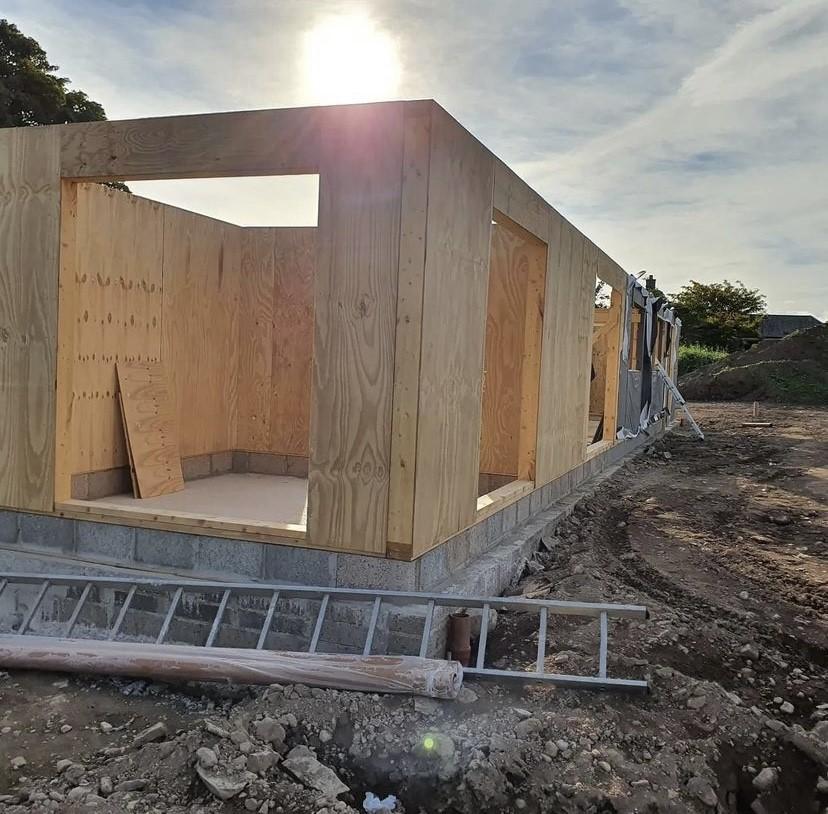

Mike_scotland Posted September 27, 2021 Author Share Posted September 27, 2021 im assuming this is not OSB? looks like ply now i see it Link to comment Share on other sites More sharing options...

SteamyTea Posted September 27, 2021 Share Posted September 27, 2021 7 minutes ago, Mike_scotland said: im assuming this is not OSB? looks like ply now i see it Looks like shuttering ply. Link to comment Share on other sites More sharing options...
BMcN Posted September 27, 2021 Share Posted September 27, 2021 Normally the structural engineer will have a report stating everything like stud sizes & numbers, lintel sizes, loadings, racking strength etc. On it it should state the sheathing material and nailing centres. Link to comment Share on other sites More sharing options...
Mike_scotland Posted September 27, 2021 Author Share Posted September 27, 2021 6 minutes ago, SteamyTea said: Looks like shuttering ply. good bad? normal, not normal? Link to comment Share on other sites More sharing options...
Mike_scotland Posted September 27, 2021 Author Share Posted September 27, 2021 i found a snippet from the building warrant looks legit enough 50 x 38 treated limber horizontal framing at not more than 600 mm centers on 50 x 50 treated limber vertical framing at centers to suit kit framing fixed through dpc over Protect TF200 Thermo breathable membrane on 10 mm thick sheathing ply on 140 x 45 timber framing Link to comment Share on other sites More sharing options...
SteamyTea Posted September 27, 2021 Share Posted September 27, 2021 (edited) 18 minutes ago, Mike_scotland said: good bad? normal, not normal? Really don't know. There is nothing inherently wrong with using ply, as long as it is the correct sort. Sheets are usually marked up somewhere, so you should be able to find out what it is. https://www.trada.co.uk/publications/info-from-other-organisations/the-builders-guide-to-plywood/ Edited September 27, 2021 by SteamyTea 1 Link to comment Share on other sites More sharing options...
