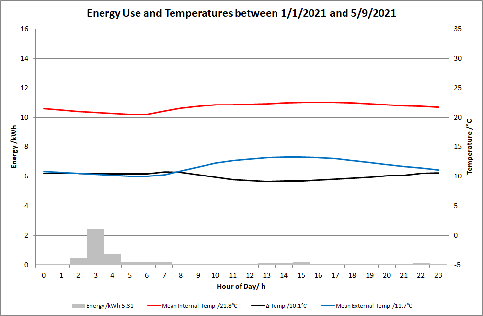

Have you ever logged your actual energy usage by the hour, then seen what you can shift to the times that PV will most likely be producing.
Something like this:

How hot do you think stored water needs to be?
Here are my temperatures, and I don't run out.

7 minutes ago, Mike_scotland said:
and these temps are all from your ASHP producing the HW?
No, I am on E7.  So resistance heating.
The grey columns shows my usage (two charts up), but if I had an ASHP, the heating time could easily be shifted by 10 hours.
