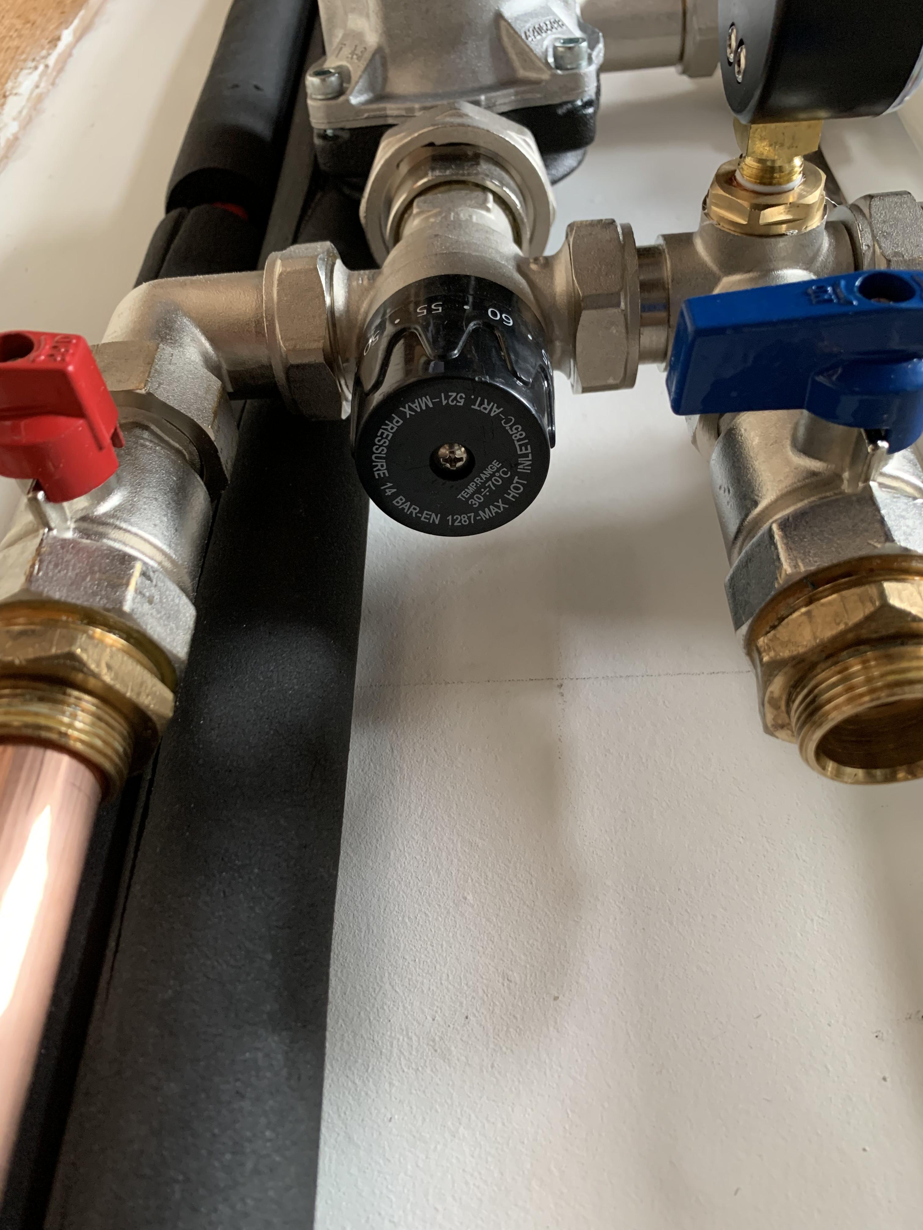

vala Posted September 23, 2021 Share Posted September 23, 2021 I need to set up my pumpset for my UFH system and the mixing valve supplied by Wunda has the hot on the left, cold on the right. However when fitted the marker to show what temperature its set to would be at the back and not visible. Are they all like this? Link to comment Share on other sites More sharing options...
RHayes Posted September 24, 2021 Share Posted September 24, 2021 @Vala Most mixing valves you can remove the marker and dial and rotate them through 180 degrees (without turning the mechanisim in the valve) so that the marker and temperture set can be read from the front if the valve. Pop a picture on here if it helps, can check it over. 1 1 Link to comment Share on other sites More sharing options...

vala Posted September 27, 2021 Author Share Posted September 27, 2021 On 24/09/2021 at 08:21, RHayes said: @Vala Most mixing valves you can remove the marker and dial and rotate them through 180 degrees (without turning the mechanisim in the valve) so that the marker and temperture set can be read from the front if the valve. Pop a picture on here if it helps, can check it over. @RHayes This is the mixer valve in question Link to comment Share on other sites More sharing options...

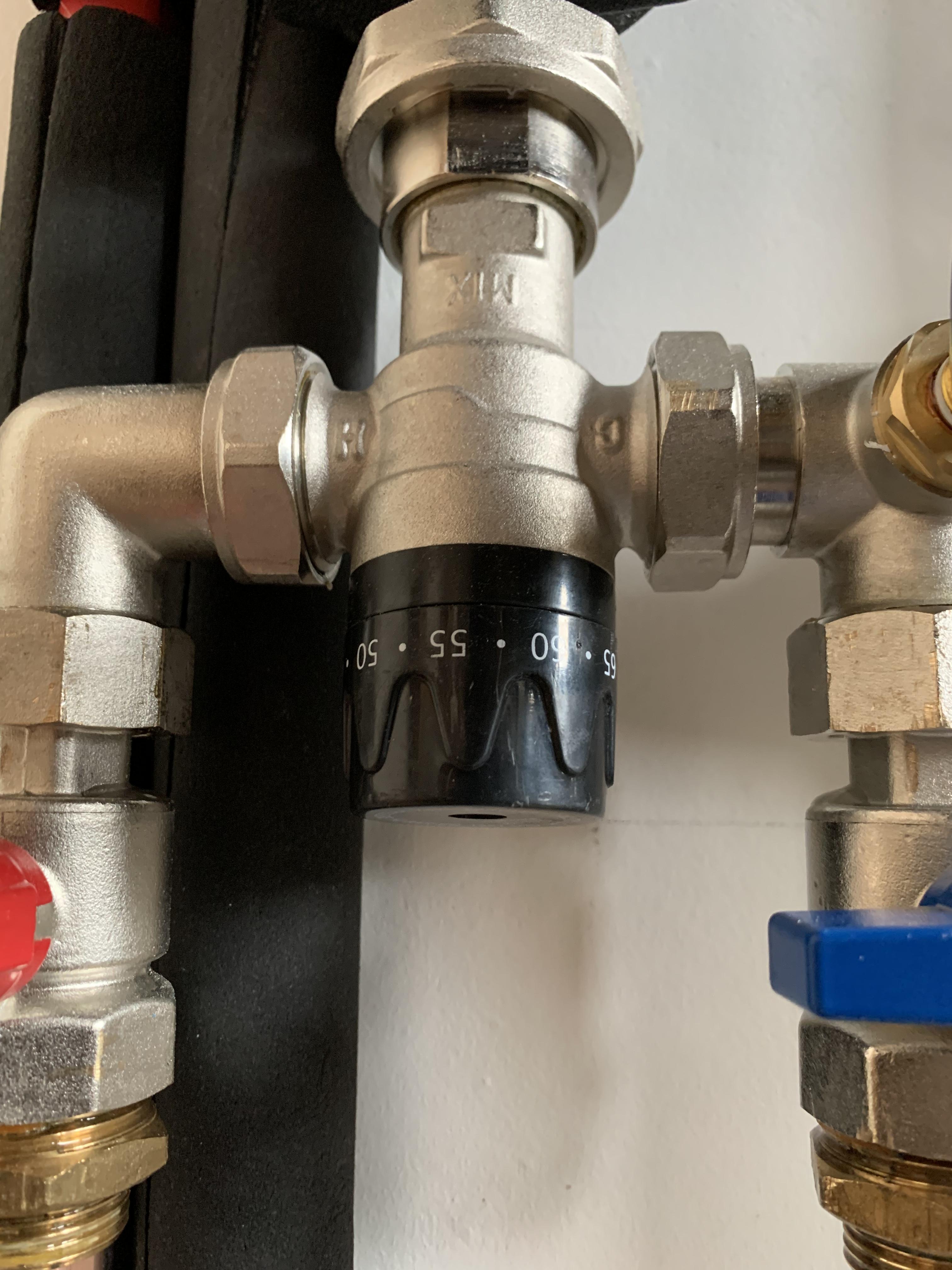

dpmiller Posted September 27, 2021 Share Posted September 27, 2021 undo the screw, pull knob and index straight off, re-fit in reverse order to your liking 1 Link to comment Share on other sites More sharing options...
vala Posted September 29, 2021 Author Share Posted September 29, 2021 My system is in the testing phase under pressure but as I was tidying up I thought I'd get this little job out of the way. Undid the screw, pulled the knob and index off, spun it round then tightened it back up. However I noticed that moving this dial affected the pressure. Which made me think...:should the mixing valve be open or closed whilst pressure testing? Link to comment Share on other sites More sharing options...
RHayes Posted October 27, 2021 Share Posted October 27, 2021 It shoudn't matter re the mixing valve. It is probably just a case of the moving part inside adjusting the volume where the pressrure gauge is connected. Ultimately if there is no pressure lost through the red and blue valves then all is well. Link to comment Share on other sites More sharing options...
