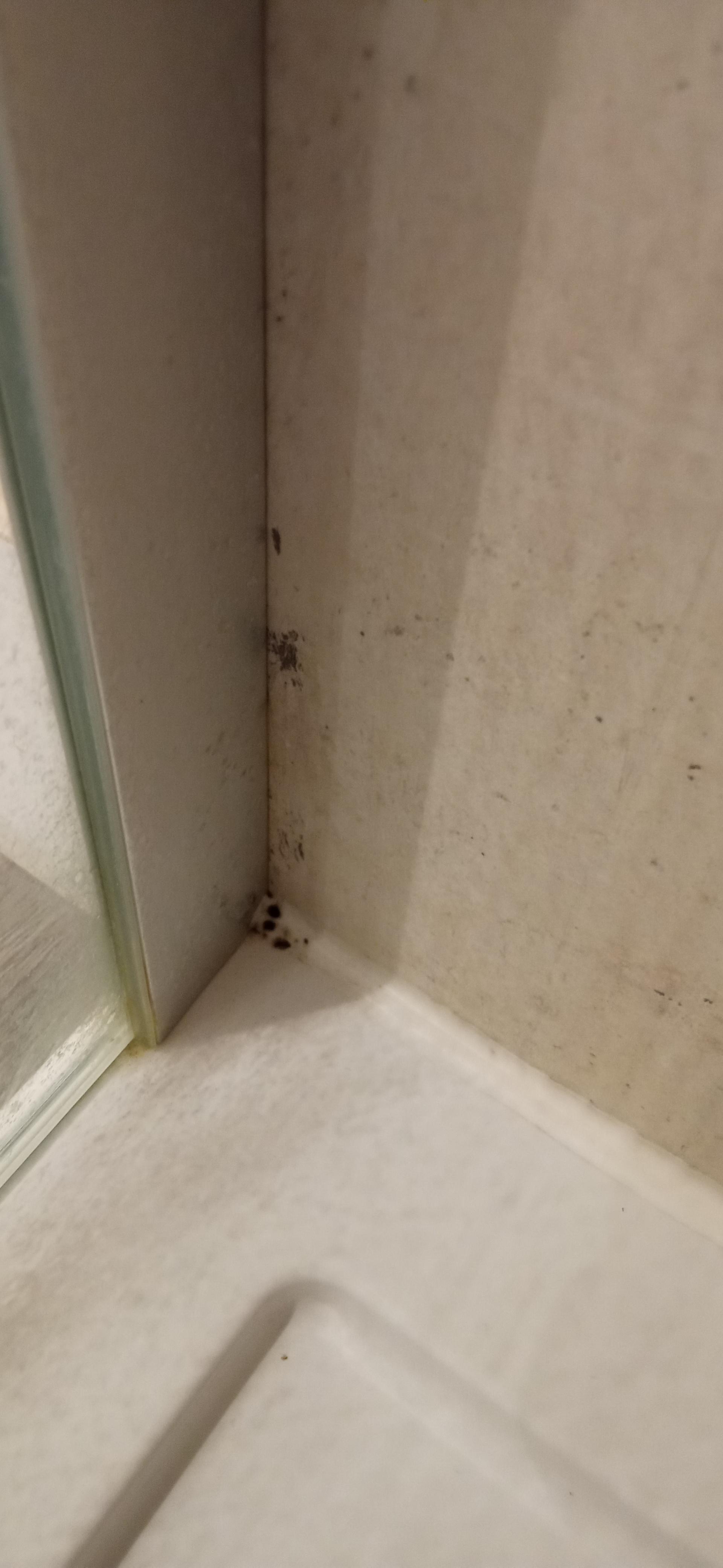

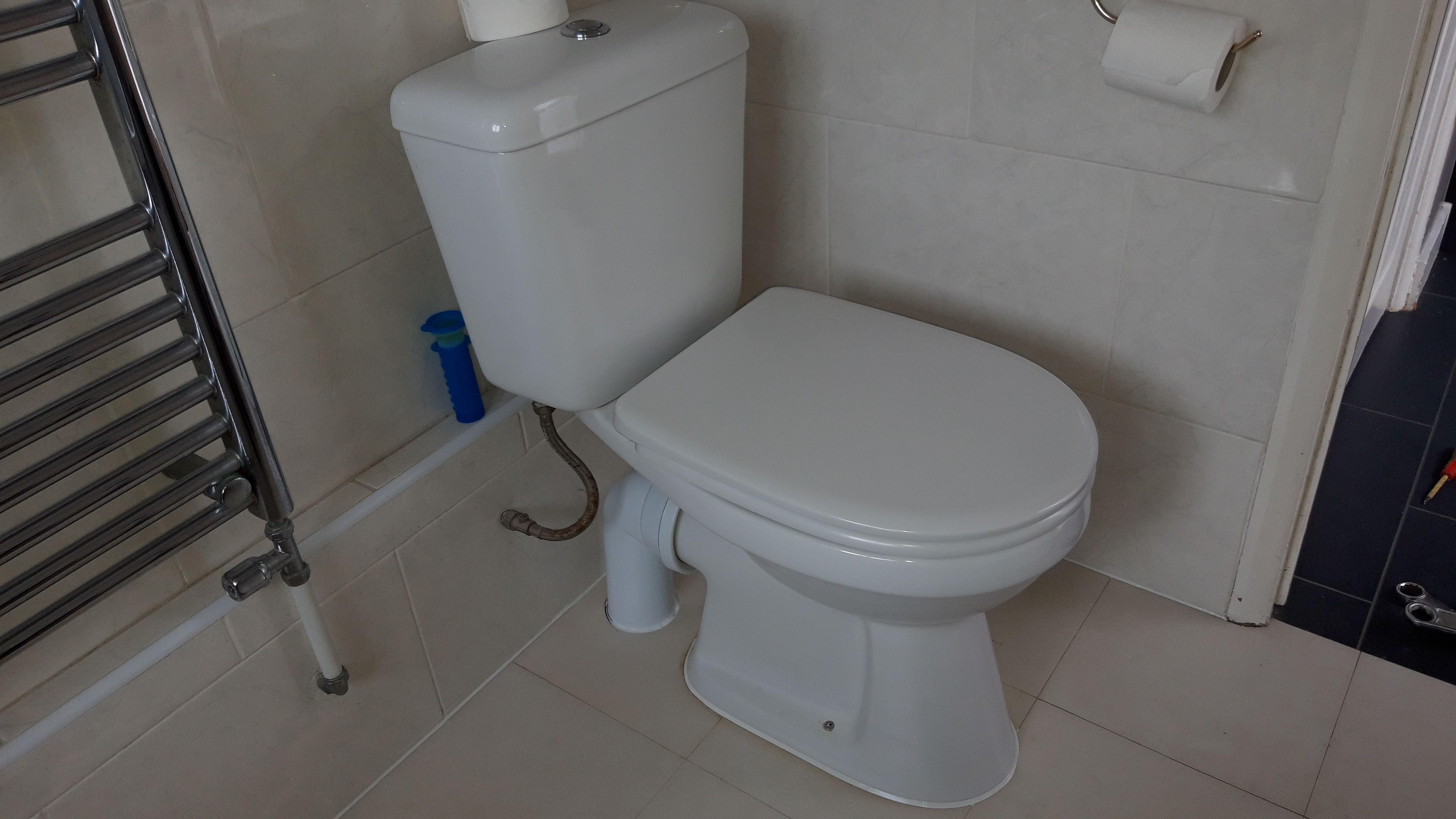

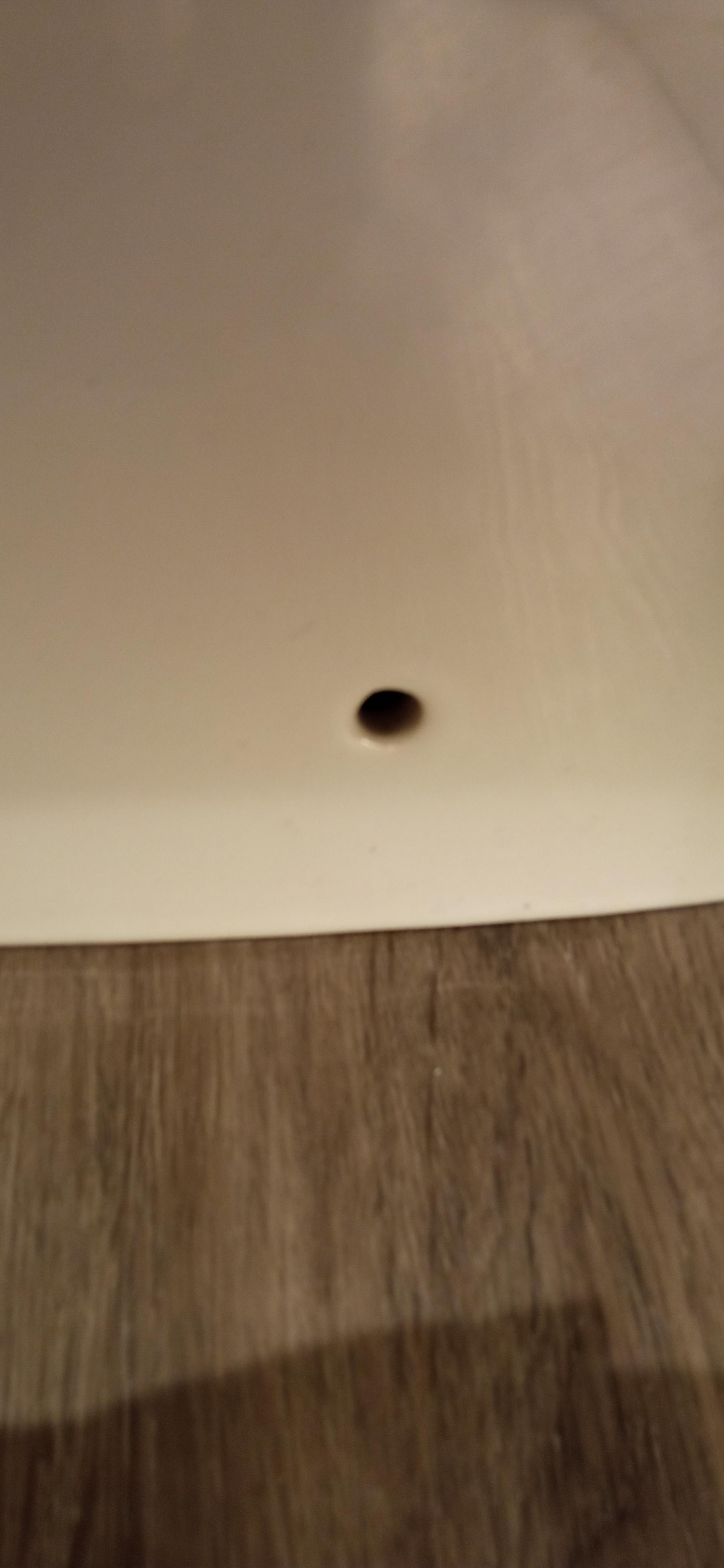

canalsiderenovation Posted September 16, 2021 Share Posted September 16, 2021 Couple of questions: Our plumber didn't seal round the toilets (they can't be screwed to the floor because of the UFH). I'm more competent than him to seal round them however I still haven't got round to this. Can anyone advise which sealant I should use? I've got a Screwfix and Toolstation order to put in so I want to get it ordered. Also, is there anything I can get to put in these holes - I presume this is where they would be fixed to the floor normally. Second question, I don't think our shower is sealed properly as we have noticed a bit of water running out at the bottom. I think there is a bit of a gap in the corner and water is coming and I'm happy to reseal it all. Should I get rid of the existing? If so what's the best way of getting it up? It is looking a bit grubby/moukdy in places and we haven't used it for a while and I haven't cleaned it because I don't know I'd I should just get it all up and start again (SWMBO and various hair dye things haven't helped). Again, is there a particular sealant I should order? Link to comment Share on other sites More sharing options...
gaz_moose Posted September 16, 2021 Share Posted September 16, 2021 (edited) dow conning 785 sanitary silicone for the shower. is your toilet actually fastened to the floor? you could put some white snap-caps over the holes or just fill them with white silicone, id silicone around the base aswell to stop nasties getting under it and smelling. im surprised they didnt just stick the brackets to the floor with contact adhesive. get some FUGI silicone smoothing tools if you dont already have some, then you can have beautiful looking silicone Edited September 16, 2021 by gaz_moose Link to comment Share on other sites More sharing options...

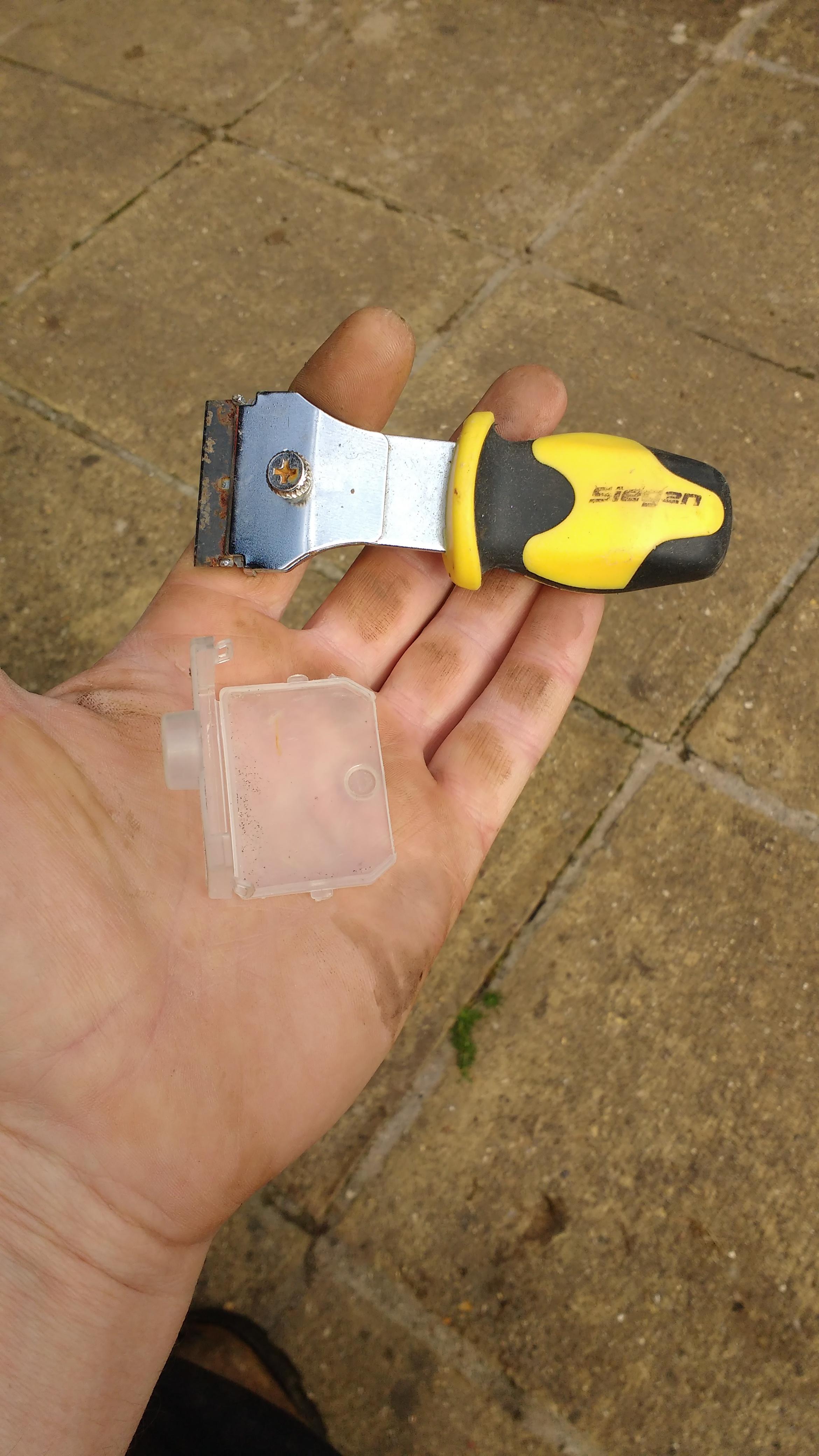

Onoff Posted September 17, 2021 Share Posted September 17, 2021 It's a pig getting silicone off to redo, proper hard graft imho. I have a Vitrex, plastic tool, silicone removal kit from SF. Not wonderful but I got there. I coupled it with one of these scrapers, the type that takes non Stanley blades. "Siegen" brand. Used this sparingly and lightly on tiles. Watch the glaze! Got mine from the local motor factors. It's razor sharp and be bloody careful. Tbh I wouldn't go near plastic with it and whatever, be oh so gentle. I also used the silicone removal gel from SF, not bad tbh. When I'd gotten as much off as I could I used CT1 Multisolve, let it work in as per the instructions, repeat. The cleaner you get it the less little bits will show in your eventual silicone. With the shower I'd get all the old off. Multisolve again, then pump clear CT1 into the gap and baby wipe flush. Once dry go over with a white silicone of your choice that can be periodically renewed. Be careful where you silicone. There's a good few threads on here about sealing shower screens and instead blocking drainage channels that are meant to be kept open. With the pan then clear CT1 would, 100%, stuck it down to the tiles with no screws. Multisolve bottom of the pan and tiles. A good bead of clear CT1 between the two and lower the pan onto it, don't smear! Again wipe the excess off with baby wipes. Walk away and sh!t somewhere else for 36hrs whilst it goes off. For the white silicone thereafter I've been really impressed with Forever White by Everbuild. Does what it says and hasn't gone mouldy anywhere in my wetroom corner / around the bath. Seal the pan holes with it and a bead around where the pan sits on the tiles. +1 on the Fugi Cramer tool kit, it's mustard. Link to comment Share on other sites More sharing options...

canalsiderenovation Posted September 17, 2021 Author Share Posted September 17, 2021 35 minutes ago, Onoff said: Be careful where you silicone. There's a good few threads on here about sealing shower screens and instead blocking drainage channels that are meant to be kept open. Ooer I need to find these threads about where I should be sealing so I don't caus Yes I need to be super careful getting off the existing as it's on the tray and showerwall and I don't want to scratch it so I'll probably not use any blade. So clear CT1 to seal around loo but in the shower a white which can be Dow Conning 785, Forever White or BT1 or similar. I've ordered the Fugi kit, I aren't too bad at using silicone but anything that helps is a bonus! Link to comment Share on other sites More sharing options...
bassanclan Posted September 17, 2021 Share Posted September 17, 2021 I prefer Forever white silicone sealant. Never white ct1. Not keen on clear around the wc, would prefer white. If you are doing all siliconing you could use a coloured ct1 in grey and hich would be bombproof, but take a long time and a lot of patience/skill to apply This is a useful thing for removing stubborn old silicone https://www.screwfix.com/p/no-nonsense-sealant-remover-100ml/88987 The toilet floor fixing kit will have come with caps to cover those holes which can be siliconed in place. Link to comment Share on other sites More sharing options...

canalsiderenovation Posted September 17, 2021 Author Share Posted September 17, 2021 Thanks really helpful I'll get stuff ordered. When you say clear CT1 to seal between pan and floor and then seal around the pan with the white do you mean the white goes over the top once the clear has dried? 1 hour ago, Onoff said: Use clear CT1 to seal between pan and floor not around the pan. Let it set, i.e to glue the pan down then seal around the pan @bassanclan thanks for the link to silicone remover. That will help me get the existing stuff out without damaging things. I'll see if I can buy another toilet fixing kit as we don't seem to have one and just use the caps. Link to comment Share on other sites More sharing options...
Onoff Posted September 17, 2021 Share Posted September 17, 2021 18 minutes ago, canalsiderenovation said: When you say clear CT1 to seal between pan and floor and then seal around the pan with the white do you mean the white goes over the top once the clear has dried? Exactly that. Clean everything. I assume the pan is having to stay in place? Lever it up a bit and sit on some say 10mm if possible, packs, mind fingers! Clean under the pan edge as best with Multisolve and the tiles. Gun in the CT1. Remove packs and let the pan sit down into the CT1. Don't move it anymore. Baby wipe off the excess from pan and tiles, use a bit of Multisolve to help. Walk away, don't touch, don't FFS sit! A day and half later come back. Clean again with Multisolve and run a nice white bead of your chosen cosmetic silicone around where the pan meets the floor and tool off with the appropriate Fugi tool. Have your open bin bag and bits of big roll at the ready. 1 Link to comment Share on other sites More sharing options...
