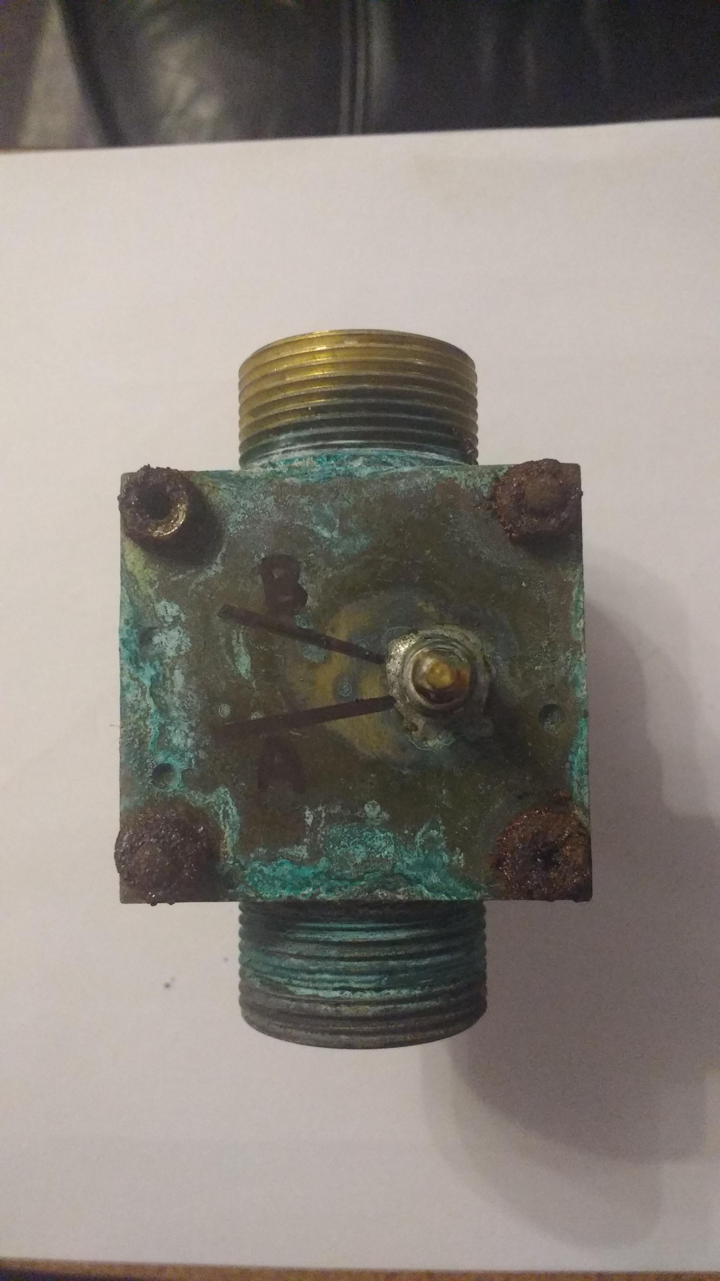

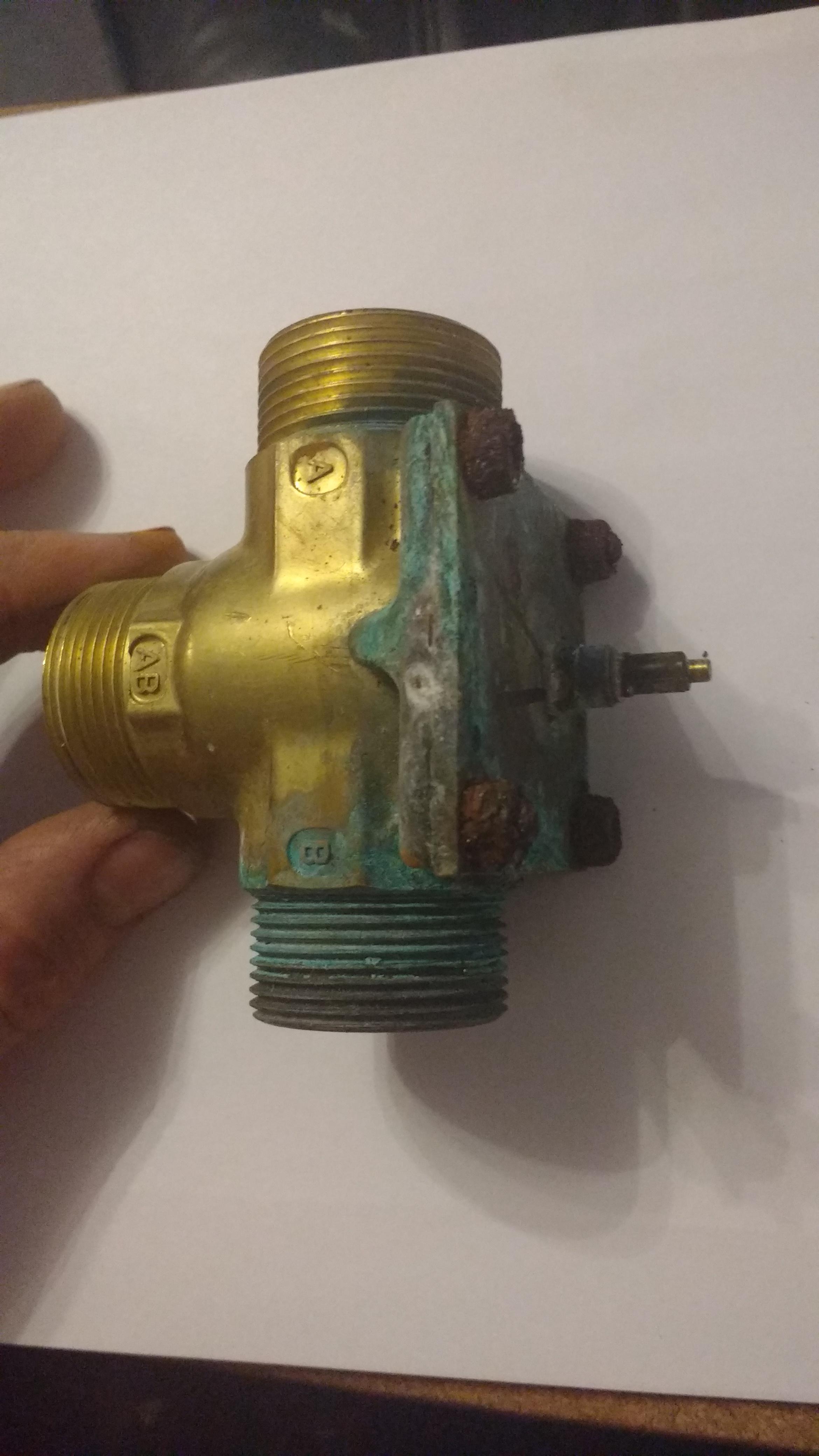

Onoff Posted September 7, 2021 Posted September 7, 2021 I think this was a Tower 3-port I took out VAL328MP mid position valve: Only moves this much:

Onoff Posted September 9, 2021 Posted September 9, 2021 (edited) I'll dunk this Tower 3 port in a bucket of citric acid to de-rust the bolts. I'll strip it apart when done. A few thoughts if you DIY it: I fitted like for like originally, replacing Tower valves with the same. I dicked around replacing micro switches and other components here and there. I used PTFE tape as was on them when I took them off. All the valves leaked over time. I replaced the x2 2 ports and x1 3 port with Honeywell. This time, no PTFE tape just Jet Blue Plus thread sealing compound. Getting the old olives off; a multi tool with bi-metal blade (like hacksaw teeth) is good. The nuts on the Tower valve aren't the same thread as on the Honeywell. I was going to see if I could get away with reusing the Tower nuts/olives on the Honeywell valve...I couldn't even though both valves are for 28mm pipe. Edited September 9, 2021 by Onoff 1
