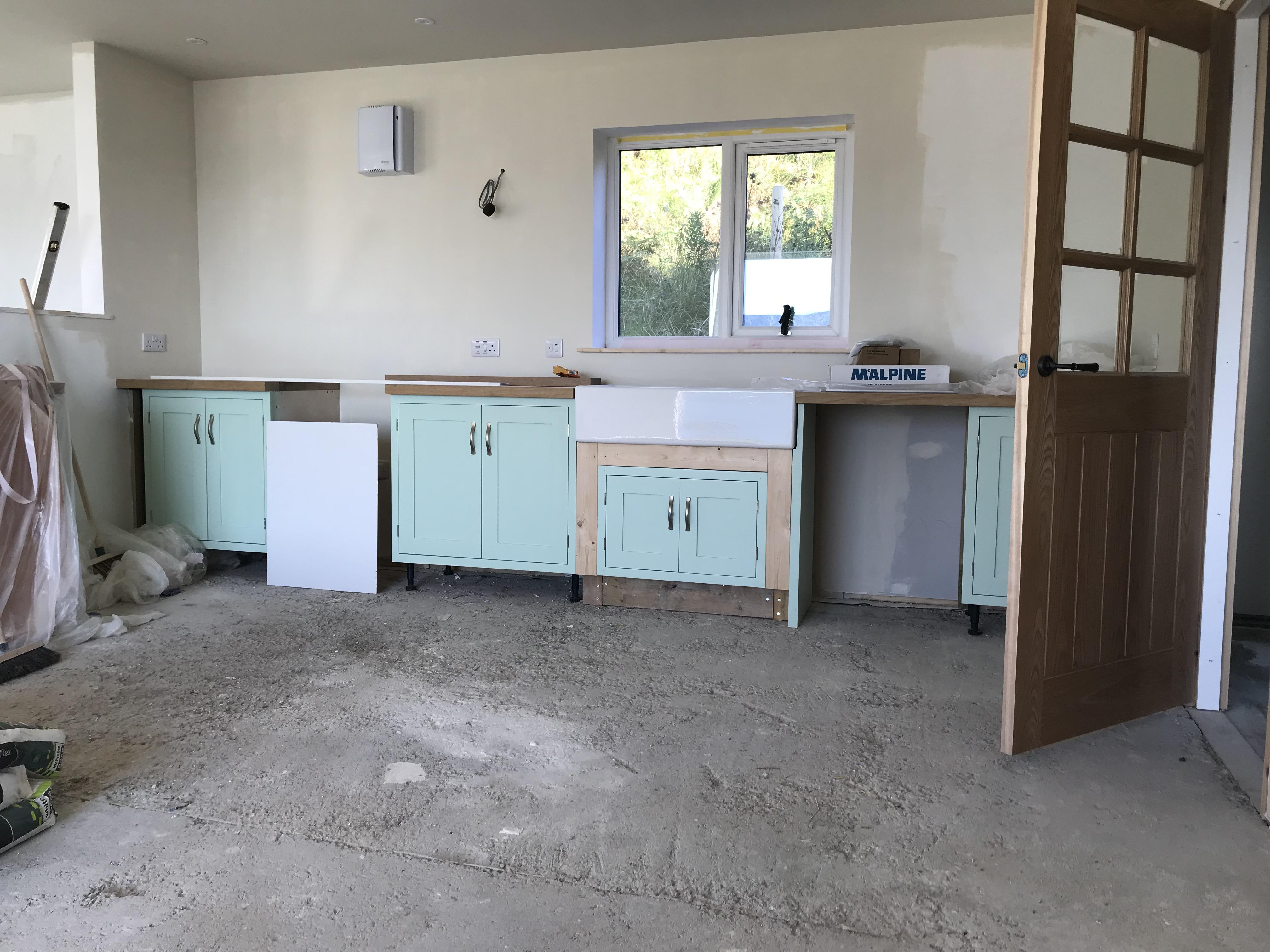

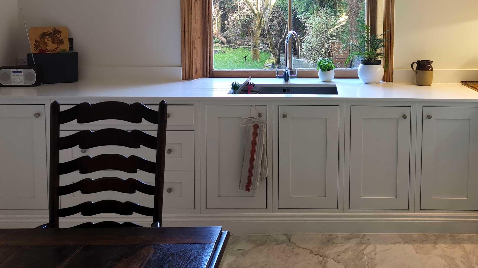

Grian Posted September 1, 2021 Share Posted September 1, 2021 I love the appearance of kitchens which have skirting (see cream kitchen example) rather than recessed kick boards, I think this would make my secondhand bargain units look pretty posh. I do appreciate it may be less ergonomic as you have to stand a few cm further back, but in case I prefer them I'm wondering how easily they are stabilised/attached compared to recessed? Also, I have a freestanding cooker and dishwasher so this may bugger it up as it couldn't have a normal skirting corner at those gaps in the run... Can anyone advise, and any experience on the ergonomics would be very welcome too. Thank you. Link to comment Share on other sites More sharing options...

joth Posted September 1, 2021 Share Posted September 1, 2021 Presumably the ergonomics impact could be mitigated by oversizing the worktop a bit? So it overhangs the skirting and your toes. Just beware that the top drawers still operate ok. (handless style doesn't work so well) Link to comment Share on other sites More sharing options...
Temp Posted September 1, 2021 Share Posted September 1, 2021 We have this. It's OK. Issues... A few times we have accidentally kicked a sharp outside corner in bare feet (ouch). Our sink is recessed and I do feel it in the back if there is a load of washing up. Think you will be OK with the Belfast sink if it's not too deep/low. The top edges of the skirting attract dirt. Link to comment Share on other sites More sharing options...
joe90 Posted September 1, 2021 Share Posted September 1, 2021 5 minutes ago, Temp said: The top edges of the skirting attract dirt. Yes and the whole point of a kick board being recessed is you can stand closer to the worktop, saves your back. Link to comment Share on other sites More sharing options...
