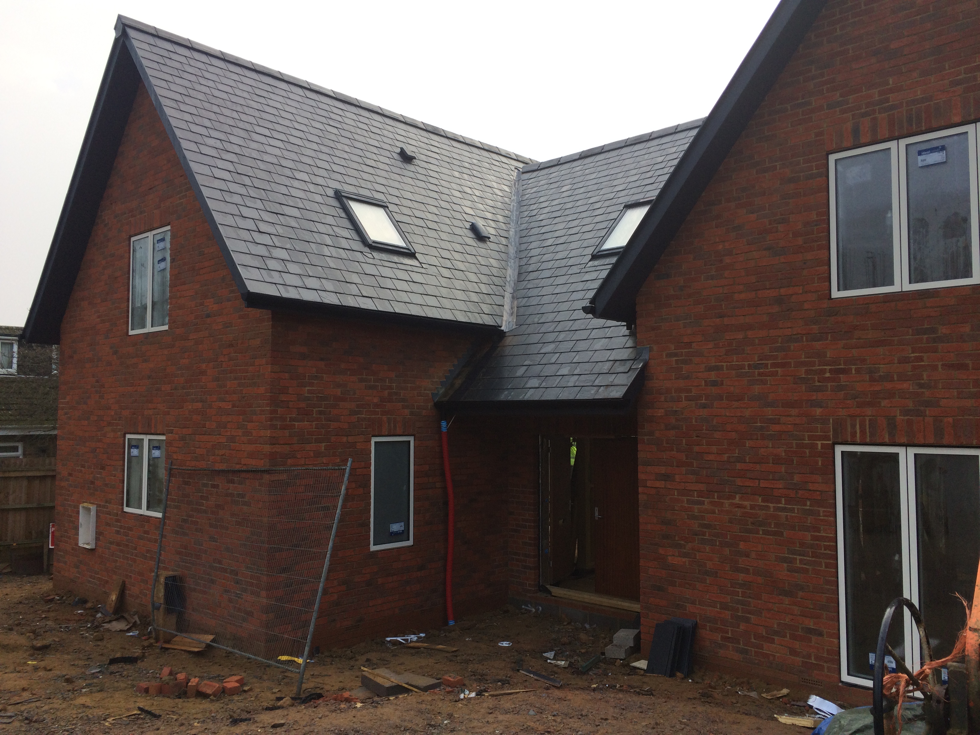

RandAbuild Posted March 26, 2017 Share Posted March 26, 2017 Take a look at IdealCombi windows https://idealcombi.com/ Triple glazed/aluminium clad & PUR, with slim 53mm profile. Triple glazed one has U value of 0.79. Here they are on our house in December last year (which is why it's so grey!) 1 Link to comment Share on other sites More sharing options...

RandAbuild Posted March 27, 2017 Share Posted March 27, 2017 We had 9 windows and 5 doors, including a 3.6m wide sliding doors with side windows and inward & outward opening french doors. The cost was £335/m2, exclusive of VAT. 1 Link to comment Share on other sites More sharing options...
