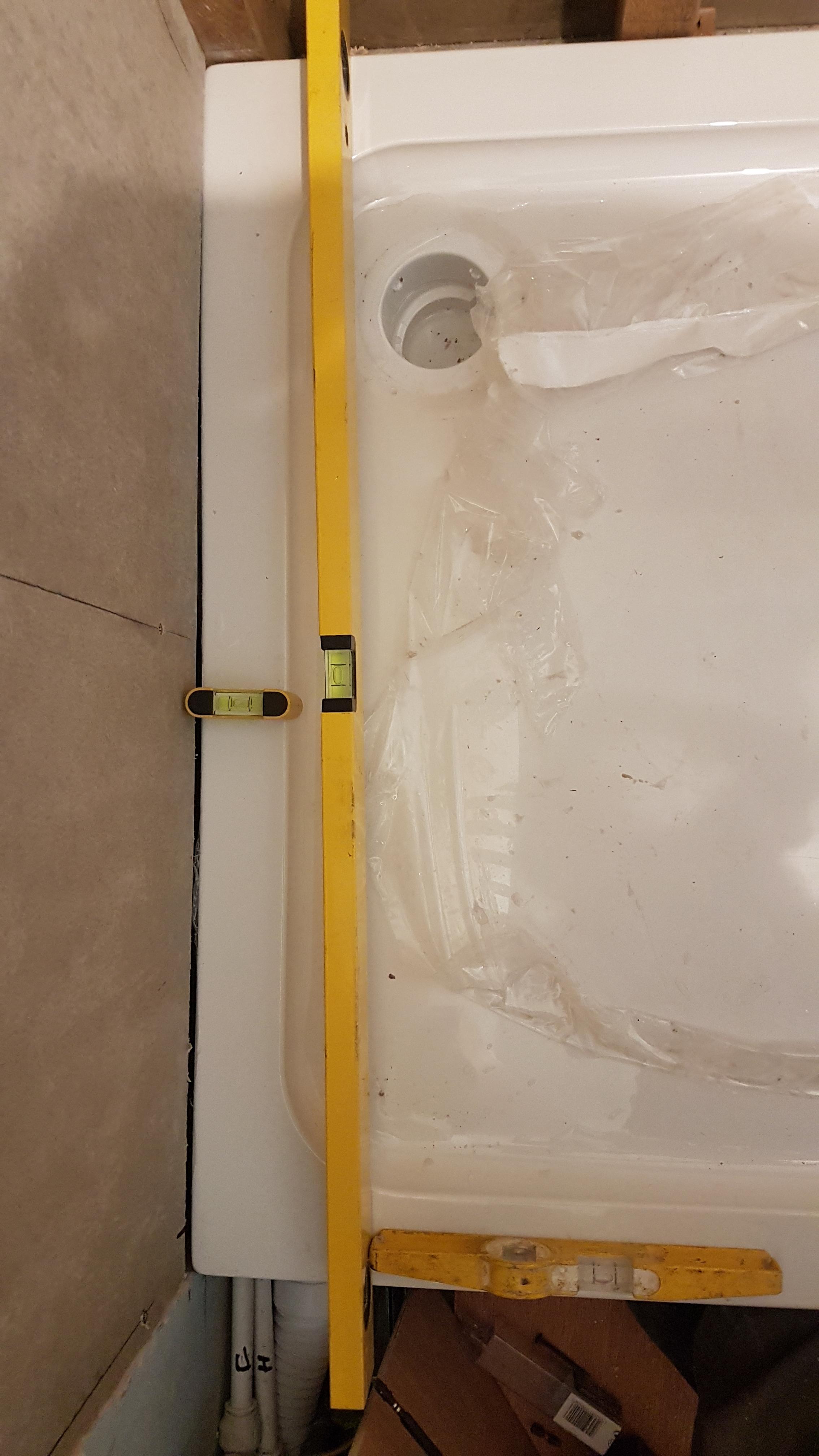

MikeSharp01 Posted August 29, 2021 Share Posted August 29, 2021 I have been struggling to level our daughters shower tray all day and get tge water to flow away. I have it level both ways but the rim at the end foe about 150mm in the middle is sloping the wrong way - as you can see from the picture, the tray side with the short level is level over the whole distance but a bit up at the end which should help the rim issue. The tiler will be tanking it, I guess to the tray and there is 9mm tiles + 1mm adhesive to go on will that be an effective seal against water pooling against it or do we need to get a new tray? Link to comment Share on other sites More sharing options...
Nickfromwales Posted August 29, 2021 Share Posted August 29, 2021 Put some gaffa tape from the wall to the tray and pour a kettle over it. If the water makes its way left and right of the 'defect' then makes its way into the tray I'd say don't panic. If there is a constant pooling of water there and the stagnant water does NOT make its way into the tray then a possible case for a return as unacceptable. Even the most expensive trays have such manufacturing defects, and it's about averages eg where the defect occurs and can you live with it? If it falls as per the small level shows, and then carried on to the left / right and then naturally makes its way to the drain then I'd say you'll be fine. It's all designed to be soaked constantly for 10-15 mins x number of times a day at the end of the day. Tanking and sealing the upstand as I mention in other threads is all the insurance you'll need AFAIC. Link to comment Share on other sites More sharing options...

MikeSharp01 Posted September 1, 2021 Author Share Posted September 1, 2021 I have the tray dead level and most of it works, its just that edge which is wrong. Anyway we are going to ask the tiler to fit this: https://www.showersealsdirect.co.uk/seals/trimlux-pro-23-sealing-trims-23mm-wide-trims.html and go from there. Link to comment Share on other sites More sharing options...

Marvin Posted September 1, 2021 Share Posted September 1, 2021 On the 100+ showers I have fitted I never used a seal like that. I always sealed the tray to the wall with a quality sealant (785), then tiled down to about 2mm off the top of the tray, grouted down to the bottom of the tile leaving the 2mm gap, and then sealed the 2mm gap with no problems. 1 Link to comment Share on other sites More sharing options...
Marvin Posted September 1, 2021 Share Posted September 1, 2021 (edited) Also, the most important area to level is the side with the enclosure is on. Is that a rectangular or quadrant shower going in? Edited September 1, 2021 by Marvin Clarification, hopefully. Link to comment Share on other sites More sharing options...

Nickfromwales Posted September 1, 2021 Share Posted September 1, 2021 1 hour ago, MikeSharp01 said: I have the tray dead level and most of it works, its just that edge which is wrong. Anyway we are going to ask the tiler to fit this: https://www.showersealsdirect.co.uk/seals/trimlux-pro-23-sealing-trims-23mm-wide-trims.html and go from there. Do NOT fit that trim. It will cause you no end of problems, plus you cannot trim it against the shower cubicle. I gave up using those 20 years ago after all the comebacks. ?????? Link to comment Share on other sites More sharing options...

Onoff Posted September 1, 2021 Share Posted September 1, 2021 2 hours ago, MikeSharp01 said: I have the tray dead level and most of it works, its just that edge which is wrong. Anyway we are going to ask the tiler to fit this: https://www.showersealsdirect.co.uk/seals/trimlux-pro-23-sealing-trims-23mm-wide-trims.html and go from there. Got similar fitted to the old ensuite tray. Rearrange the words: like sieve leaks a The fact that to make it work you'd have to load it with CT1 anyway just do away with it and bring the tiles down onto the tray I would. Link to comment Share on other sites More sharing options...
MikeSharp01 Posted September 1, 2021 Author Share Posted September 1, 2021 1 hour ago, Marvin said: I always sealed the tray to the wall with a quality sealant (785), then tiled down to about 2mm off the top of the tray, grouted down to the bottom of the tile leaving the 2mm gap, and then sealed the 2mm gap with no problems. OK will go that way! Link to comment Share on other sites More sharing options...
