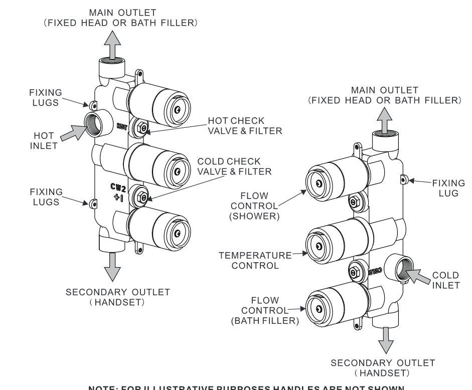

Finally got a concealled shower valve suitable for my elderly Mum. I've never fitted one before and it has G 3/4 are these just standard BSP fittings? Are washers needed at all?
I've attached a pic of the shower valve and also a quick sketch of the pipe layout I need to do. Also is a pic of the removed brickwork in the party wall.

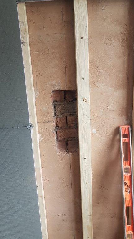

My first question is would it be a neater idea to fix a a ply/OSB panel at the back for the valve to fix to, or just fix the valve straight to the brickword (which I would throw some bonding coat on first to flatten it out).

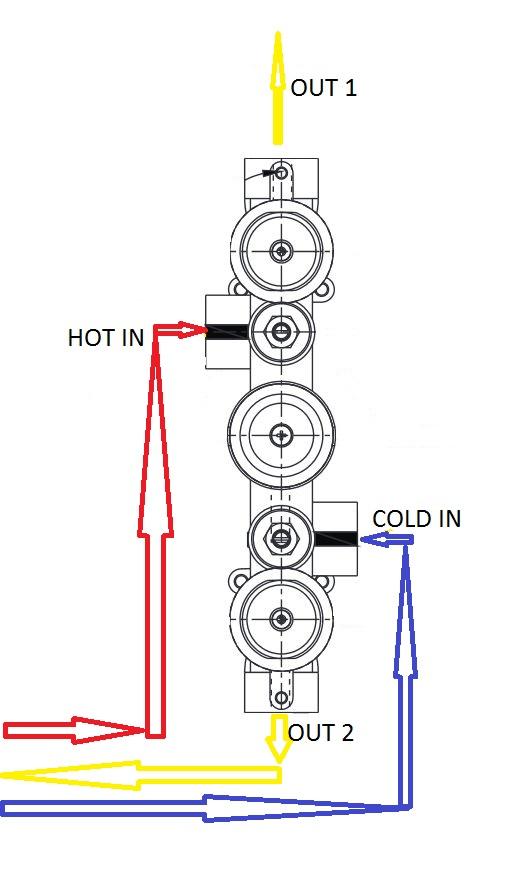

You can see that I need to have elbows/bend to the hot and cold inlet. Would I just use something like this https://www.toolstation.com/made4trade-compression-elbow-male/p33647 with PTFE and/or washers? I'm sure I read on a post where someone used solder fittings (like this https://www.toolstation.com/made4trade-compression-elbow-male/p33647  ) but I can't get my head around how that would work as you'd either need to be able to twist the pipework (or fit it with the valve off the wall?) as I don't think it would be ok to heat the fitting fitted to the valve?  Or are there flexible pipes that can be used?  My worry is just limiting the compression fittings behind the finished wall.
Should the pipework be in 15mm right up to the valve and then just a 22 to 15mm compression reducer in the above fitting?
Should any copper pipework in the stud wall (behind the waterprrof panels and tiles) be insulated to stop any condensation??

Compression fittings, plenty of ptfe tape, pressure test before covering, insulate all pipework.
And above all ensure the shower valve is set the correct distance back to allow for wall covering ant tiles etc.
Sod the compression fittings ..! 3/4x15mm Hep2O with some PTFE Tape/ paste in each connection and do up tight then run 15mm Hep2O pipe up to the valves. Nothing needs to be 22mm
Do you know if they do elbows, have you come across them? I googled and couldn't see any
This is really important but imho difficult because an extra mm here or there on the tile or adhesive will cause you issues .
My advice is if you can access it from the rear make the fittings on a piece of ply or similar so you can move it forwards/backwards a bit ( not to strain the pipe fixings ) . If access from the rear isn’t possible ( not a euphemism ? ) make it so that you can get packers in there behind the screws if you need to move it forward .

What's the advantage of using HEP20 over copper for concealed pipework? Do you still get condensation/have to insulate it?
Hep2o all the way . Fittings allow for rotation and require no skill . Once fitted leave exposed then pressure up and leave for a week ( at least that’s what I did ) then check every few hours for the slightest of weeps

Yeah trying to work that out today and even more difficult to do when the tiles haven't been chosen. I allowed approx 15mm for tile and adhesive but I also took on board what you said about being able to pack it out slightly if needed.
I tried to work this out also . Thought I’d had planned it correctly . But if it’s a bit tight and the shower controls are just 5mm too far back it’s an issue . Just allow for the possibility of moving the entire unit forwards or backwards . Not sure how that works with copper , but with Hep2o there’s enough give in the pipe to allow it .
