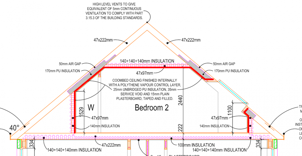

- Our roof makeup is shown in the below architect drawing. 170mm insulation between the trusses. Then vapour barrier stapled to the trusses. On top of this, boards of 25mm insulation secured in place with 35mm service battens nailed at 600mm centres in to the trusses through the 25mm insulation.

- Does the vapour barrier completely encircle the upstairs ceiling as shown on the red line I have drawn on the plan below?
- Does the VB run down the walls beneath the coombs? This would seem to make sense as the eaves are uninsulated, so provides the barrier between heated and unheated space. If so, where and how does this terminate?

You are correct the VB needs to return down the walls
It’s to keep you airtight

If it comes up the slopes and 4-600mm each side onto the flat ceiling cross beams, do you think its necessary to do the whole ceiling when theres 300mm of glass wool there anyway, and so many holes needed for light cables etc? Thats if the ceiling isn't brandered down right enough.

Once at ground level of the first floor, does it just terminate at the joists, or continue somewhere?

Yep
We normally go over the Velux windows
Then slit it and fold it in
Staple it down PB over
the reveal and leave the excess to be cut off prior to skim or tape
Building inspectors like us to leave a flap sticking out of the PB

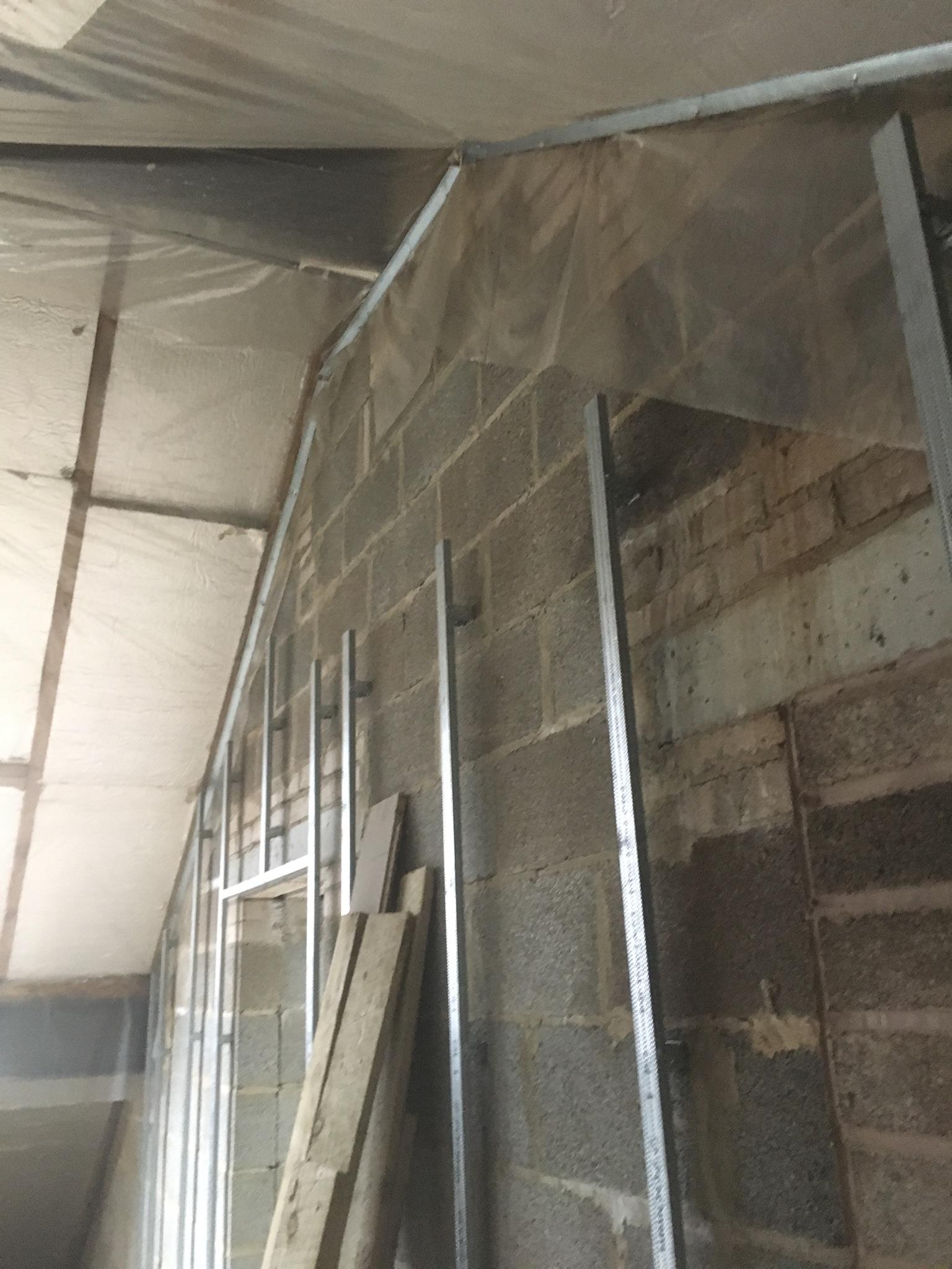

The picture is of 1 of ten top floor  apartments we did two years ago
Brown patches have appeared (sweating)
I drafted an email at the time warning of this
This was common in the 80s as there was little alternative There loads of excellent products on the market
But none as cheap as £20 for a 100m2 roll
of polythene
of polythene

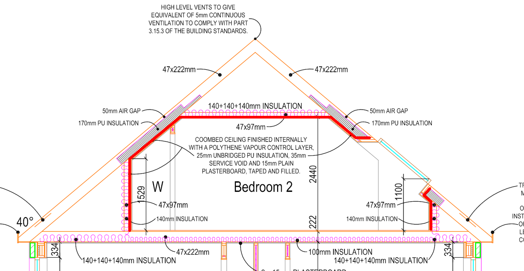

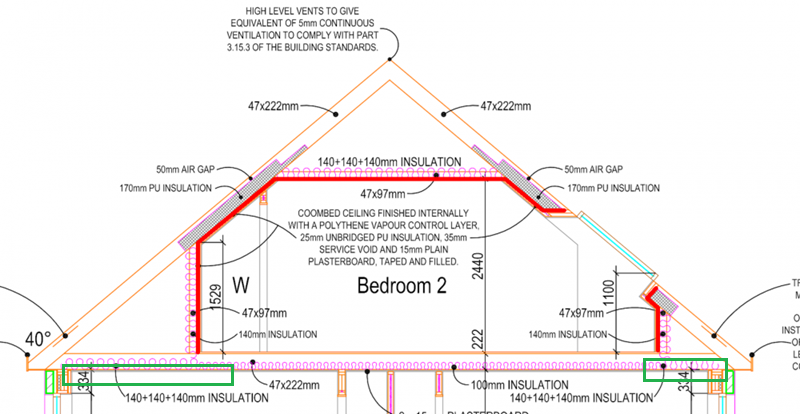

I wonder if there should be a vapour barrier to the floor below the eaves crawl space, where indicated in dark green in the image below.

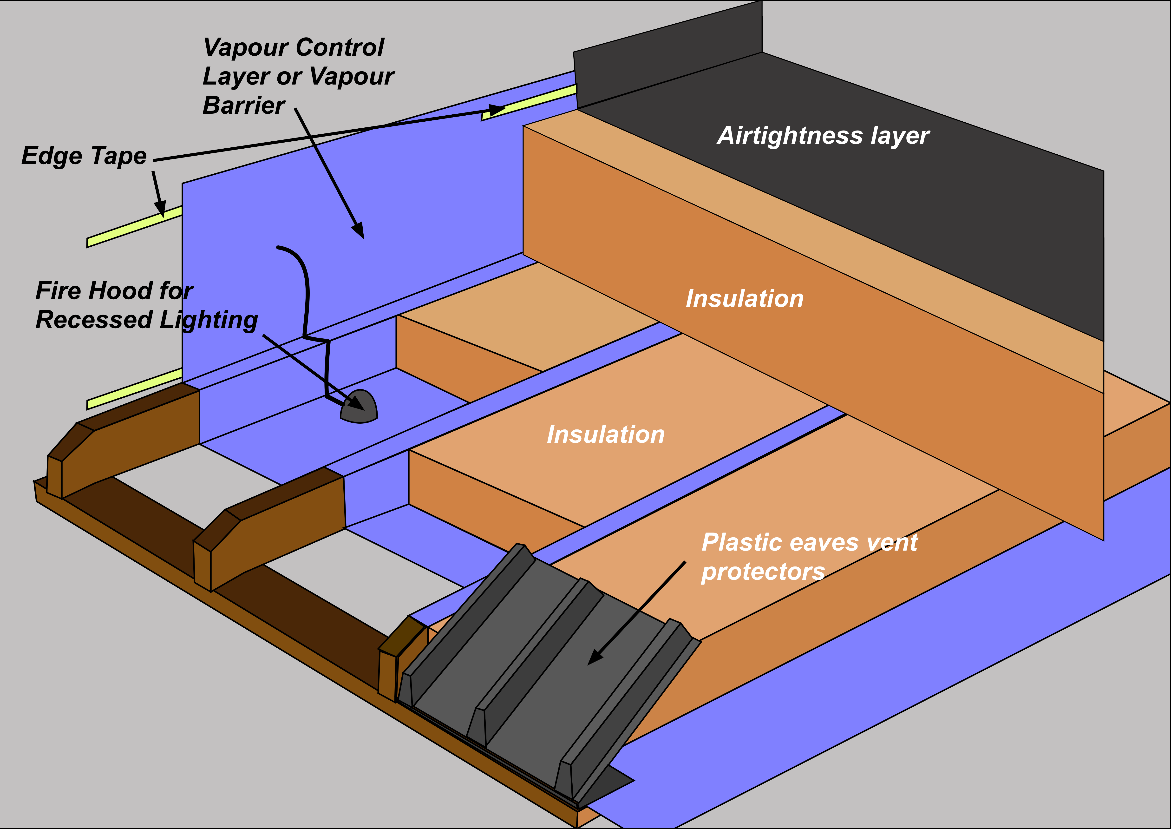

On another website I have seen the suggestion to install the vapour barrier above the beams (in purple in the second image below).
https://www.eco-home-essentials.co.uk/how-to-install-insulation.html
In my case, I will open the ceiling of the floor underneath anyway. So I wonder if I should/could install a vapour barrier below the beams (using a thin board as carrier), i.e. between the underside of the beams (and carrier board) and the plasterboard ceiling of the floor below.
I'd much appreciate any thoughts on this!

First and assuming you are also going reasonably airtight while you are at it.
Decide where your airtight measures will run. Draw a continuous line around the building - that will make you decision.
Go simple where possible. The sketch looks hard work, so go underneath.
It may be better to have the rafter insulation extending full length of the rafters instead of insulating the dwarf walls and part of the ceilings below.  30mm of insulation under the rafters is also good and will help eliminate any condensation / damp potential.
