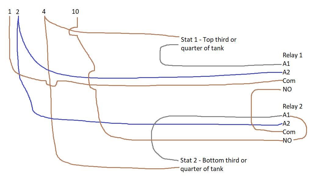

RHayes Posted September 20, 2021 Share Posted September 20, 2021 (edited) Hello Vala You mentioned in your initial post that you had in mind to get a 100l vessell therefore the difference between the two sensors will be approximately 33 litres. This could always be increased by moving the sensors further apart, for example 1/4 and 3/4 of the tank height. I don't have any experiance in the placement of these sensors, however I guess an influencing factor would be what the output of your boiler is rated at compared to the total load of your underfloor heating. Perhaps you can confirm. We are getting in to thermodynamics and comparing load to demand with different flow temperatures between them too, but assuming it is something like a 30kW boiler and a 20kW underfloor heating load then the boiler will probably cycle on for about 3 or 4 minutes and off for about 5 or 6 minutes. This is assuming the underfloor heating is all but on full demand. If it is only a few areas that are heating then it may be a cycle of more like 1 or 2 minutes and off for about 10 minutes. Not sure that this answers your question, however to reiterate the difference between the two options, with 1 stat you'll have just the 1 controller and sensor. With the 2 stats, you'll have the 2 stats or sensors, 2 relays, and a box to house these relays in. You can buy relays for £8-£10 each (you'd need 2) and an enclosure which i guess could be just a double back box and blank plate to house the relays in. The only extra 1st fix wiring for the 2 stat option is a permanent live and neutral (terminal 1 & 2) to the BS location on the latest schematic and then just a case of connecting them up in the right order. Edited September 20, 2021 by RHayes Link to comment Share on other sites More sharing options...
RHayes Posted September 20, 2021 Share Posted September 20, 2021 This is a rather rough sketch i have done in paint of how you would connect the stats and relays in the 2 stat option. Trust you can make head or tail of it. It is important that the stats are placed in the tank between the connections to the boiler and the underfloor heating connections. I beleive it is also important that the flow from the boiler enters the top of the tank and return from the bottom. Likewise the underfloor heating is fed from the top of the tank and returns to the bottom. Link to comment Share on other sites More sharing options...
RHayes Posted September 20, 2021 Share Posted September 20, 2021 @vala I should have @ tagged you to the last to messages and now can't edit them. Let me know your thoughts. Link to comment Share on other sites More sharing options...

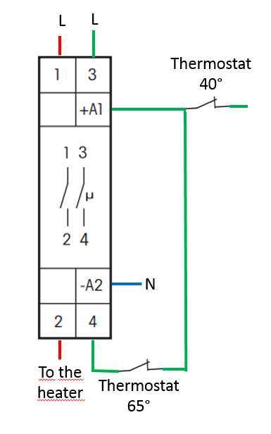

OldSpot Posted September 22, 2021 Share Posted September 22, 2021 (edited) @vala Well I was sent the wrong relay so not been able to set it up yet but a circuit like this would work: Edited September 22, 2021 by OldSpot 1 Link to comment Share on other sites More sharing options...

OldSpot Posted November 4, 2021 Share Posted November 4, 2021 (edited) @vala @RHayes Just coming back to this thread and apologies for the delay as I've been away. I have successfully managed to wire up a DIN relay in the two stats configuration that we previously discussed. I have tested the system using two switches and a light bulb. The switches representing the two tank stats and the bulb represents the "call for heat" from the boiler. If you want to see the circuit working pm me and I'll send you a video clip. The wiring is pretty simple and I'll put a diagram up later if anyone is interested. The relay that I have used is a Heschen ct1-25, they can be found from various online sellers for around £8.50. I'm not promoting this one in particular and there are of course other brands available. I have also bought a small DIN rail enclosure (~£11) to house it in. Hth. Edited November 4, 2021 by OldSpot 1 Link to comment Share on other sites More sharing options...
