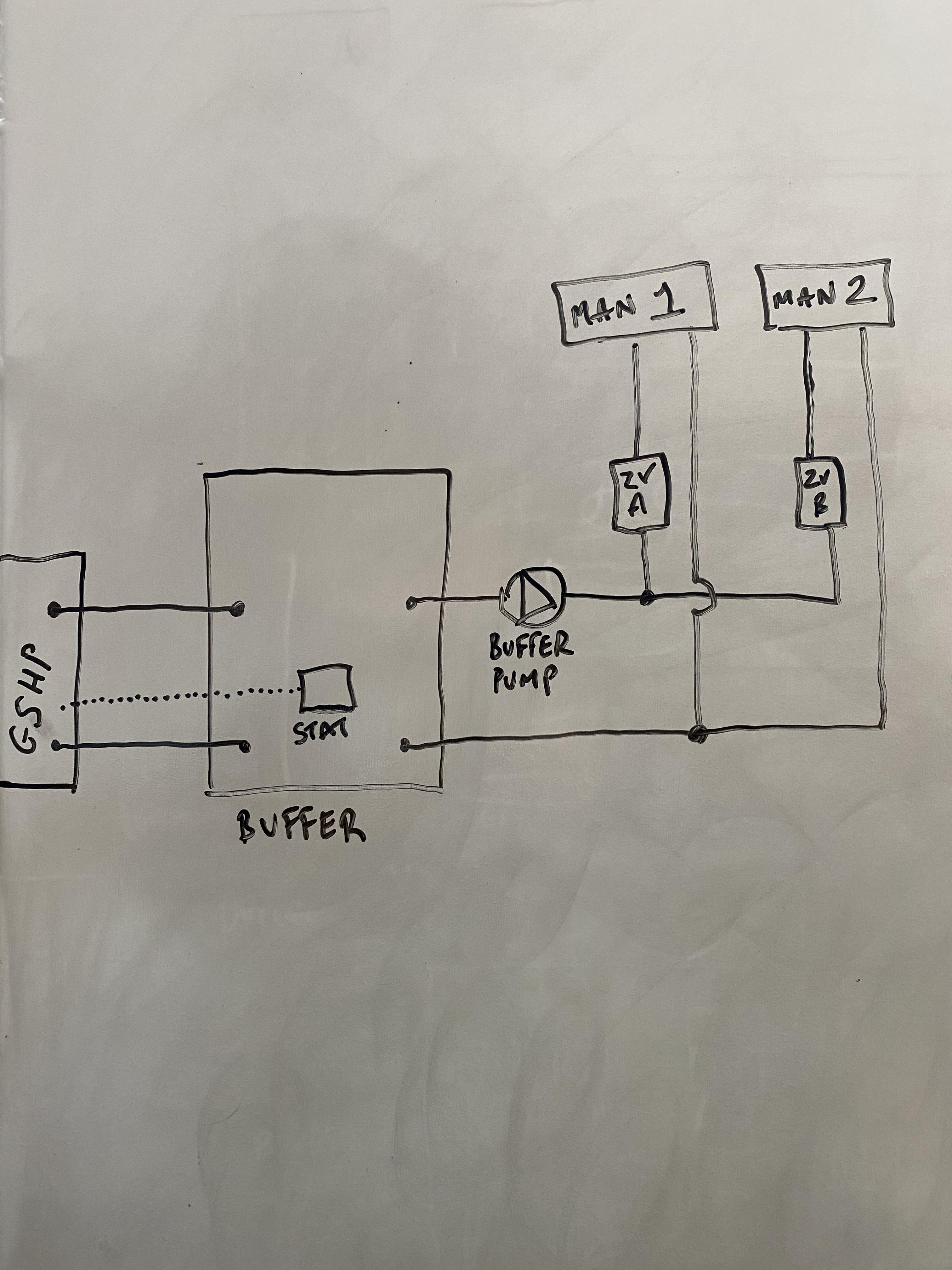

Hi all,
After taking advice from members on this site as well as doing more research into my UFH project I've decided to included a buffer tank. I need a bit of help with the order and components to be used and was hoping I could get that from members of this forum.
The order of plumbing I have is a 22mm flow and return from my external oil fed combi boiler to the buffer tank which will be in the understairs cupboard which I also plan on insulating. This cupboard will also be the location for the ground floor UFH manifold system when we get round to refurbishing the ground floor.
From the buffer tank the 22mm flow would go to the first floor manifold via a heating recirculating pump and 2 port zone valve. I planned on putting the heating recirculating pump just after the buffer tank under the stairs, and the 2 port zone valve would be upstairs by the manifold. Approximate distance from the pump to the manifold looks like it will be 7-8m. I thought this would be best as when the ground floor UFH goes in, I can tee into the feed just after the pump and go to the 2 port zone valve for downstairs UFH.
After the 2 port valve the flow goes into the manifold and then the 22mm return back down from the manifold to the buffer tank.
I was planning on getting a 100L buffer tank from Newark Cylinders however I need to give them more details with regards to number/size/use of connections so the tank can be made up.
Heating circulating pump I was going to go with a Wilo Yonos Pico 25/1-8.
2 port zone valves I haven't found one yet, but a quick google brings up many options.
Does this sound correct with regards to the plumbing and components to be used?

  • Yes.  You don't need a zone valve in this system.  Zone valves are to stop the flow of water to a part of the heating system when the system pump or main circulator is running for another element of t

Got too many components in there.
Just install two decent manifolds complete with blending valves and circulation pumps. Buffer can be a standard 2 port buffer that just is tee’d into the flow and return. Needs a thermostat on the buffer - if Newark are making from scratch then ask them to put pockets at 1/3rd and 2/3rds down the tank and you can sort the call for heat
The manifolds along with the entire UFH system is from Wunda, so the manifold has the blending valves and pumps on. I'm speccing the Wilo pumps.
If there is to be no circulation pump straight after the buffer, and just using the pump on the manifold, would it be wise to have 3 flow and return connections on the buffer tank? This would be the flow and return to the boiler, and then a flow and return to the upstairs manifold and one for the ground floor manifold (once we get round to installing this).
Then a connection fitted for the cylinder stat which will be wired to the boiler?
blender pumps will pull 7m from a buffer. Just have 2 connections and use tees - the boiler pump will circulate as needed. When the manifolds are calling for heat you will get little flow through the buffer.
Just remeasured the approximate distance from buffer tank to the manifold and its more like 8.5-9m, so am I correct then in thinking I can't just rely on the manifold pump?
Am I right in now thinking I can utilise an additional circulating pump after the buffer, or maybe swap out the Wilo that comes with the Wunda manifold for something larger?
The reason I thought about using the circulating pump after the buffer was a response by @Nickfromwales in a thread I read which showed this diagram,
I thought I could substitute the GSHP for my oil fed combi boiler.
However if the alternative of swapping out the pump on the manifold for something that can circulate the flow from the boiler to the manifold I think I'd be more inclined to go that way.
With regards to the flow and return connections on the buffer tank, is there any negative to having the ground floor and first floor separate without having to insert a tee when the time comes?
So I spoke to Wunda and Wilo and they confirmed my query with regards to the distance from the buffer to the manifold pump.
I'll be using the standard Wilo pump as specified on the Wunda manifold.

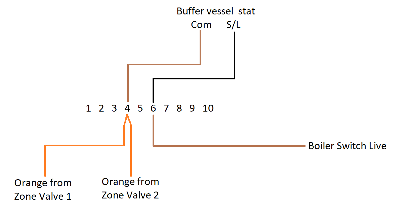

Ok, so terminal 4 on the S plan wiring diagram above is ultimatly the call for heat from your underfloor heating and in the fulness of time I assume you'll have 2 zone valves wired in to this, ground and first floor UFH.
Then from terminal 4, this needs to go do the buffer vessel stat, then from the buffer vessel stat on to the boiler.  This is the basics of it, see below.
Edited by RHayes
I was under the impression when I come to install the ground floor UFH, this would have its on S plan wiring centre along with its own Wunda wiring centre etc???
not wanting to contradict your diagram as its extremely helpful however I came across this page from Wunda whilst looking more at the diagram I previously posted,
it shows the common and 1 (call for heat?) going into numbers 6 and 10.
is this what you've suggested just amended to suit the combi boiler wiring diagram I posted up, as I don't have any timers etc for HW?
4 hours ago, vala said:
I have to confess I did read the drawing incorrectly.  My diagram should have been to terminal 10 instead of 4 to match the S plan diagram.  You will only have 1 S plan wiring centre and the two underfloor heating manifolds would connect in to it.  One as shown above, in terminals 1 and 9, and the other one in to 1 and 5 (in place of the radiator stat).  The hot water part (terminals 6 & 8) is not needed.
An S plan wiring centre is simply a fancy name for a multi terminal junction box as far as I am aware.  The terminalso 1 to 10 are simply means of joining the right wires together and the numbers are to make it easy for anyone to do.  It doesn't matter which number of terminal you use for what. so long as the correct wires are joined so as to follow the switching sequence.
I call it a switching sequence as the flow of 230v power (demand) has to go through the right components and in the righ order.  A convential system would be Power supplied from the consumer unit/spur, to timer, on to thermostat, on to valve, on to boiler and/or pump.  Therefore the switching sequence is time control, temperature control, open the valve, then run the boiler/pump.
As you say you don't have the hot water part of the above diagram and the thermostats are wireless, (although if you have the option to run wires in (I strongly recomend it) and go for a wired thermostat then you won't have to change batteries and won't be depending on the weak RF signal from them.) therefore the power goes to the Wunda wiring centre.  (This then switches its own local pump at the manifold).  You then have the demand live coming from the wiring centre to the zone valve (Brown).  The Grey on the zone valve is permanent live and the orange becomes a switch live to the buffer stat, which is then passed on to the boiler if the buffer is not warm enough.
Hope this helps explain and simplify the 'S plan wiring centre' or 'fancy junction box.
