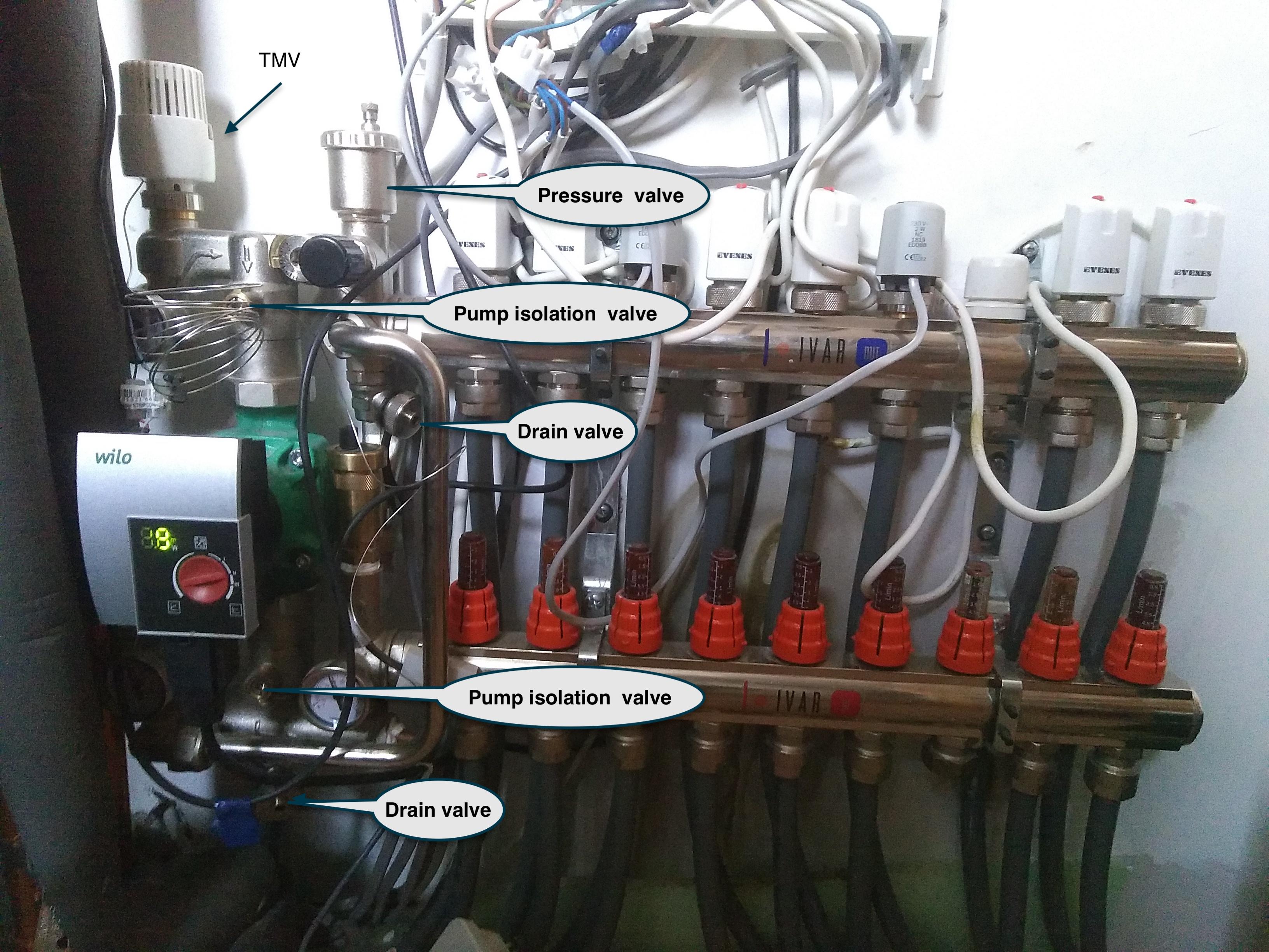

joeirish Posted August 10, 2021 Author Share Posted August 10, 2021 (edited) Thanks for the reply. The manifold is by Ivar (https://www.ivar-group.com/en/UK/products/Manifolds-8524). Attached is a photo. The pressure only drops when the valves are leaking. Otherwise holds steady at about 1.5 bar. The plumber checked the fluid today when he was changing the valve and said there was "industrial amounts of inhibitor" judging by what came out and the smell! Edited August 10, 2021 by joeirish Link to comment Share on other sites More sharing options...
RHayes Posted August 11, 2021 Share Posted August 11, 2021 Hello Joeirish Thanks for the photo. I have come across these manifold valves leaking before but not to that frequency or repetativeness that you seem to be having. Have you concidered upgrating or renewing the manifold? Are there any valves that you have had to replace more than once out of the 8? If not then it may be a batch problem from the original manifold batch. Just a thought. If you'd like to change the manifold would be happy to recomend. Link to comment Share on other sites More sharing options...

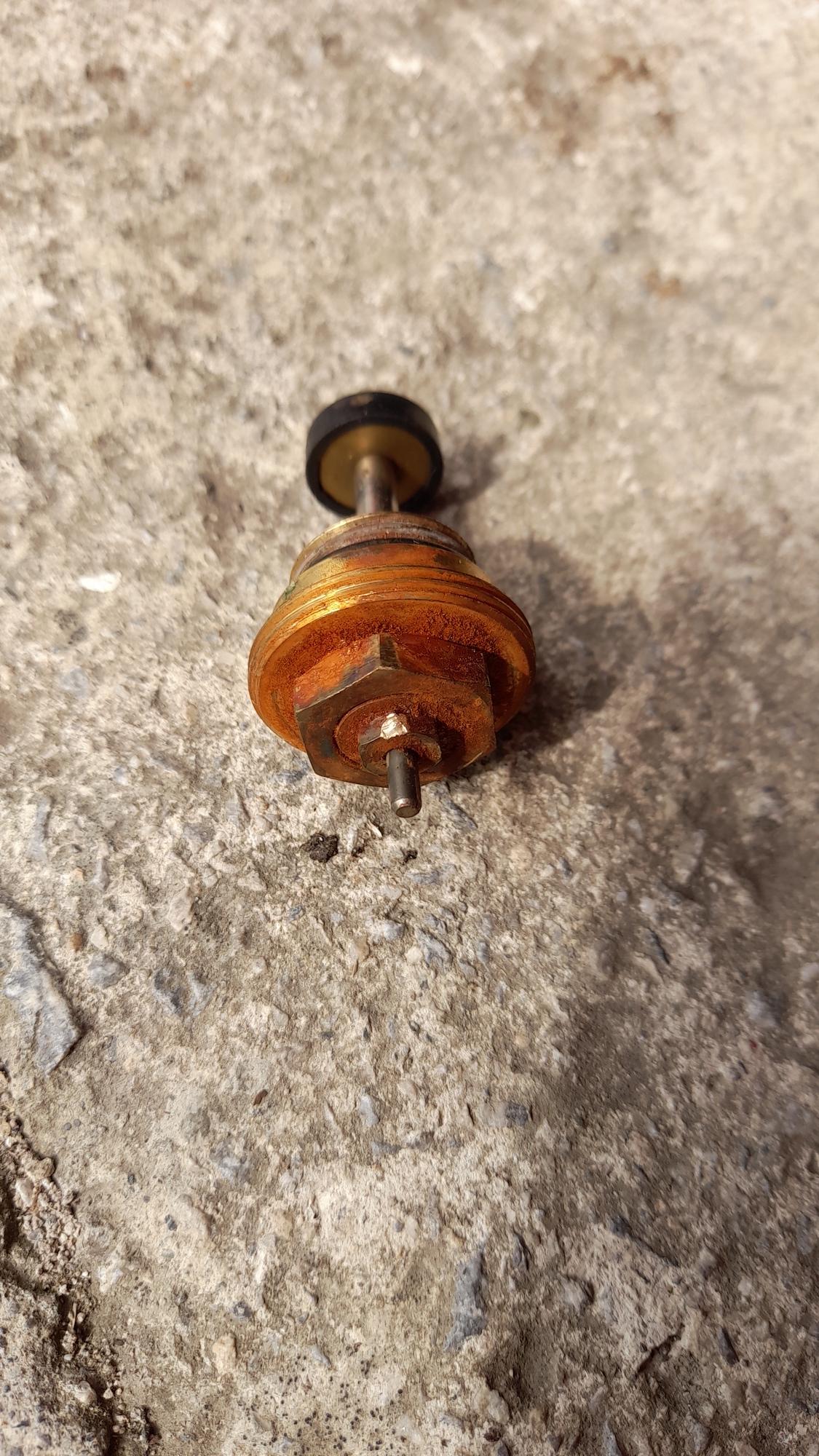

joeirish Posted August 11, 2021 Author Share Posted August 11, 2021 Just taken a photo of the pin valve that my plumber replaced yesterday in case anybody has any thoughts. Link to comment Share on other sites More sharing options...
dpmiller Posted August 11, 2021 Share Posted August 11, 2021 Have you ever had the well water tested for iron? Link to comment Share on other sites More sharing options...
joeirish Posted August 11, 2021 Author Share Posted August 11, 2021 (edited) 6 minutes ago, dpmiller said: Have you ever had the well water tested for iron? Yes that's been done. In fact the testing showed it to be really good water, not too hard and not too soft with no iron or other metals. Tastes wonderful too! My plumber wondered if there was some sort of electrolysis going on. The unf fluid circulates through the boiler which is steel and then trhough copper pipes and then throught stainless steel coil in the thermal store. The ufh pipes I believe are lined with plastic so should not effect things. Edited August 11, 2021 by joeirish Link to comment Share on other sites More sharing options...

PeterW Posted August 12, 2021 Share Posted August 12, 2021 20 hours ago, joeirish said: We had copper pipes going to and from the boiler and stainless steel coil in the thermal store. So he has put some plastic piping in the circuit to see if that will break up the electrolysis, if that is what's causing this residue. plumber doesn’t understand electrolysis. It happens when 2 dissimilar metals are connected by a electrolyte - they don’t need to be touching. On 10/08/2021 at 19:00, joeirish said: The plumber checked the fluid today when he was changing the valve and said there was "industrial amounts of inhibitor" judging by what came out and the smell! Inhibitor doesn’t smell, but sulphates of iron do. I think this is more about the water going into the system to start with and not enough inhibitor rather than too much. On 10/08/2021 at 19:00, joeirish said: Attached is a photo. Who marked that up..? Item marked as a “pressure valve” is an automatic air bleed valve. Link to comment Share on other sites More sharing options...

joeirish Posted August 12, 2021 Author Share Posted August 12, 2021 3 hours ago, PeterW said: Who marked that up..? Item marked as a “pressure valve” is an automatic air bleed valve. Thanks for the reply. I smelled the inhibitor he had with him and it dedeinfeletly had a smell as did the fluid that came out of the system when he was changing the pin valve. I wondered about the iron in the water but we had our well water tested a while ago and the amount of iron in it is quite low (Iron,Total 15 ug/l. PV Value 200 µg/l). However there is high alkalinity so maybe this is an issue? I'm afraid it was myslef who marked up the photo. That was a mistake I now see that the pressure valve should be labelled differently/correctly. Link to comment Share on other sites More sharing options...
