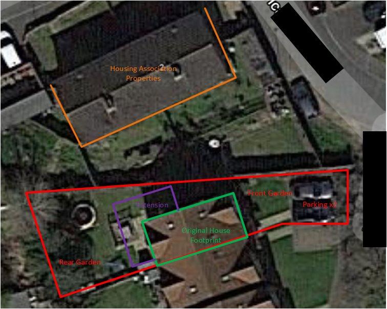

corr_blimey Posted August 9, 2021 Author Share Posted August 9, 2021 1 hour ago, SuperPav said: Presumably both the rear and side extension will be single storey. Any objections from the neighbours from early chats (if any)? Yes single storey. my neighbours in same private drive are all fine, we are all good friends and have fully discussed it. On the side that the side extension will be, there are 4 converted housing association maisonettes that directly rear face into the side of my property (see satellite view below), these I have not spoken to, not the most approachable and they are housing association tenants (not sure how this may impact things). There are no windows now or planned facing towards them, and based on the height of the fence between them and myself, the extension should have minimal impact. Link to comment Share on other sites More sharing options...
corr_blimey Posted August 9, 2021 Author Share Posted August 9, 2021 1 hour ago, SuperPav said: Regarding that little cut out on the 45 degree line, I'd suggest you lose that, and make it square - it should be measured from the centre of their patio/window, not the near edge. This should give you a bit more wiggle room. I thought that, but have looked at the planning docs on our councils planning site and it states 45 degree taken from near edge and also shows it in a diagram. Link to comment Share on other sites More sharing options...
SuperPav Posted August 9, 2021 Share Posted August 9, 2021 I see nothing of particular concern there based on the limited info to go off. The 45 deg thing is surprising though, they normally only take them from the near edge if assessing impact of a two storey extension. This is obviously not a hard and fast rule and does vary between LA's so depends who you're with. My advice would still stand though to keep it square in the initial app. Depending on your LA, they might be allergic to 45 deg cutoffs along window splays anyway I'd advise a few minor tricks in case the planners get funny, but you should be OK to crack on if your neighbours are on board. Remember you always get a freebie re-submission if necessary. 1 Link to comment Share on other sites More sharing options...
