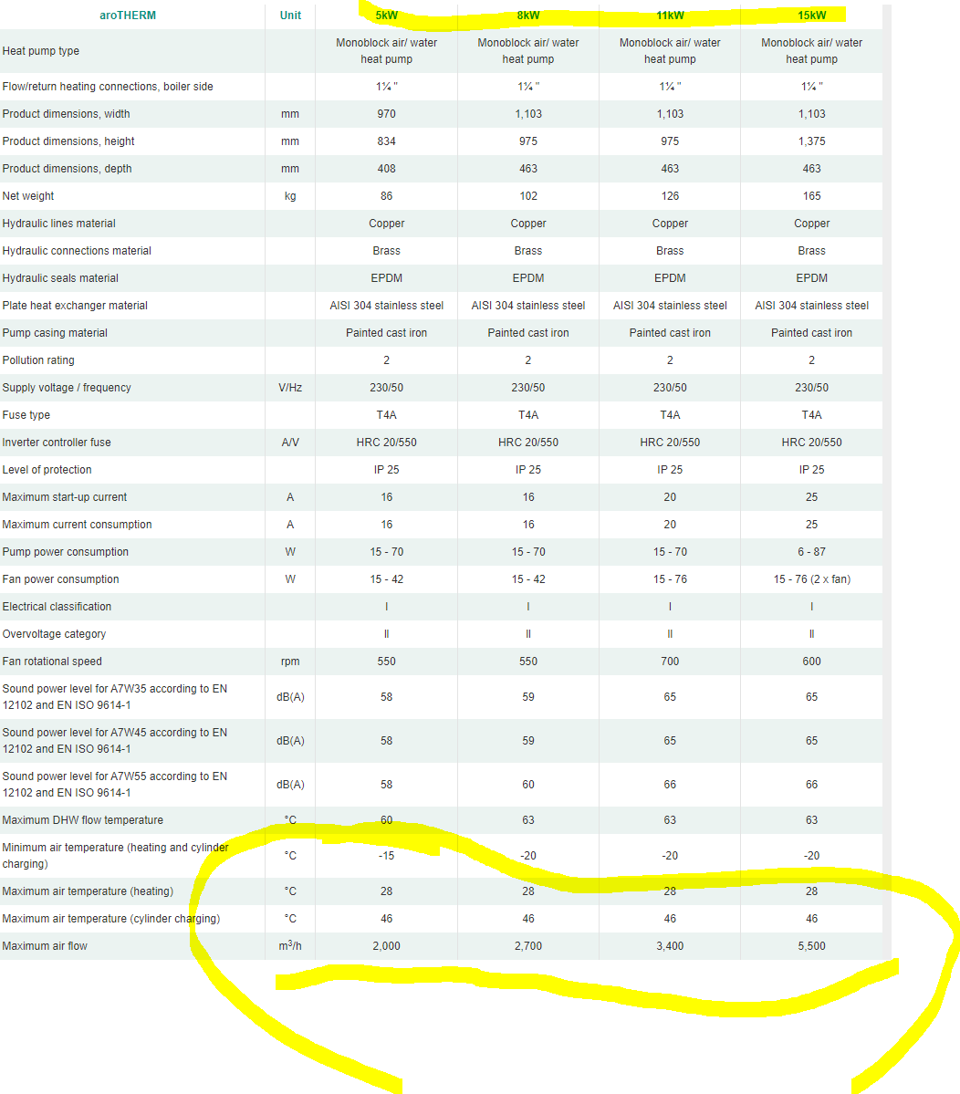

Iceverge Posted January 25, 2022 Posted January 25, 2022 There's just far too much air being moved. Quick sums say a well built house of about 4kw continuous heating load will need about 32 tons or about 40000m3 of air per day for its ASHP (~ 16 Olympic swimming pools if you work in TV units). Normally the air on both sides of a wall you mentioned will be almost exactly the same temperature. It's the direct radiation from the sun makes your skin warmer. Even if there was a very localised warm pocket of air it's lightly to be in the tens of m3 and would be displaced in under a minute and replaced with the ambient environmental air. Defrosting I gather is a function of taking the ambient air below it's dew point rather than the actual temperature of the air alone. This can be avoided by having a correctly sized heat pump, more specifically a correctly sized heat pump evaporator fan unit to ensure enough passes thought that none of it is cooled below the freezing point of water vapour. If you're regularly defrosting your heat pump is overloaded and the battle is largely lost at that stage. There is a trade off to be done with accepting a very small amount of this in the worst conditions VS the cost of upgrading to a larger heat pump. The increased COP in higher ambient temperatures comes from lower fan energy demand due to reduced need for airflow( to avoid vapour freezing) and a greater delta T in the heat exchanger reducing the pumping requirement for coolant. ( one of the reasons inverter pumps are better as they can match the pumping speeds ( air+water) to whats needed only). All this is top of my head schoolboy physics so I'm happy to be corrected if anyone disagrees. TLDR. Heat pump in the sun makes no difference. Avoid defrosting by buying a big enough ASHP.

epsilonGreedy Posted January 25, 2022 Posted January 25, 2022 On 25/01/2022 at 12:53, SteamyTea said: Not possible to do as it depends on the make and model of ASHP, and the duty cycle. But if you have some unique inside numbers, post them up. Expand To a scientist of your calibre it should be entirely possible. Start with the heating demand of the house. Next the heat capacity of air. Heat extracted per m3 of air can then be calculated based on the typical drop in temp as air flows through the ASHP. Add a twiddle factor of efficiency loss in the ASHP. Then you have you have your air volume.

epsilonGreedy Posted January 25, 2022 Posted January 25, 2022 On 25/01/2022 at 12:53, Iceverge said: There's just far too much air being moved. Quick sums say a well built house of about 4kw continuous heating load will need about 32 tons or about 40000m3 of air per day for its ASHP (~ 16 Olympic swimming pools if you work in TV units). Expand Thanks for the hard numbers. My unit of measure is an average sized house. Consider a house with a 10m long southern wall and eaves 5.5m high. An hour's worth of ASHP air volume is 1600 m3 at 4kW demand. On a sunny crisp still winters day a warmer pocket of air might form measuring measuring 10 x 5 x 5 = 250 m3. In contrast on the north wide the property wall and ground will be colder. It is not implausible that the COP will be a few % higher when heat is extracted from slightly warmed up air. Anyhow combating frosting is the principal point of interest.
