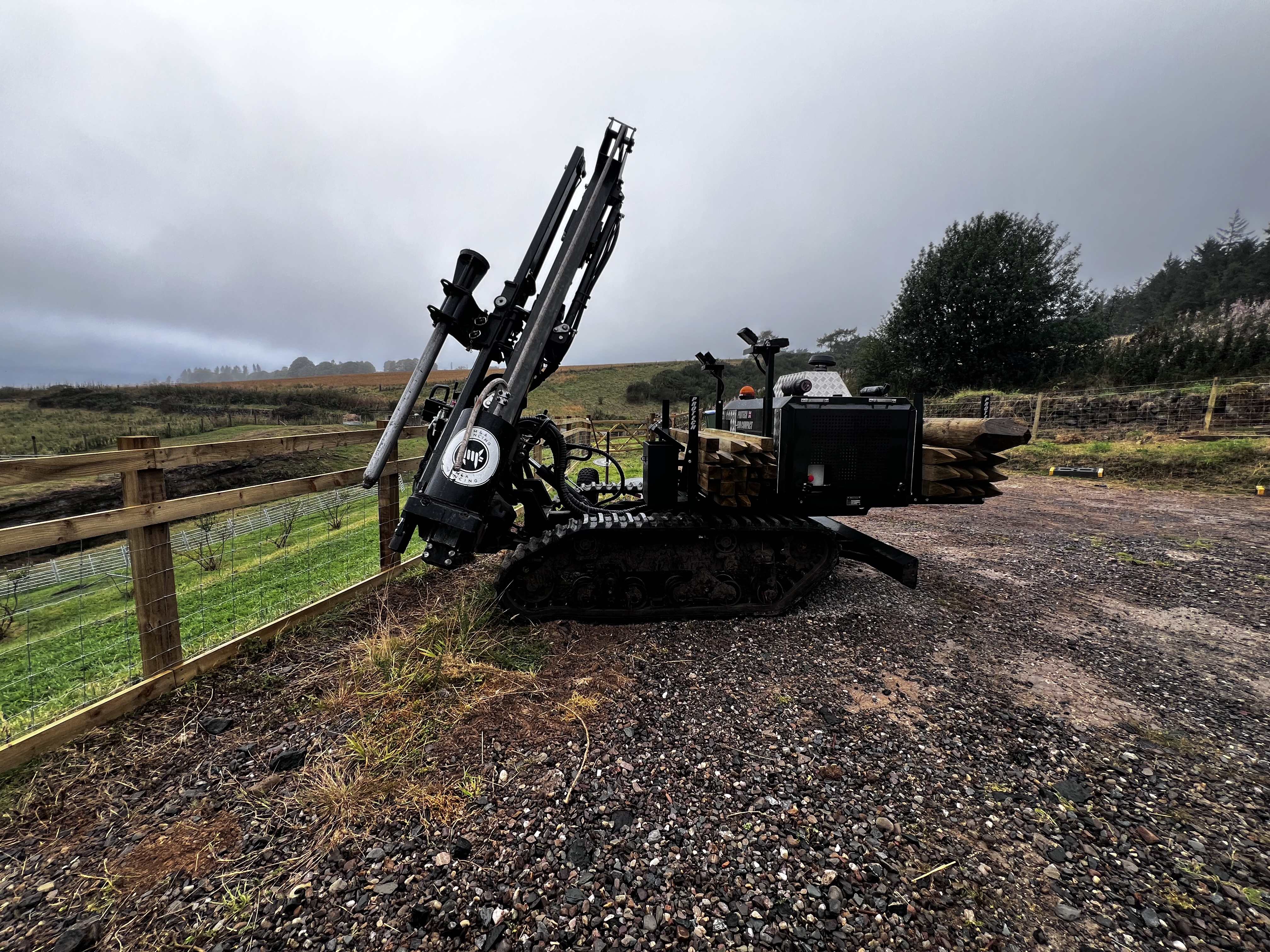

Kelvin Posted August 20 Author Posted August 20 This is my favourite machine we’ve had on-site. Tank post basher. Fence round the house and boundary in. 300m of it! Next task is sell the Heras fencing. 1

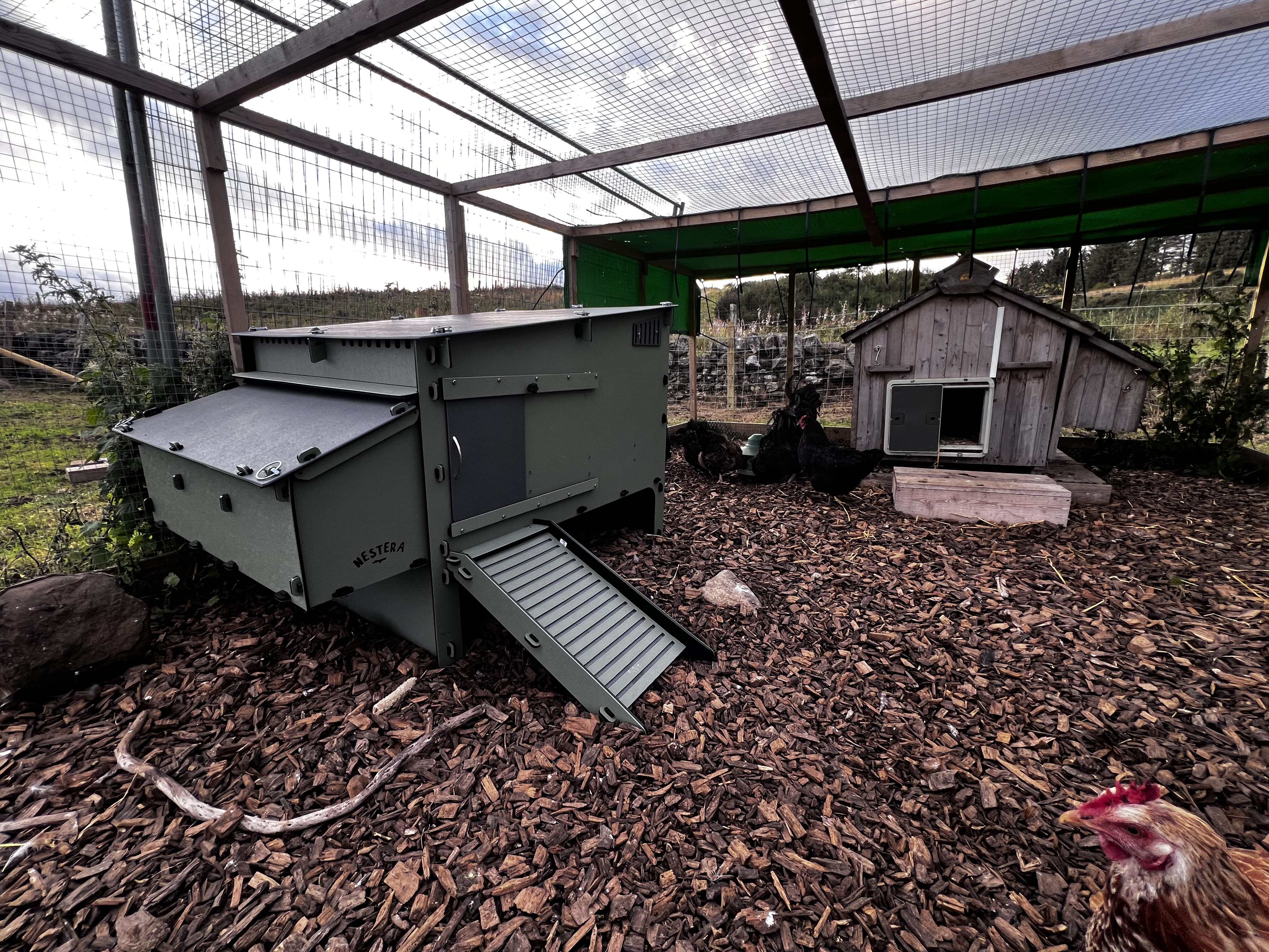

Kelvin Posted August 21 Author Posted August 21 Just assembled my second self-build. Only took 2 hours and no obvious structural problems. Still to fit the automated door. New owners not interested though.
Kelvin Posted August 21 Author Posted August 21 Made from ‘the best quality recycled industrial plastic’ whatever that is. The LBC (large bastard cockerel) has signed it off so it’s all good. 1

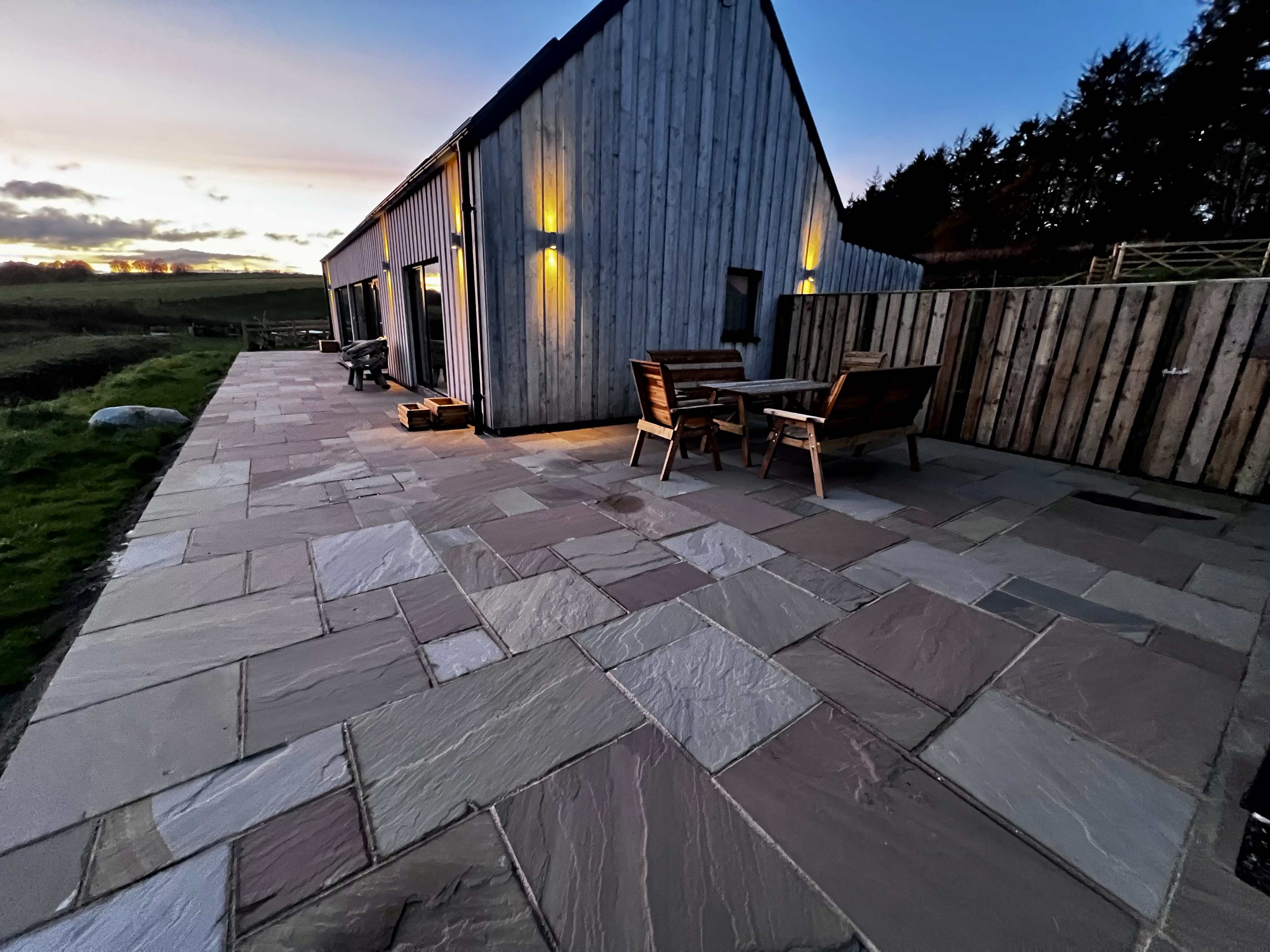

Kelvin Posted November 1 Author Posted November 1 (edited) Hard landscaping almost finished, needs pointing. Bit of fencing to do between the house and garage which I’ll use the leftover larch cladding to match the house. Many tonnes of gravel to put down on the driveway, a few tonnes of topsoil then a load of planting to do along the line of the patio to soften it all. Planted my first two trees. Silver birch and a Willow. Edited November 1 by Kelvin 2
saveasteading Posted November 1 Posted November 1 58 minutes ago, Kelvin said: Many tonnes of gravel to put down on the driveway, What's the existing surface? Rounded gravel or crushed local stone? Membrane is surprisingly cheap in a big roll.
Kelvin Posted November 1 Author Posted November 1 MOT currently that I’ve whacked down so it’s a good surface that drains. 20mm rounded gravel. Can get it locally for a reasonable cost.

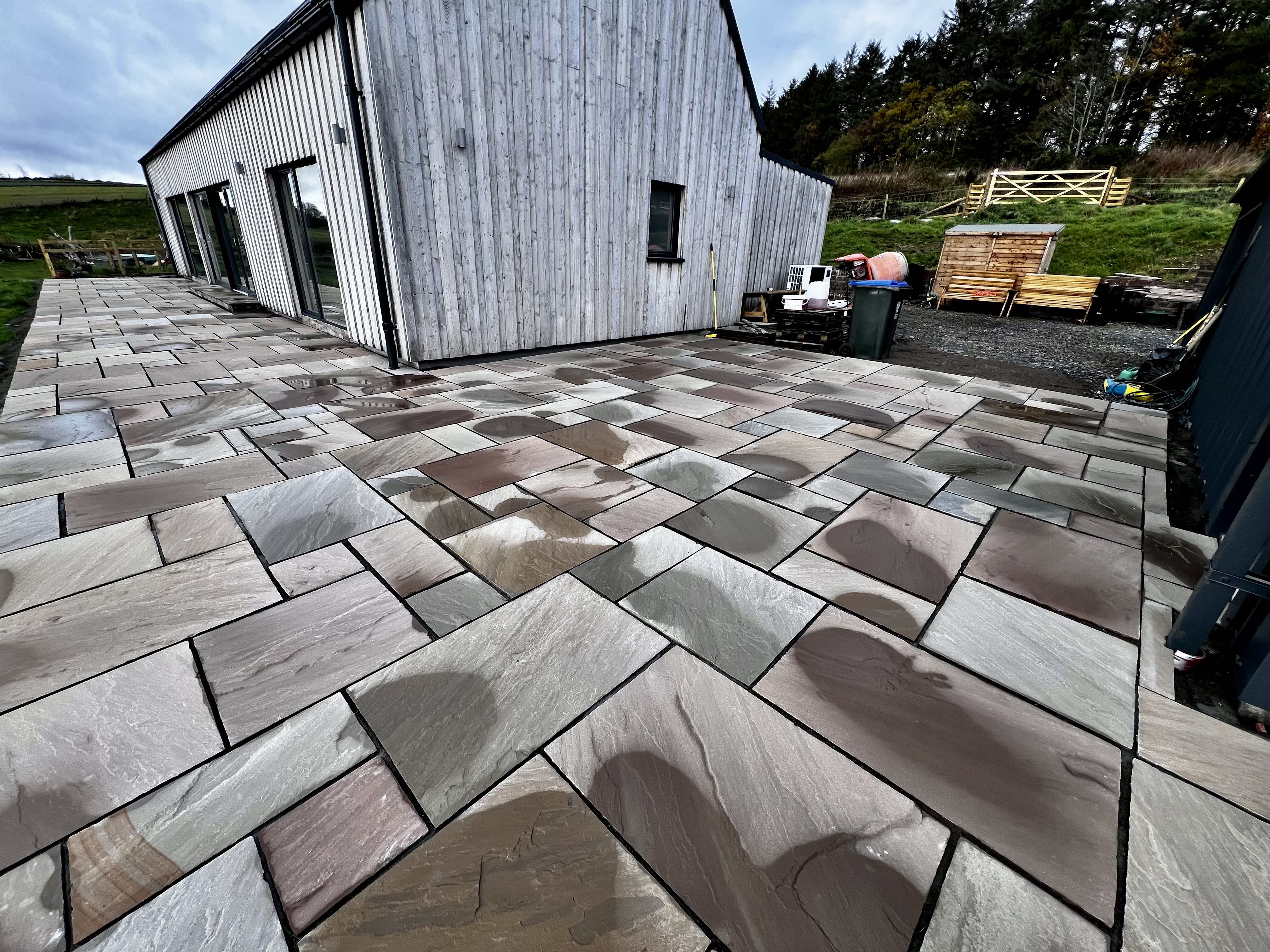

Kelvin Posted November 11 Author Posted November 11 Pointing done and fence using leftover cladding boards. It should end up matching the house. I’ve a stair off the patio and down the slope to build which will wait until I’ve worked out how best to do it. 1
saveasteading Posted November 11 Posted November 11 On 01/11/2025 at 16:04, Kelvin said: 20mm rounded gravel. That will probably rut, and maybe migrate downhill. If and when that happens it might be worth infilling with crushed quarry stone because of the interlock.... it will cost twice as much but maybe just the once.
Kelvin Posted November 11 Author Posted November 11 8 minutes ago, saveasteading said: That will probably rut, and maybe migrate downhill. If and when that happens it might be worth infilling with crushed quarry stone because of the interlock.... it will cost twice as much but maybe just the once. I have a load of it down outside the front door to the retaining wall and I whacked it down. Been down 7 weeks and no sign of rutting. We don’t tend to turn on the driveway bit as we drive in reverse out or vice versa. Where it will rut and move about is the parking area beside the house for visitors and delivery vans. I might end up using that plastic interlocking stuff to hold the gravel in place but that’s a next year problem.

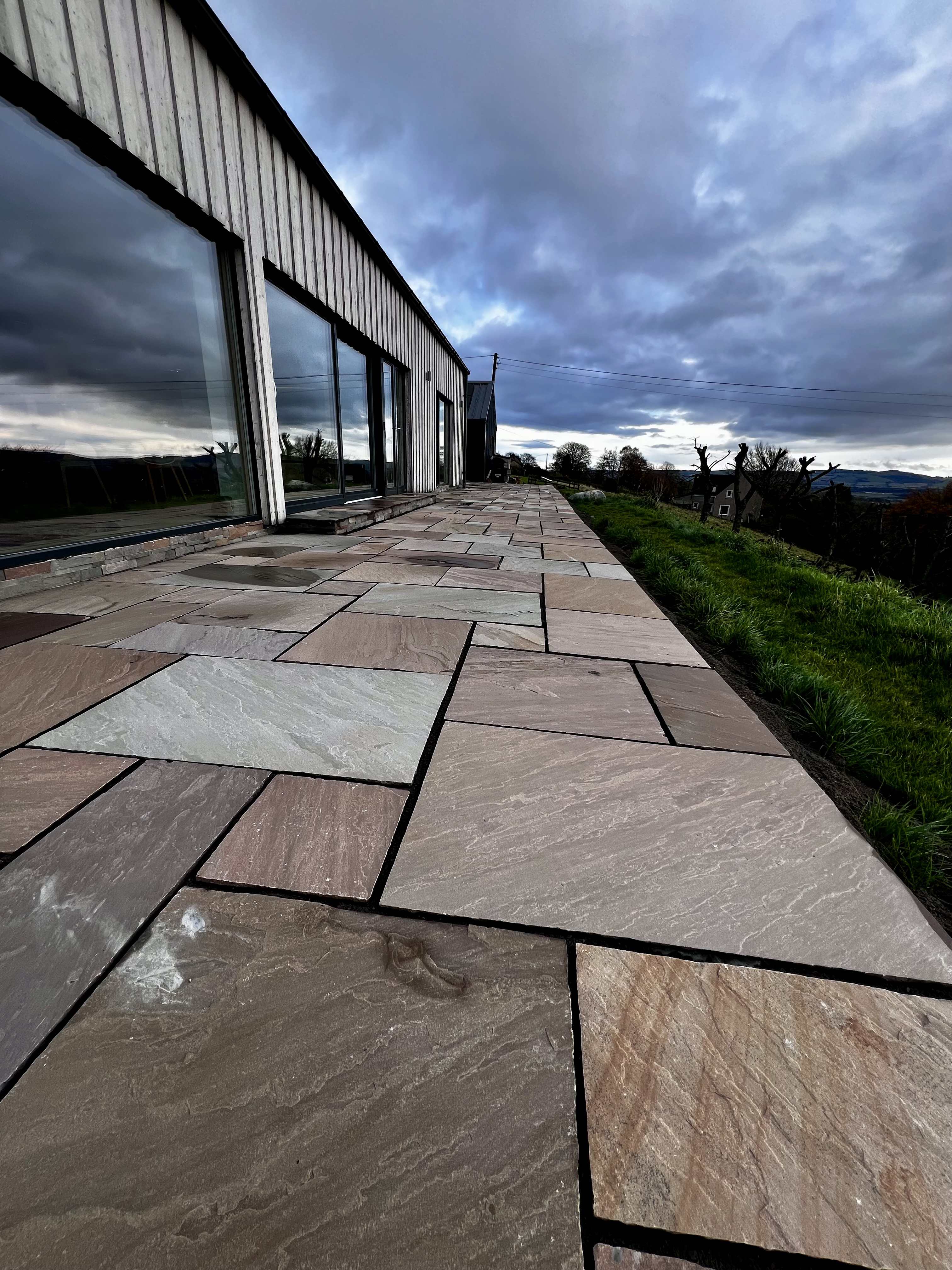

Dunc Posted November 18 Posted November 18 Paving looks great! How did you create the upstand underneath the windows (the ones without the step)?
Kelvin Posted November 18 Author Posted November 18 (edited) I used Raj Green sandstone wall cladding. Comes in sheets and only 11mm thick so quite neat. Matches the slabs perfectly. I had intended to use cut slabs but they are nominally 22mm +- a bit so too thick. Edited November 18 by Kelvin 1
