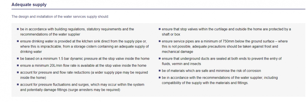

crispy_wafer Posted July 29, 2021 Share Posted July 29, 2021 I've decided to relocate our incoming water pipe to another spot in the build. Didn't particularly like what the builder had done, pipe slightly kinked as it bends up to the floor. so have decided to take the opportunity before I go any further to expose the pipe and re-lay to a better place. I've got good access still through the b+b flooring so no great issues, It's not terminated at the mains connection yet so an easy pull out. I've got access to the pipe, currently it's not ducted under the b+b floor however it has some insulation. If I duct and insulate under the floor, what kind of ducting is acceptable, and what can I use to ensure I get a nice smooth bend on the pipe when it rises up through the floor, I hazard that as I'd still need to insulate within the ducting? If left to my own devices I'd probably use some drainage pipes and a bend, is that an acceptable trick of the trade? I've got a coil of blue ducting for outside the building to the mains stop on the property. This wont accept the pipe and insulation though... Link to comment Share on other sites More sharing options...

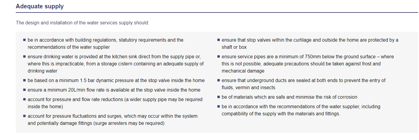

crispy_wafer Posted July 29, 2021 Author Share Posted July 29, 2021 (edited) 15 minutes ago, Gone West said: My ducting was 750mm deep and came up through the floor slab and I didn't use any insulation. In reality I should imagine it depends where in the UK you live as there would be a big difference in ground temperatures between Truro and Inverness. I think at 750 you wont have any problems - below the frost line, mine will be laying in the b+b void at ground level close to external wall. I'm not sure it will freeze down there but NHBC quidelines state adequate precautions when above 750 8.1.3 Water services and supply - NHBC Standards 2021 NHBC Standards 2021 (nhbc-standards.co.uk) Edited July 29, 2021 by crispy_wafer Link to NHBC 1 Link to comment Share on other sites More sharing options...
