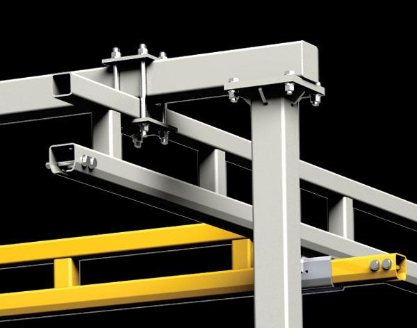

Onoff Posted July 29, 2021 Posted July 29, 2021 3 hours ago, puntloos said: I think if I do this I would probably do well to do a beam-trolley, possibly house the motor somewhere as in my graph, and a snatch block on that trolley... would that make sense? Consider how you stop the beam trolley moving under load if the winch is offset. There are spring brake type things or it can be as simple as someone holding / tying off a rope to one side. The greater the fleet angle etc and you really don't want a load suddenly sliding/swinging sideways! Rather than an I beam you might consider a Met-Track ("Helm") type track from say Metreel up in Nottingham, aka "slotted channel" system. (Great company btw). Generic picture but it's really adaptable. I'd always fit bolted end stops...not even sure if they still do the old sandwich/clamp types... These can be hidden with pb or other ceiling panels butting up to the slot either side. You could even make a feature of the slot and illuminate it. You need to consider access for future maintenance on the trolley and rail fixings.
