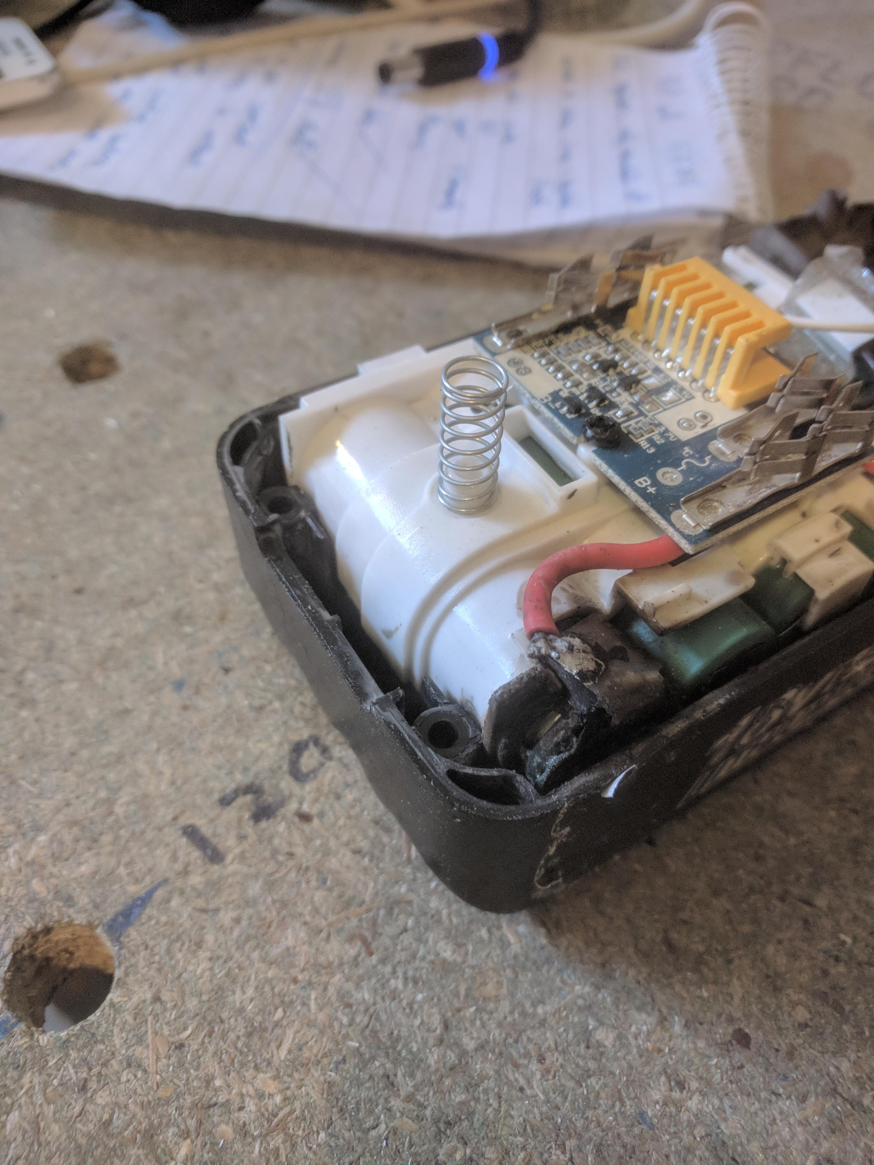

Conor Posted July 23, 2021 Share Posted July 23, 2021 You know those cheap replica batteries on eBay and Amazon? Best to avoid, unless you like your power tools exploding in your hand. Obviously the claimed overload and over heating protection didn't work. The heat probe tape had come free and was no longer in contact with the cells. Happened when I was doing a particularly tough rip with the circular saw. The solder on the other battery melted away on one of the tabs previously. Should have taken that as a warning sign. Link to comment Share on other sites More sharing options...
Onoff Posted July 23, 2021 Share Posted July 23, 2021 What blew, the battery pack rather than the tool? Link to comment Share on other sites More sharing options...
Conor Posted July 23, 2021 Author Share Posted July 23, 2021 7 minutes ago, Onoff said: What blew, the battery pack rather than the tool? Oh, the battery. My circular saw is really, really hard on batteries. The Makita one does just fine, the copy ones literally melt. Link to comment Share on other sites More sharing options...
SteamyTea Posted July 24, 2021 Share Posted July 24, 2021 Is it the actual cells that fail, or the protection circuit? Link to comment Share on other sites More sharing options...
Conor Posted July 24, 2021 Author Share Posted July 24, 2021 Just now, SteamyTea said: Is it the actual cells that fail, or the protection circuit? The protection circuits didn't do the job and the cell at the front of the picture overheated and failed - with loud popping sounds and smoke.. was promptly thrown out on to the gravel until it calmed down. Surprised the whole thing didn't go up. Link to comment Share on other sites More sharing options...
