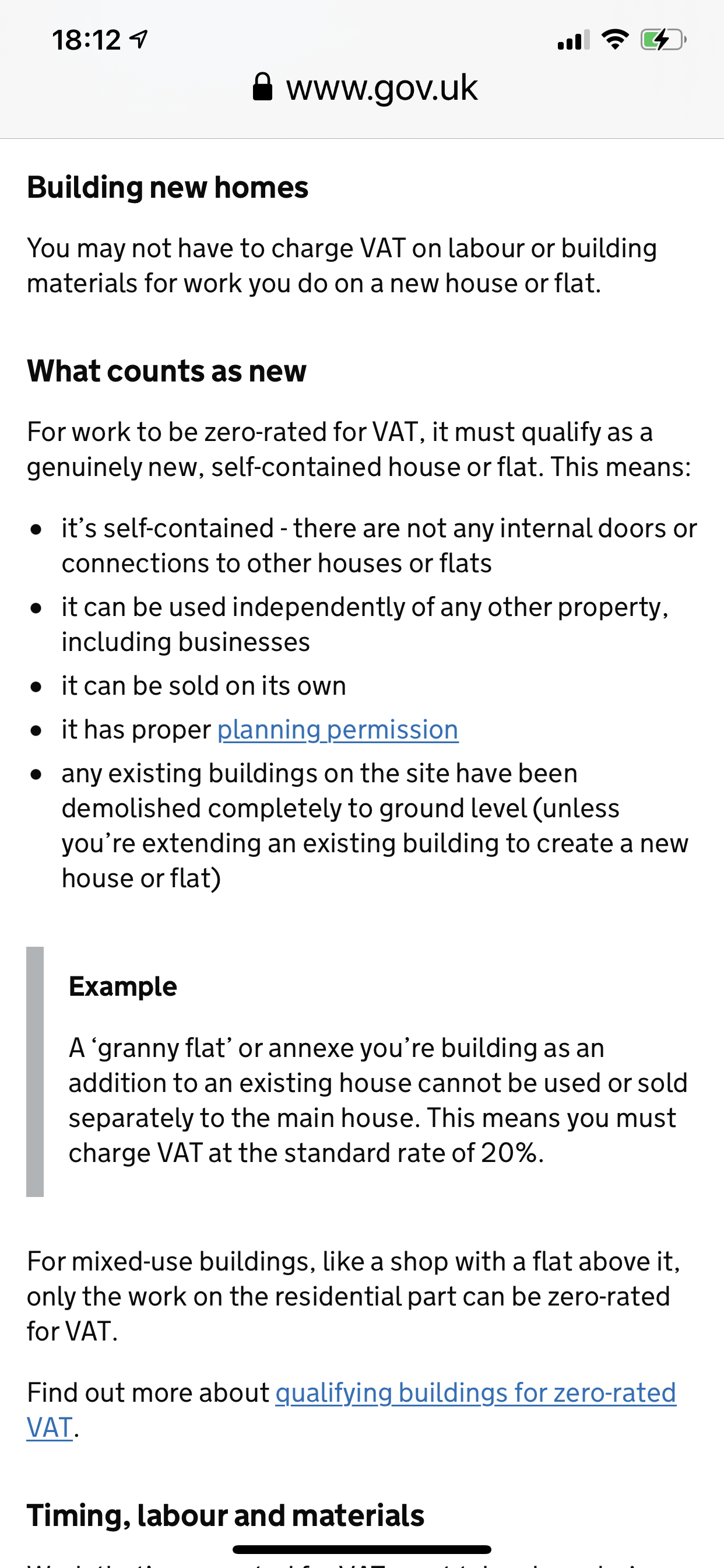

newhome Posted July 18, 2021 Share Posted July 18, 2021 1 hour ago, yebaws said: Not had that about a certificate before? Builderswill just zero rate work on new builds with no questions Yes some will but more are asking for proof of planning or a certificate these days to cover themselves. What you are building is covered here however so it’s clear that your ‘annex’ doesn’t meet the criteria for zero rating as I suspect that you cannot sell the additional building as a separate residence. You will however have to pay council tax on it if the council find out about it. https://www.gov.uk/vat-builders/new-homes 1 Link to comment Share on other sites More sharing options...
Temp Posted July 18, 2021 Share Posted July 18, 2021 +1 If it can't be sold as a separate dwelling it won't qualify for zero rating by a builder There was even a case where someone was granted pp for an annex but there was a condition that said it couldn't be sold seperately. Half way through construction they got the planing condition removed. HMRC said that only materials purchased after the condition was removed could be reclaimed. 1 Link to comment Share on other sites More sharing options...
yebaws Posted July 18, 2021 Author Share Posted July 18, 2021 Just to be clear, it won't be an annex. Separate building, separate access separate services. If I supply it with a new supply and meter, I can't see why it won't qualify for zero rating based on what I've read. Yes, I suppose council taxable.... Link to comment Share on other sites More sharing options...
newhome Posted July 18, 2021 Share Posted July 18, 2021 2 hours ago, yebaws said: Just to be clear, it won't be an annex. Separate building, separate access separate services. If I supply it with a new supply and meter, I can't see why it won't qualify for zero rating based on what I've read. Yes, I suppose council taxable.... If it can't be sold separately from the main dwelling then it doesn't qualify for zero rating as per the very clear info from HMRC. You may well get away with it dependent on the builder you choose but should HMRC investigate then they will be at fault for having zero rated the work. Link to comment Share on other sites More sharing options...

Temp Posted July 19, 2021 Share Posted July 19, 2021 (edited) 3 hours ago, yebaws said: but my interpretation is that what I plan is zero rateable according to guidance and nobody would be at fault. 3 hours ago, yebaws said: No, it doesn't have planning, but that would never refer to it as an annex or extension as it won't be! I stand by earlier opinion that it must have planning permission to be a separate dwelling to qualify for zero rating for VAT. If it doesnt get planning for that then effectively it is an out building, detached annex or granny flat, call it whatever you want but it won't be zero rated for VAT. @newhome quoted the rules from the government website. If you think you have seen something that states otherwise please post a link. I believe your best bet is to apply for planning permission for a "New Dwelling". On the site plan I would show the separate road access and show a plot boundary (eg where you would put a fence if it was going to be sold off seperately). You would not actually have to sell it off or even errect a fence. That merely establishes the site boundary for planning purposes. I would not show a "workshop" on the plans either, call it a double garage or games room or something else that new dwellings normally have. You can decide to use the double garage/games room as a workshop later without needing new planning permission (unless its for business use). It's irrelevant to the planners how you do the services but they will matter to Building Control later. If planning is granted for the above then, because you could sell it off as a separate dwelling, it would qualify for zero rating for VAT and almost certainly add the most value. However it you would not qualify for the self builder exemption from the CIL unless your family member lives in it for three years as their primary residence. Edited July 19, 2021 by Temp 1 Link to comment Share on other sites More sharing options...

Dan F Posted July 19, 2021 Share Posted July 19, 2021 Agree with @Temp It's all up on the government website if you take a look. The definition of "designed as a dwelling" includes the requirement for planning. See: https://www.gov.uk/guidance/buildings-and-construction-vat-notice-708#section3 This same page also says the following, which suggests a seperate electircal supply isn't a must. Quote An annexe is capable of functioning independently when the activities in the annexe can be carried on without reliance on the existing building. You can ignore the existence of building services (electricity and water supplies) that are shared with the existing building. 1 Link to comment Share on other sites More sharing options...
