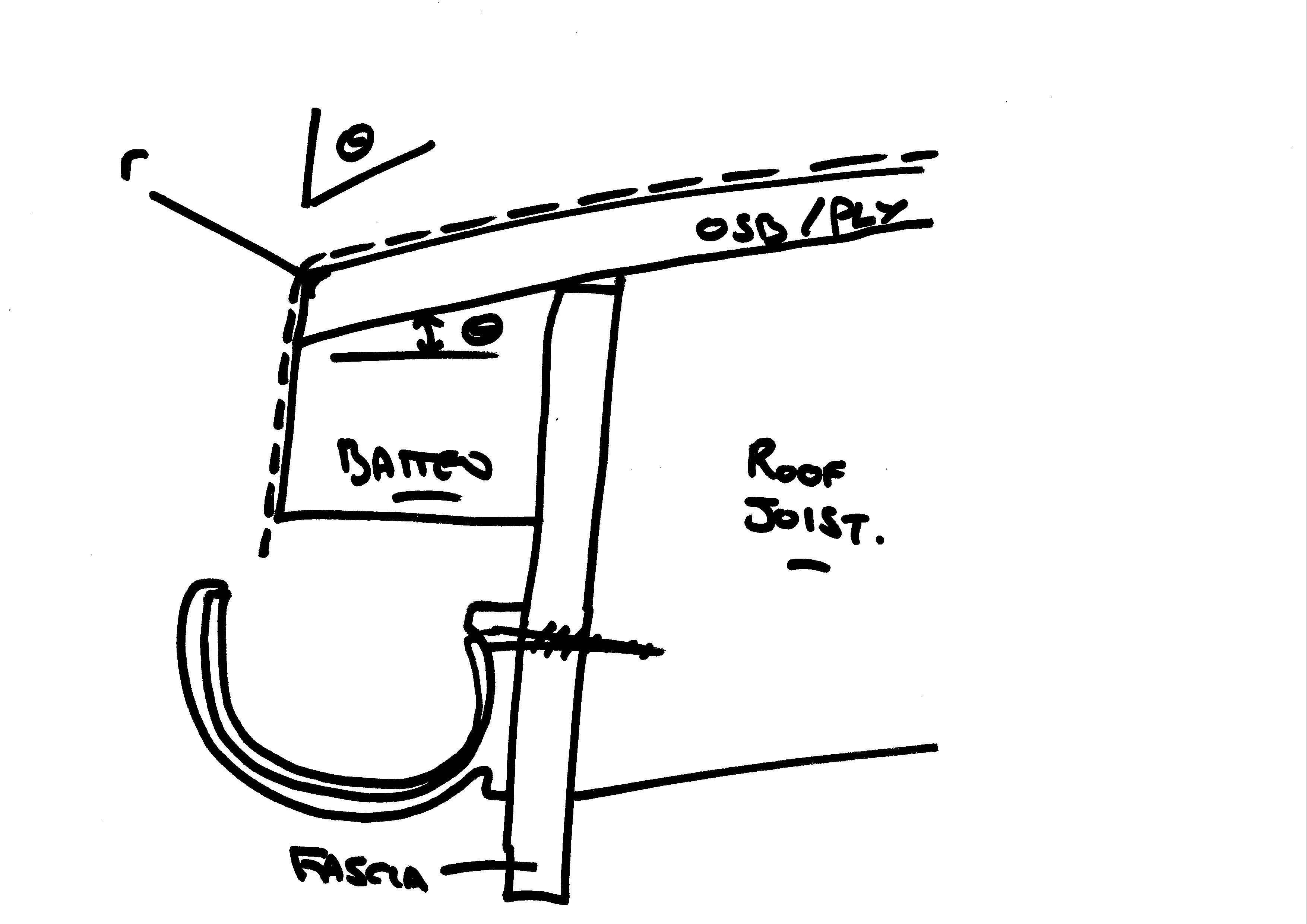

Omnibuswoman Posted July 20, 2021 Author Share Posted July 20, 2021 New question: On the south side of the building (the direction towards which the pent roof slopes down), we need to put a baton along the edge of the roof so that there is a small overhang to allow water to run off into the gutter. (see attached picture) Do we fit the baton on top of the fascia at that side, or cut the fascia shallower to butt up against the underside of the baton? IMG_9338.pdf Link to comment Share on other sites More sharing options...
Onoff Posted July 20, 2021 Share Posted July 20, 2021 43 minutes ago, Omnibuswoman said: New question: On the south side of the building (the direction towards which the pent roof slopes down), we need to put a baton along the edge of the roof so that there is a small overhang to allow water to run off into the gutter. (see attached picture) Do we fit the baton on top of the fascia at that side, or cut the fascia shallower to butt up against the underside of the baton? IMG_9338.pdf 14.62 MB · 4 downloads I'd do this ideally, albeit with the guttering further forward to limit overshoot (couldn't be ar5ed redrawing ?). The fascia wants to help support the roof edge and the batten will further stiffen it: Link to comment Share on other sites More sharing options...
