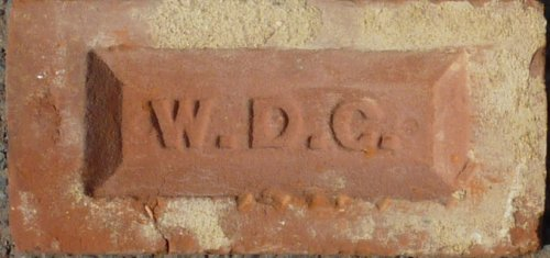

Brickstressed Posted July 11, 2021 Share Posted July 11, 2021 Trying to identify / source these bricks, stamped W*D*C in frog, size is W 8 3/4 D x 4 H x 2 1/2 inches Any ideas welcome Link to comment Share on other sites More sharing options...

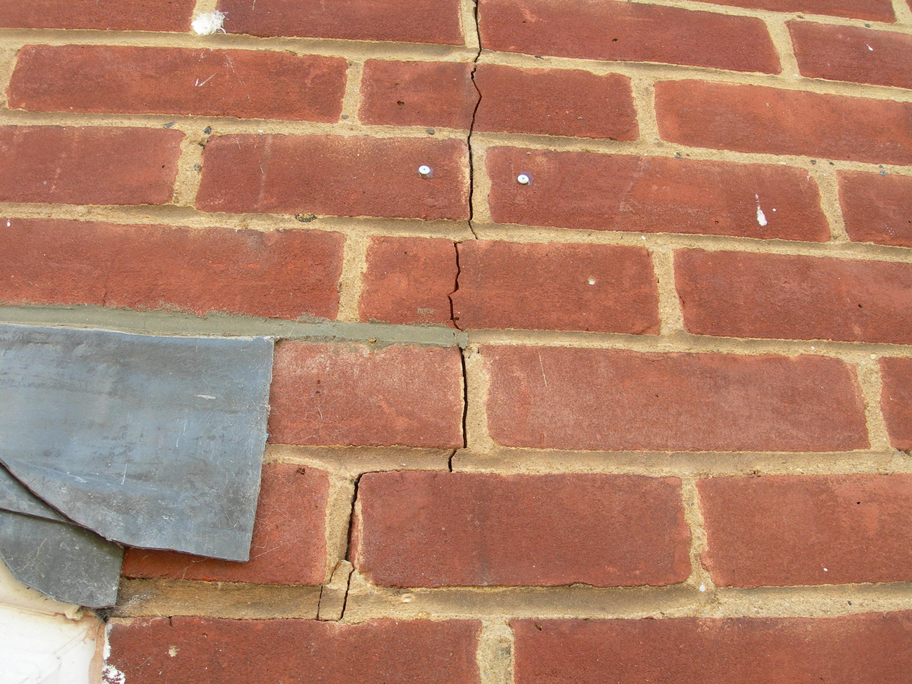

Mr Punter Posted July 11, 2021 Share Posted July 11, 2021 Perhaps visit your local builders merchant. Did you work out the cause of the crack? Link to comment Share on other sites More sharing options...

Brickstressed Posted July 29, 2021 Author Share Posted July 29, 2021 On 11/07/2021 at 18:34, Mr Punter said: Perhaps visit your local builders merchant. Did you work out the cause of the crack? I tried brick matching services, useless. Structural engineer said the cracking was from the gorilla who had poorly installed the bay window, It was too large for the opening, but still hammered into the opening. Link to comment Share on other sites More sharing options...

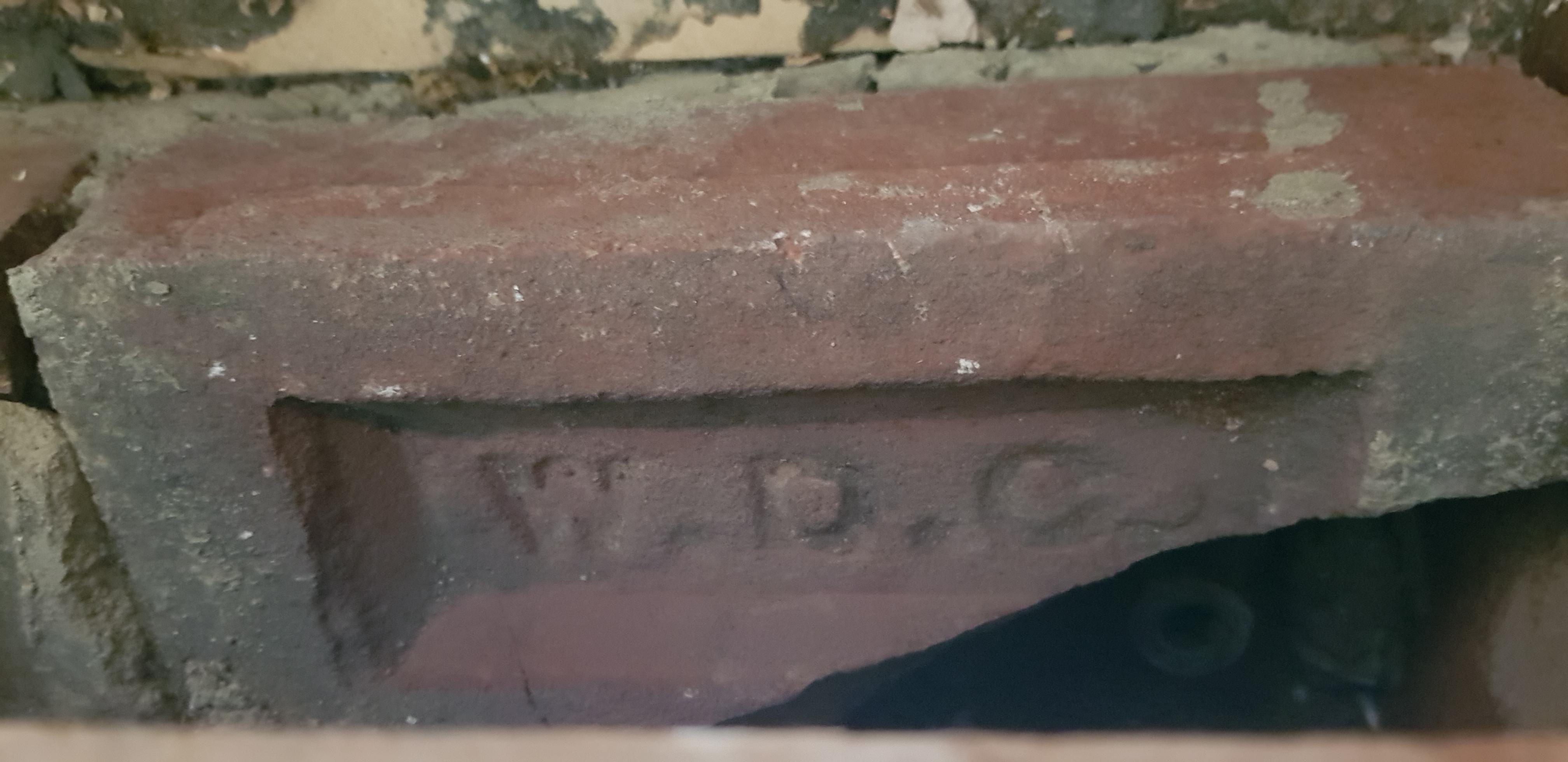

Brickstressed Posted July 29, 2021 Author Share Posted July 29, 2021 The only place that I have a view of the bricks is from under the floorboards on a internal wall. Link to comment Share on other sites More sharing options...

Temp Posted August 3, 2021 Share Posted August 3, 2021 Google found ... https://www.brocross.com/Bricks/Penmorfa/Pages/initials.htm W D C : W D Cornish https://www.brocross.com/Bricks/Penmorfa/Pages/england5b.htm "W. D. Cornish, Enfield. Middx. started around 1990's along with several other brickworks in the area. His Bush Hill Park works flourished until the price of land increased & his works was the last to close in the Enfield area in 1936. Info by Martyn Fretwell and photographed in a Kent reclamation yard." 2 Link to comment Share on other sites More sharing options...
Temp Posted August 3, 2021 Share Posted August 3, 2021 See if he can remember which yard in Kent it was.. https://uknamedbricks.blogspot.com/p/blog-page.html you can email me - Martyn Fretwell at daysnbricks4uATbtinternetDOTcom Replacing AT with @ & DOT with . Leaving no spaces as per jpeg image - which you cannot copy & paste from. 1 Link to comment Share on other sites More sharing options...
