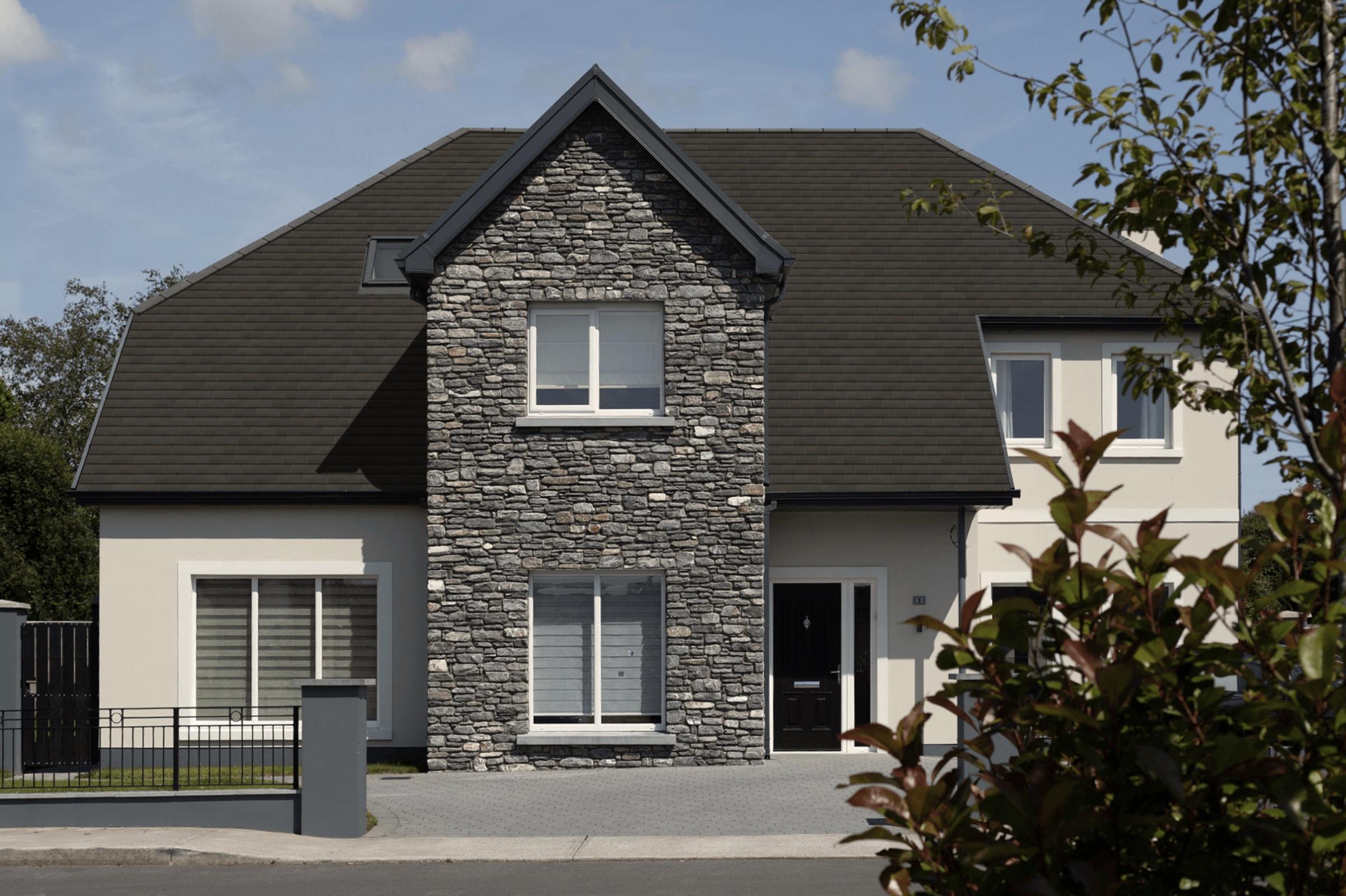

My roof is done with Edgemere Riven finish.  It's a slightly thinner version of the standard Edgemere tile and with a riven finish to make it look just a little bit like slate.  It was the only concrete tile that the planners would accept here having tried to get me to use slate.
