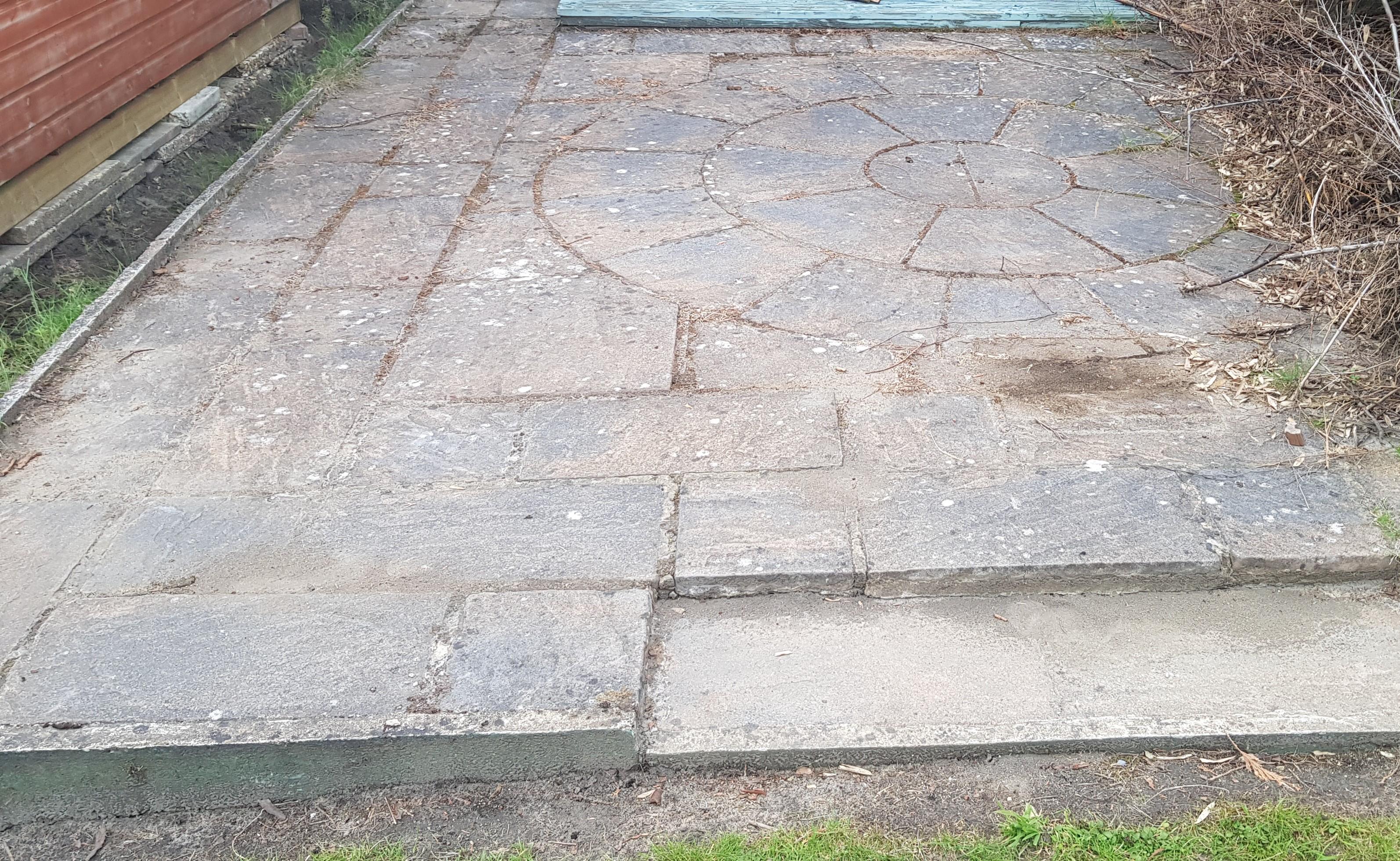

oldkettle Posted July 10, 2021 Posted July 10, 2021 I have recently picked up a sectional garage on freecycle. We have some kind of a patio in the middle of the garden and I am considering putting this garage there to serve as a storage/workshop as the existing garage will have to be demolished soon. The area is reasonably flat but is not level so I am looking for the easiest way to make it a suitable base. I am not sure we will want this building there permanently - it is in a nice sunny location and I'd rather move it eventually, so don't want to create future problems. It's not quite clear to me whether the existing base is just paving on a thin subbase or there is some concrete there - see the picture, the grass it definitely growing through the sealing. It has been stable over 6+ years we've been here. The two options I was considering were screed over the top (but how much of it?) or lifting the stones and putting in a thin (75mm? 100mm?) slab, the latter sounds more difficult to get rid of in the future though. I guess alternatively we could just use a single layer of paving bricks or concrete for the perimeter only to level things and leave the middle as is? Ah, and of course it's on a slope to make life easier Any advice is greatly appreciated.
Russell griffiths Posted July 10, 2021 Posted July 10, 2021 Have you been to collect this garage .? do you have the ability to move it ? there is a reason that they are free. ,!!
oldkettle Posted July 10, 2021 Author Posted July 10, 2021 7 minutes ago, Russell griffiths said: Have you been to collect this garage .? do you have the ability to move it ? there is a reason that they are free. ,!! I have and this garage has been in my garage for a month ? The panels are movable - some I can shift alone, some need a mate.
Russell griffiths Posted July 10, 2021 Posted July 10, 2021 Then chuck it up on that paving, c’mon stop dawdling. Picture tomorrow night of it finished. ??
oldkettle Posted July 10, 2021 Author Posted July 10, 2021 10 minutes ago, Russell griffiths said: Then chuck it up on that paving, c’mon stop dawdling. Picture tomorrow night of it finished. ?? ? But one corner is about 70mm higher than the other. The panels just won't stand straight either.
Russell griffiths Posted July 10, 2021 Posted July 10, 2021 1 hour ago, oldkettle said: ? But one corner is about 70mm higher than the other. The panels just won't stand straight either. I thought you only want it for the length of your build ?? pack it up on a few bits of timber then chuck a stiff concrete mix under the panels to fill the gap. 1
oldkettle Posted July 10, 2021 Author Posted July 10, 2021 6 hours ago, Russell griffiths said: I thought you only want it for the length of your build ?? pack it up on a few bits of timber then chuck a stiff concrete mix under the panels to fill the gap. Measured properly with the laser level tonight and it's worse, 130mm difference. I guess packing with timber is out of the question.
Bitpipe Posted July 11, 2021 Posted July 11, 2021 A standard block is 100mm so maybe use a course of those and then some timber on top to pack out?
oldkettle Posted July 11, 2021 Author Posted July 11, 2021 (edited) 2 hours ago, Bitpipe said: A standard block is 100mm so maybe use a course of those and then some timber on top to pack out? Thank you. I feel the main problem is that AFAIK it is not possible to make a stable layer of concrete if it is too thin (and I never actually used any before ? ) . A friend came around today and it seems the best idea so far is starting with a single row of paving bricks at the highest point and then bringing the other corners up to the same level with more bricks and mix, 3 rows at the lowest point. Edited July 11, 2021 by oldkettle

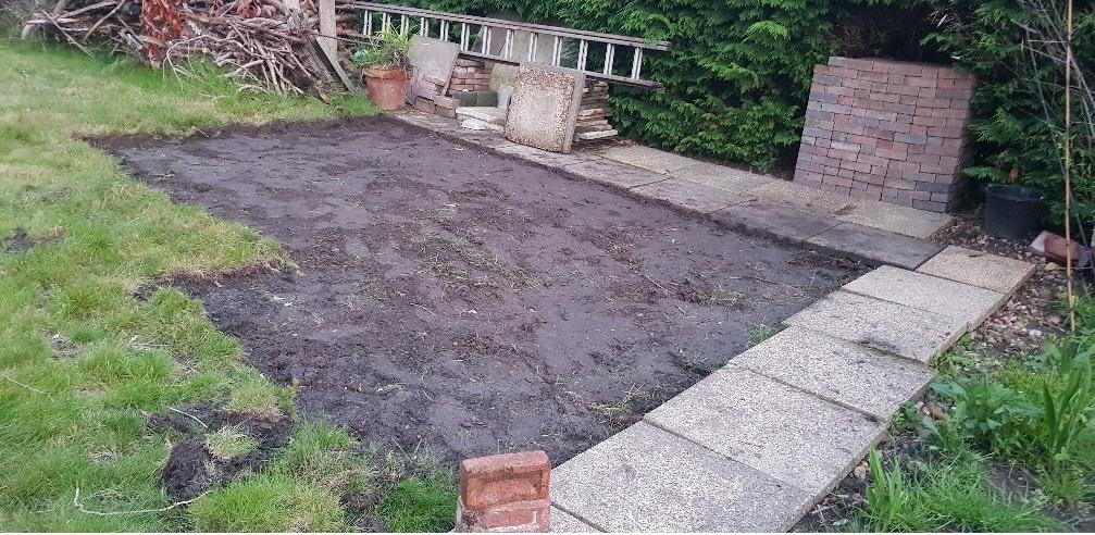

oldkettle Posted August 9, 2021 Author Posted August 9, 2021 (edited) A change of plans: after another discussion with a friend I've decided to position the garage on the opposite side where it will not be occupying the sunniest part of the garden. As shown in the picture, it's next to the conifers which I will cut heavily for now (most likely all the way to the trunk) thus giving me space to move the base closer. Then I will put aggregates down and cover with paving stones. There are a couple of questions - I hope somebody can advise. 1) I have textile membrane (the same I bought to put under the delivered aggregates) and plan to use it but taking into account the proximity of the trees is it worth putting down heavy duty landscape fabric first? 2) the difference in levels is significant - about 400mm over 5.5m of length. I don't want to build retaining walls around the base if possible. Can I lower the far side somewhat (200mm?), dig a little trench above it and fill it with gravel? Our ground is relatively free draining due to sand and likely the slope, I don't think there is a significant risk of flooding there. At least if I need to raise the bottom part 200mm above ground I won't need to worry much about the whole base moving as opposed to the full 400mm. A friend also suggested adding a mix (cement + sand) around the perimeter and letting the whole thing set naturally. Edited August 9, 2021 by oldkettle fixed the pictures
markc Posted August 12, 2021 Posted August 12, 2021 Any geo membrane will be fine, and nothing wrong with digging in a few hundred mill. sectional garages do not put much load down and certainly to point loads so the base doesn’t have to be anything serious. We have free stood them on bare soil as temporary stores and they didn’t sink much at all. 1
oldkettle Posted August 12, 2021 Author Posted August 12, 2021 2 hours ago, markc said: Any geo membrane will be fine, and nothing wrong with digging in a few hundred mill. sectional garages do not put much load down and certainly to point loads so the base doesn’t have to be anything serious. We have free stood them on bare soil as temporary stores and they didn’t sink much at all. Thank you. Yes, I agree the sections are not heavy, it's only since I have to level the base anyway I am trying to do it reasonably well. No need for an extra root protection (i.e. vs tree roots) using a landscape one? Anything special I need to do to make sure I don't get water in from underneath apart from sealing the gaps between the pavers/around the sections?

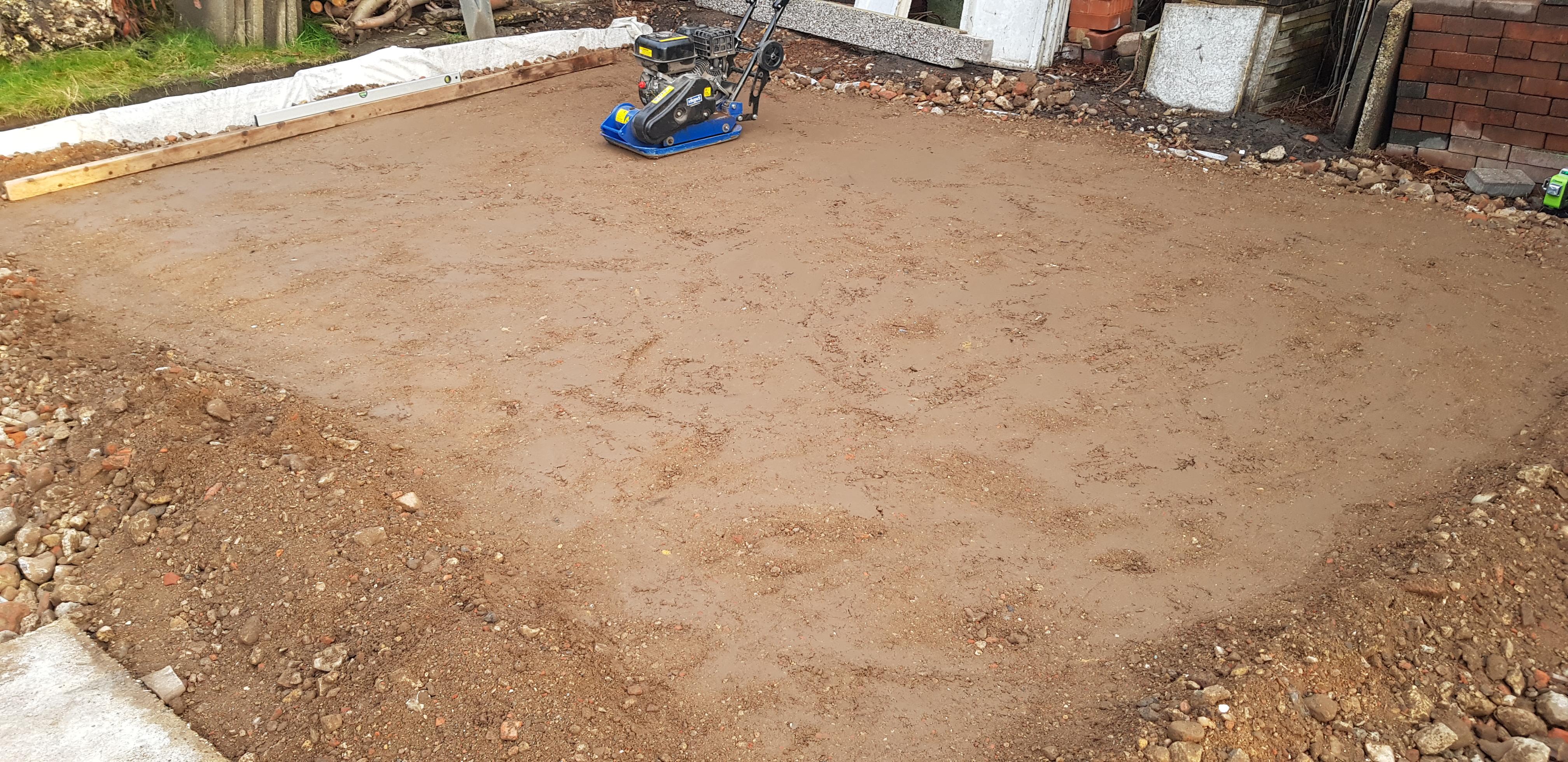

oldkettle Posted September 25, 2021 Author Posted September 25, 2021 A bit of a progress with laying the base. Managed to get 6F2 down and wacked reasonably well although not sure how much soil was in the aggregate. It is relatively level but requires bedding I guess. Should I use sand or dry or wet mortar mix now for the pavers? A bit concerned about just sand due to the slope as you can see in the picture - the front is slightly above the ground already.
oldkettle Posted September 26, 2021 Author Posted September 26, 2021 22 hours ago, oldkettle said: A bit of a progress with laying the base. Managed to get 6F2 down and wacked reasonably well although not sure how much soil was in the aggregate. It is relatively level but requires bedding I guess. Should I use sand or dry or wet mortar mix now for the pavers? A bit concerned about just sand due to the slope as you can see in the picture - the front is slightly above the ground already. Bump. I appreciate this is much less exciting than Brexit. I am quite close (am I?) yet can't get this finished properly without some guidance.
George Posted September 27, 2021 Posted September 27, 2021 Here you go: https://www.pavingexpert.com/blocks Best resource available on laying pavers. Used it a lot in specifying civil engineering works!

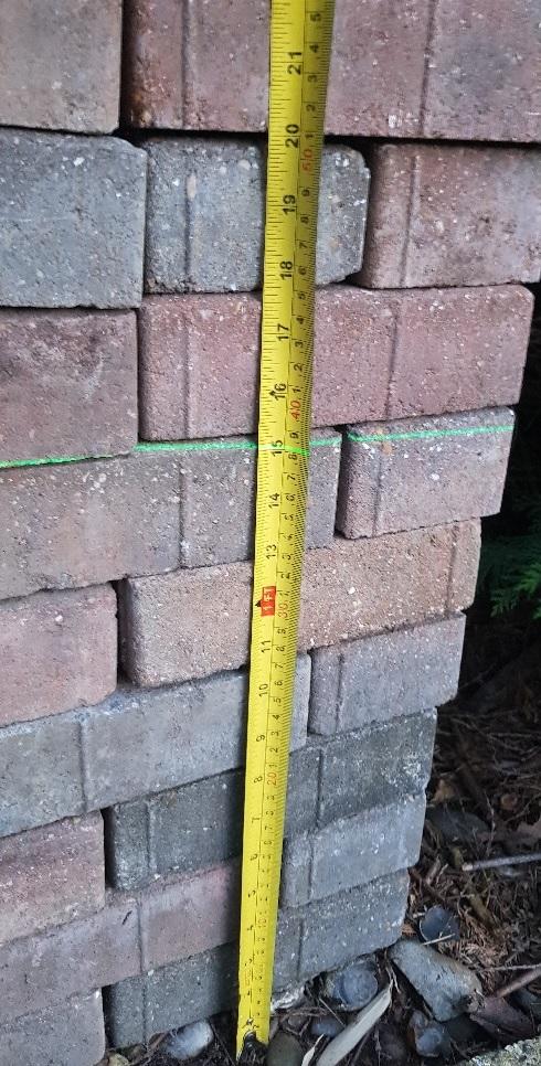

oldkettle Posted September 27, 2021 Author Posted September 27, 2021 (edited) 1 hour ago, George said: Here you go: https://www.pavingexpert.com/blocks Best resource available on laying pavers. Used it a lot in specifying civil engineering works! Thanks George I know the site and checked it several times. The issue is there is a slightly different advice in different places. They show how to use sand for paving stones but do mention the mix somewhere else. I need to understand whether I have to arrange a rigid border around the whole thing or not to keep the base stable and what is the simplest way forward in my specific case: sand, 2-6mm grit or some mortar mix. If it was just a garden path or a patio I wouldn't bother too much. Edited September 27, 2021 by oldkettle
George Posted September 27, 2021 Posted September 27, 2021 There is a lot of seemingly conflicting guidance but unfortunately that's usually because 'it depends' In your case, you should be doing flexible block paving (assuming you are using those clay pavers pictured above) https://www.pavingexpert.com/blocks2 You need either a kerb / edging block / something solid to edge the perimeter of the block paving. These need to be haunched with a sand/cement mix, or a concrete mix. The inner blocks can be laid onto non-cementitious bedding sand. For bedding it needs to be sharp sand, ideally washed (so salt content is lower) . Jointing sand to fill the gaps between pavers. 1
oldkettle Posted September 27, 2021 Author Posted September 27, 2021 3 hours ago, George said: There is a lot of seemingly conflicting guidance but unfortunately that's usually because 'it depends' In your case, you should be doing flexible block paving (assuming you are using those clay pavers pictured above) https://www.pavingexpert.com/blocks2 You need either a kerb / edging block / something solid to edge the perimeter of the block paving. These need to be haunched with a sand/cement mix, or a concrete mix. The inner blocks can be laid onto non-cementitious bedding sand. For bedding it needs to be sharp sand, ideally washed (so salt content is lower) . Jointing sand to fill the gaps between pavers. I am using large 600mm concrete paving slabs. I am planning to put the garage sections in the middle of the perimeter slabs and then was planning to put smaller 450mm ones outside to have a nice wide path to walk around. So I guess I have to set this edge in a mix as you describe and then just use sand. Great, much cheaper than grit it seems. The only issue is edging will have to sit between the perimeter and path slabs which is a bit of a pain. Thank you, will give this a go then.
George Posted September 27, 2021 Posted September 27, 2021 Oh if you're using slabs then you're better off setting into cement:sharp sand bedding throughout. https://www.pavingexpert.com/pccflag1 1
