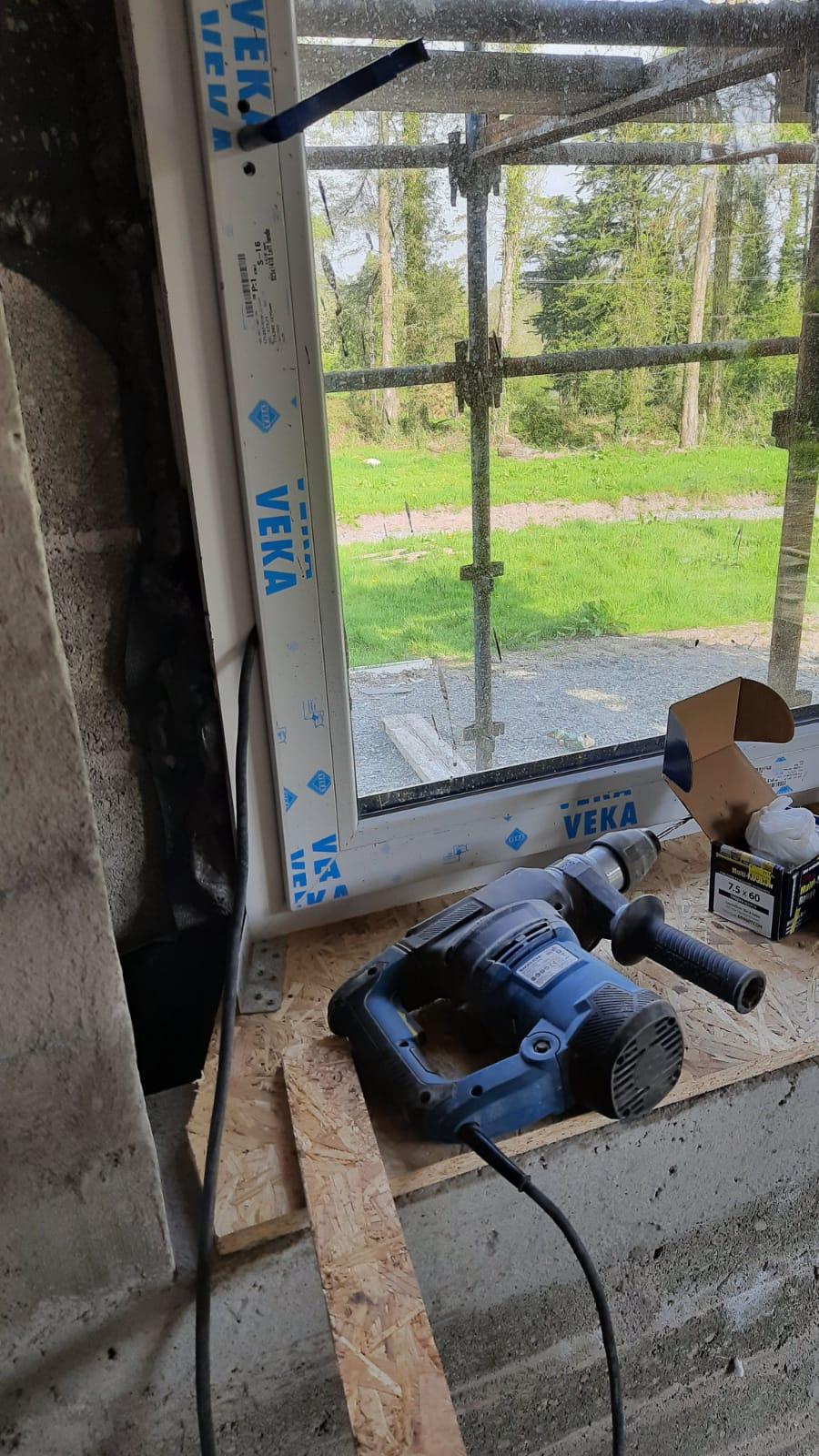

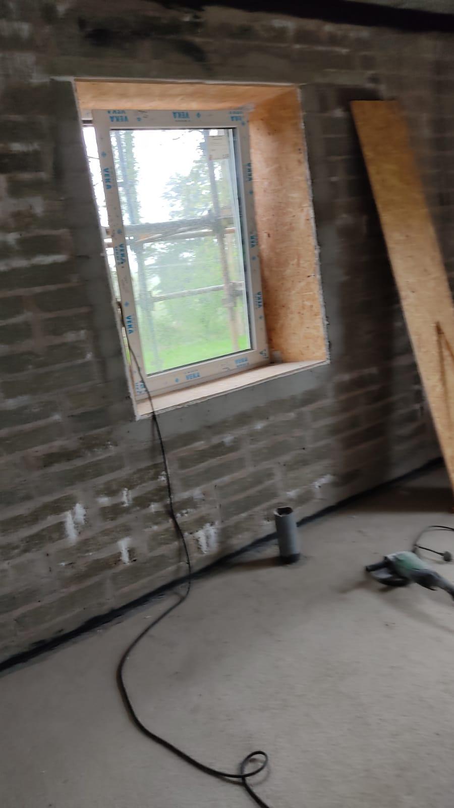

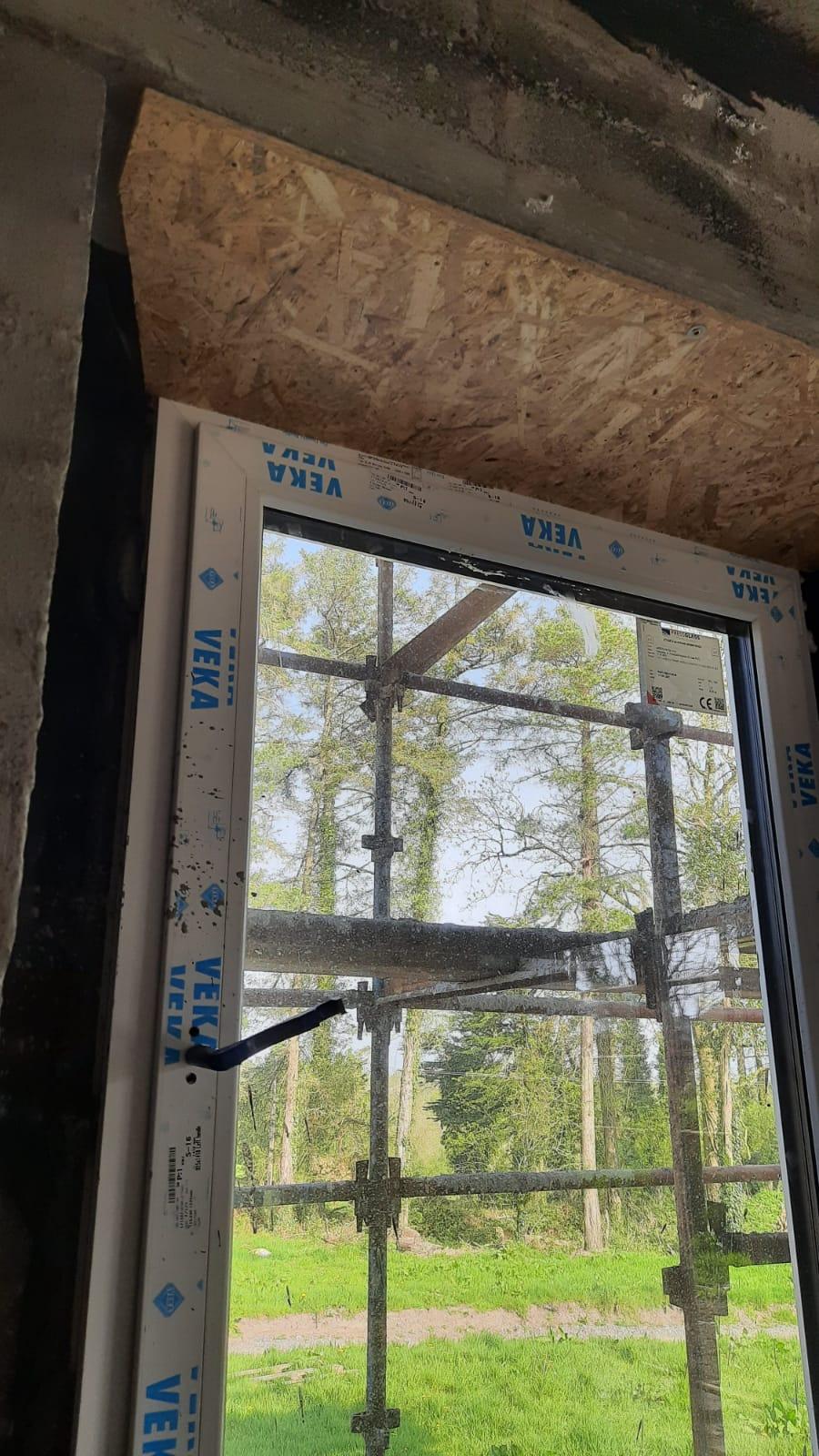

Iceverge Posted December 19, 2021 Posted December 19, 2021 1 hour ago, WWilts said: How did you fix the timber to the window frame? (assuming that's what you did) Glue? Screws? uPVC windows here (Koemmerling) Made an OSB sill and header. Then concrete screwed them to the inner leaf. Then added OSB reveals, again concrete screwed to the reveals. Used galvanised angle brackets to join them in place once finished. The boxes are not supporting the windows just themselves. They extend about 5mm beyond the edge of the window. Our windows are 82mm thick so there is still 77mm gap from the OSB to the outer leaf. I taped the window to the OSB. Used flexible airtight sealant and airtight paint to seal to the blockwork and the internal corners. Sorry about the photos. It's all I could find. 2
