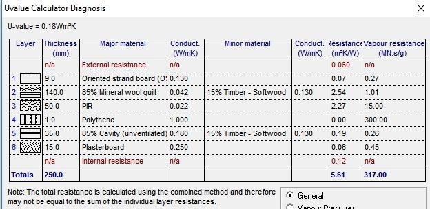

GrantMcscott Posted July 6, 2021 Share Posted July 6, 2021 Hi In between the studs in my timber frame I have used Thermaframe 40 is the adequate insulation? The architect specified Thermaframe 35 but i order the wrong one will this make much difference. There is no insulated plasterboard either on the walls just 15mm thick. So wall make up is Thermaframe 40 - VCL - service cavity then plasterboard Also people have questioned why it is not PIR insulation between the studs tight fitted Link to comment Share on other sites More sharing options...

GrantMcscott Posted July 6, 2021 Author Share Posted July 6, 2021 or Could go for this make up TF200 9mm OSB3 140 mm frametherm 40 Polythene vapour barrier. 50 mm PIR. Battened service cavity. Link to comment Share on other sites More sharing options...
A_L Posted July 6, 2021 Share Posted July 6, 2021 43 minutes ago, GrantMcscott said: or Could go for this make up better, U=0.18W/m2K, do not compress mineral wool as it increases the thermal conductivity by an unknown amount 1 Link to comment Share on other sites More sharing options...
GrantMcscott Posted July 6, 2021 Author Share Posted July 6, 2021 (edited) 31 minutes ago, A_L said: better, U=0.18W/m2K, do not compress mineral wool as it increases the thermal conductivity by an unknown amount what calculator is this? Edited July 6, 2021 by GrantMcscott Link to comment Share on other sites More sharing options...
