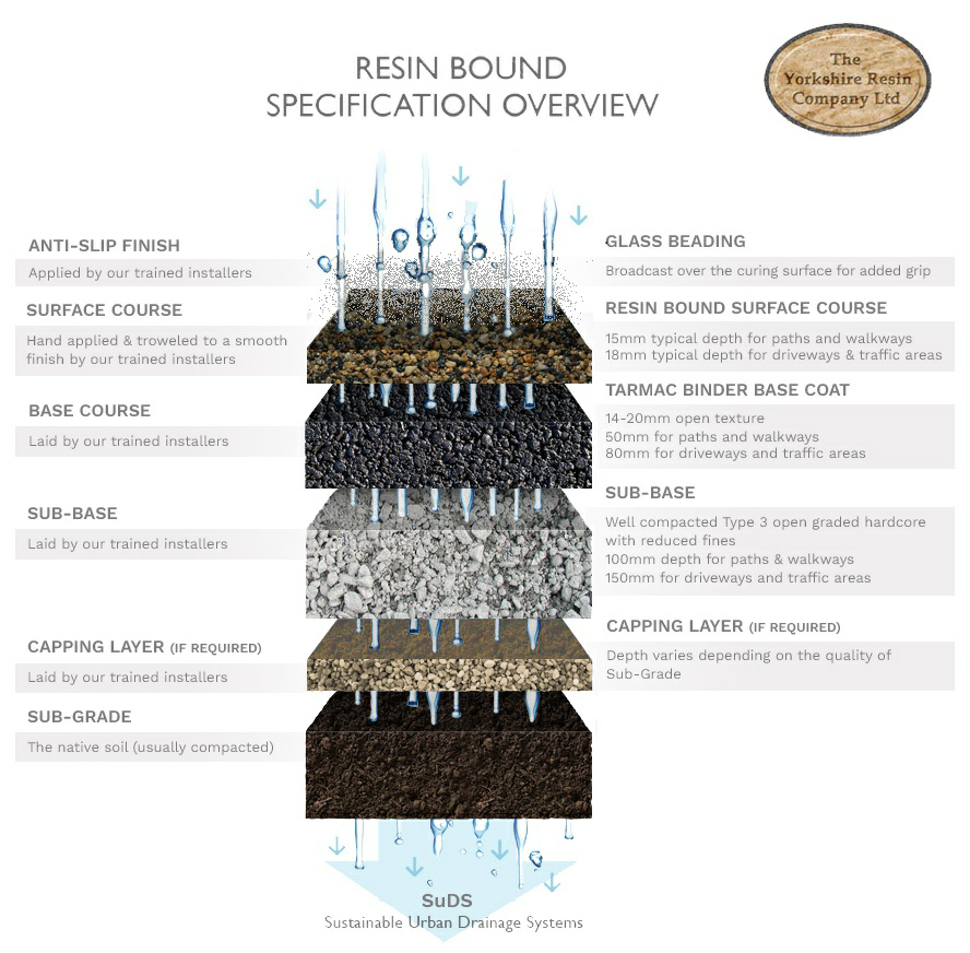

Weebles Posted July 5, 2021 Posted July 5, 2021 We are finally getting quotes in for a resin bound driveway. There is a difference on the build up Quote 1: 220mm "mechanically compacted limestone", 60mm tarmac, 18mm resin Quote 2: 100mm type 1 scalpings, 60mm tarmac, 20mm resin Its the difference in the build up that is making me wonder what is "right"? Any other resin driveway owners happy to share their build up please?
Ronan 1 Posted July 5, 2021 Posted July 5, 2021 The depth of limestone /type 1(which could be the same thing) is the only main difference and will be dependant on your ground. Is it going down on muck or is there a subbase laid already??
Temp Posted July 5, 2021 Posted July 5, 2021 (edited) MOT Type 1 covers a wide variety of hardcore materials, everything from virgin crushed limestone to recycled concrete and brick. Scalpings are what they scrape off roads before resurfacing. I would expect over 150mm of hardcore under a driveway so quote 1 is looking better than 2. You may also want to put some kind of weed control membrane down? Here is another spec for comparison. Type 3 is a porus hardcore that lets water through. Type 1 isn't always porous. Edited July 5, 2021 by Temp
Thorfun Posted July 5, 2021 Posted July 5, 2021 I'd hazard a guess that quote 1 is SUDS compliant but Quote 2 isn't as the type 1 isn't permeable? Also, the depth of the sub-base will depend on the type of sub-grade material. our civil engineer specified 235mm type 3 subbase, 70mm porous tarmac, 20mm resin bound gravel. someone who actually knows what they're talking about will be along soon I'm sure.
Gone West Posted July 6, 2021 Posted July 6, 2021 On 05/07/2021 at 21:14, Weebles said: Any other resin driveway owners happy to share their build up please? Expand We had 200mm type1, 70mm asphalt, 20mm resin bound gravel.
Bitpipe Posted July 6, 2021 Posted July 6, 2021 On 06/07/2021 at 07:49, Gone West said: We had 200mm type1, 70mm asphalt, 20mm resin bound gravel. Expand We had similar. The sub-base layer will be dependent on the ground conditions and how deep you need to go down to get to something firm. Our base layer was limestone (?) scalping (pink) as they compacted nice and smooth vs the generic 'crush' that was used under paving. @Weebles who are you using? We went with Pavillion Paving.
