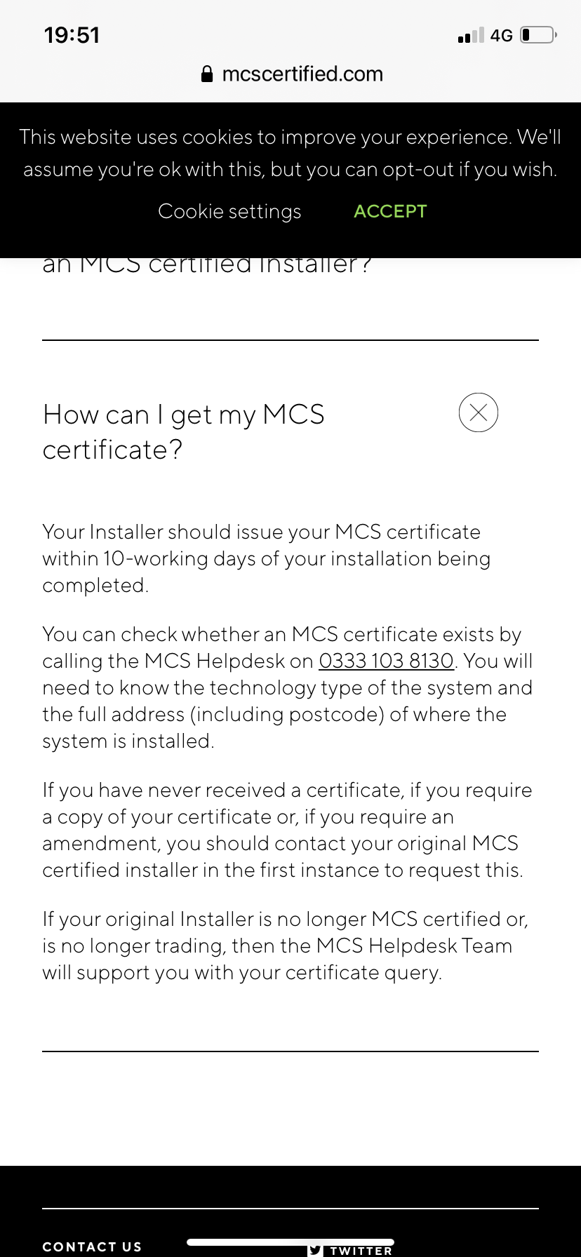

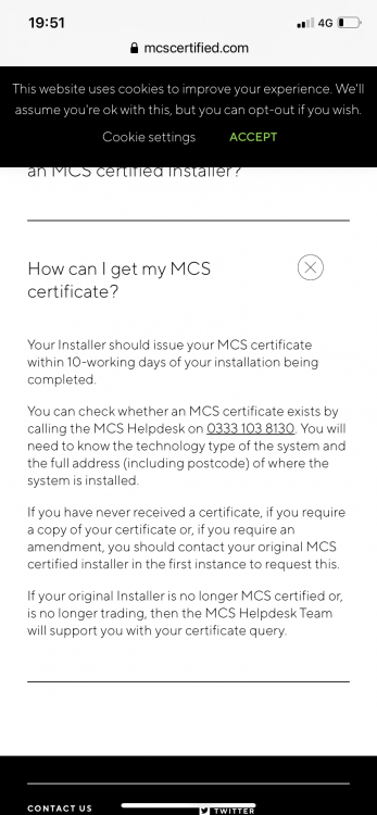

Thanks for all the replies. I have had a look at the MCS registration site, but it won't let me in. I should have said that according to Google Earth the panels were fitted sometime between 2007, and 2017. My concern is that, as an old boy, he may have been talked into one of the rent a roof schemes, and i am aware that some of those are a total pain. Ie; you can't extend without the lease holders permission, you might be responsible for the maintainence, you don't get the fit payments. Although i don't need a mortgage, if i wanted to sell on, a lot of mortgage companies won't lend. If you can manage to track the leaseholder down, they will sometimes allow you to buy out of the lease, but normally at the remaining years of the fit payments, together with a premium.
I will have to go back to the exectutors to try and get some more info.....I bet they don't have a clue....My only alternative is to knock my offer down by a substantial amount.. I will keep you posted. Thanks for your time.
