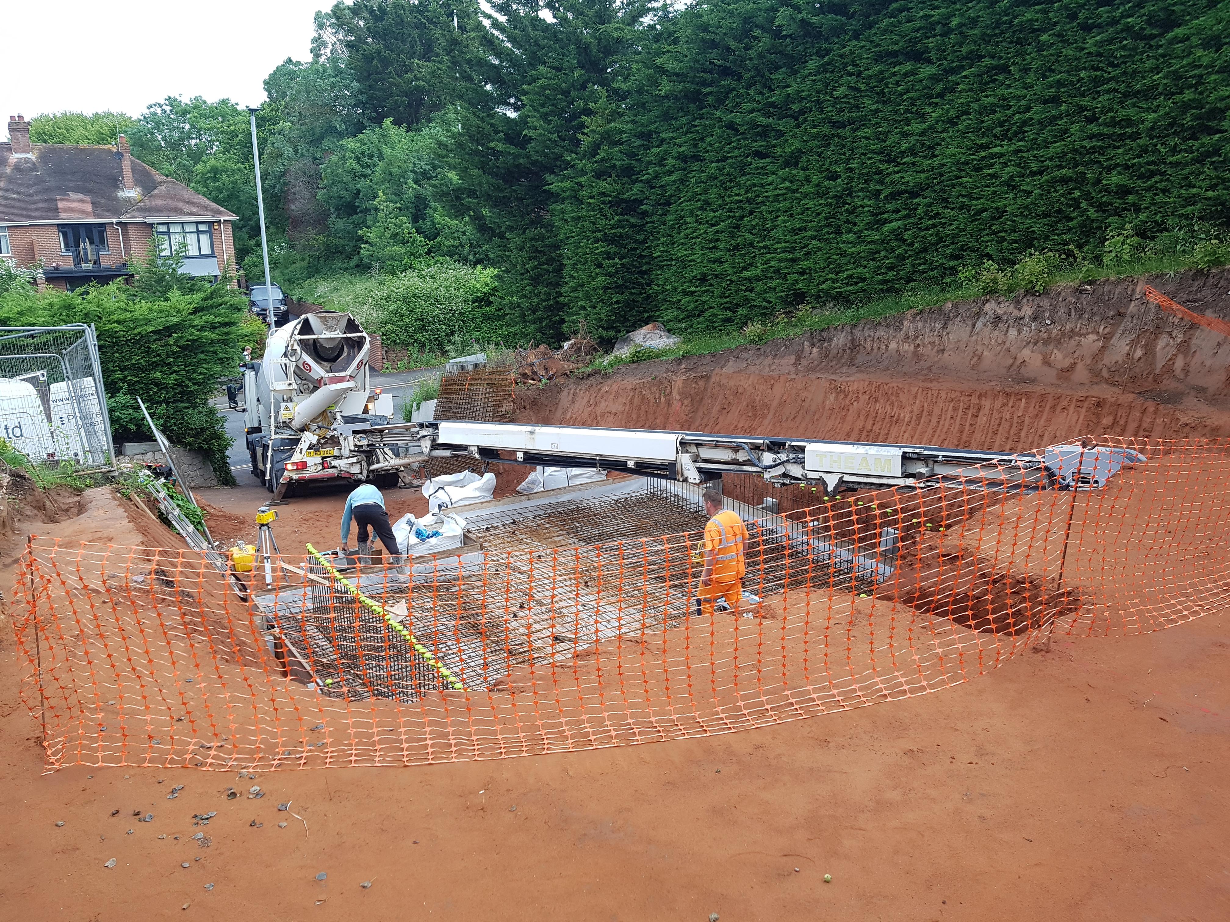

saveasteading Posted July 19, 2021 Share Posted July 19, 2021 Why don't the 3 of you in Devon/Cornwall help each other? Can't really recommend pumping over conveyor from the photo as it doesn't look as big as you say, and can't see whether the height up is a problem. Plus hire a couple of labourers from an agency. Hire a poker and whatever you need for the finishing. Link to comment Share on other sites More sharing options...
