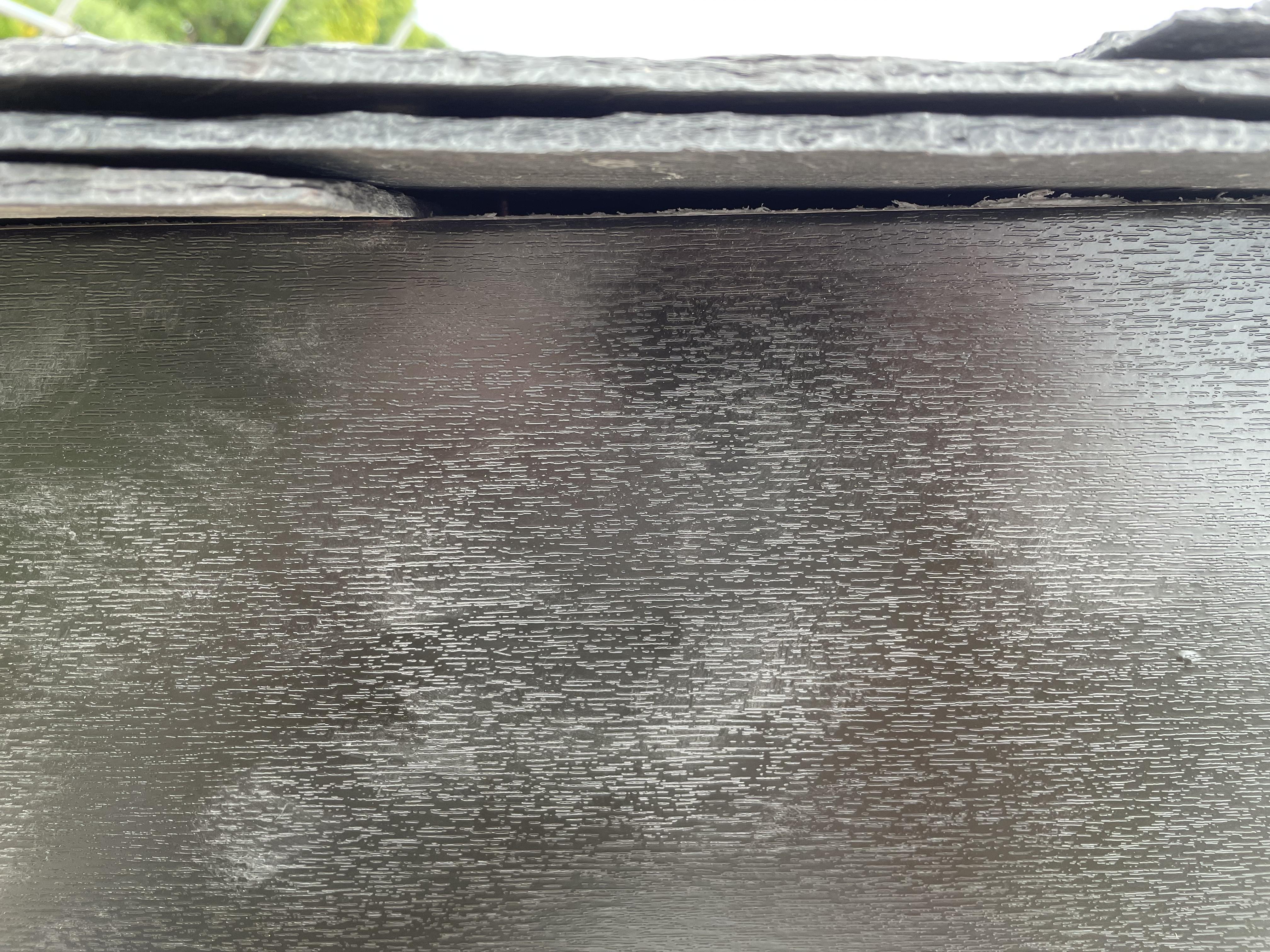

Jeremy22 Posted July 15, 2021 Author Share Posted July 15, 2021 (edited) The slates laying has begun, without a verge trim. There are small gaps under the slates, should I be worried? Should they be filled with sealant? What about wasps getting in and making nests? Edited July 15, 2021 by Jeremy22 Link to comment Share on other sites More sharing options...

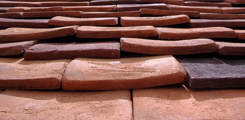

Temp Posted July 15, 2021 Share Posted July 15, 2021 I wouldn't worry. You can never seal a roof totally. Hand made tiles have loads of gaps.. http://www.sahtas.co.uk/product-tile-traditional-roof.html 1 Link to comment Share on other sites More sharing options...

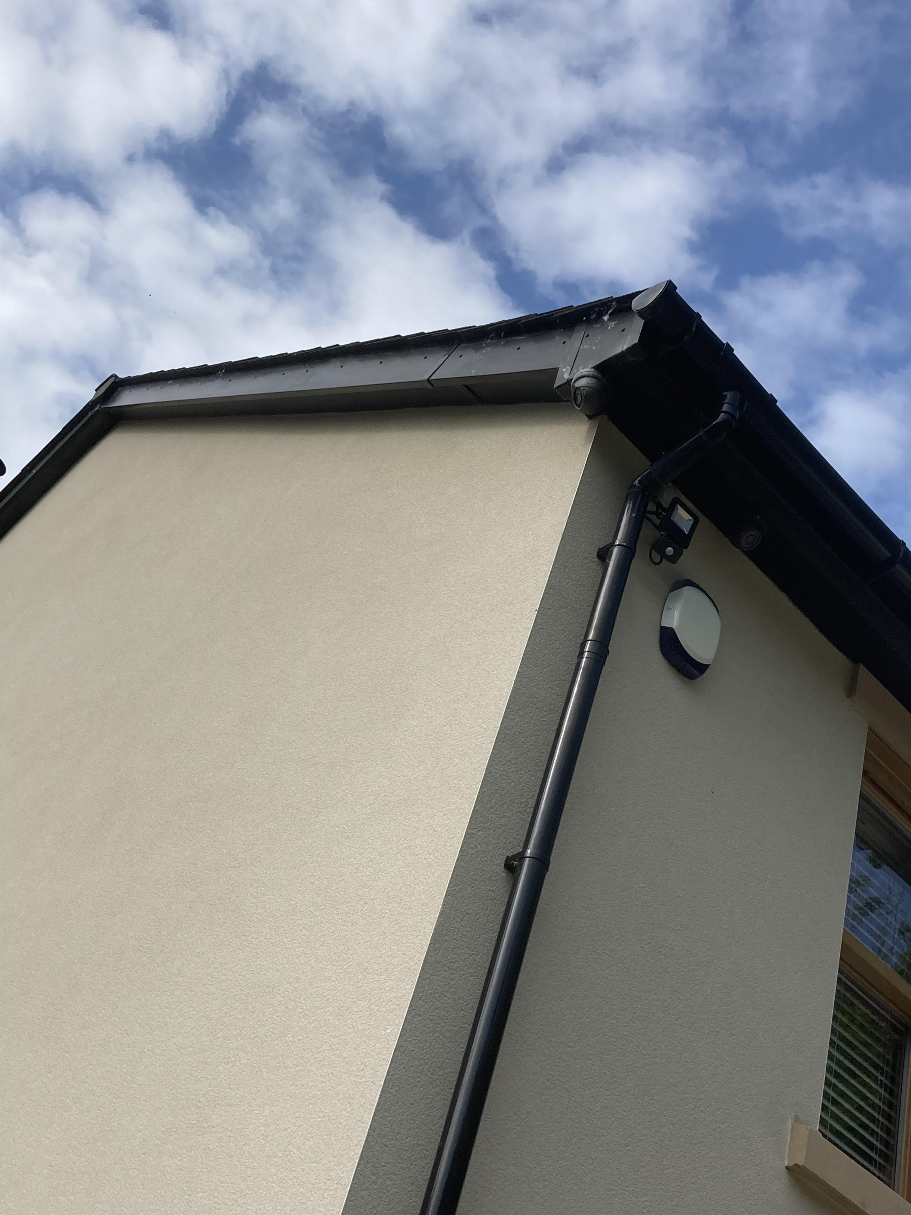

ruggers Posted June 6, 2024 Share Posted June 6, 2024 @nod @Jeremy22 Are these your own houses with the slate overhanging the upvc verge, dry? Any issues, wind catching under them and loosening them compared to wet verge? Link to comment Share on other sites More sharing options...
nod Posted June 6, 2024 Share Posted June 6, 2024 Yes the top pic is our previous build 6 years Link to comment Share on other sites More sharing options...
