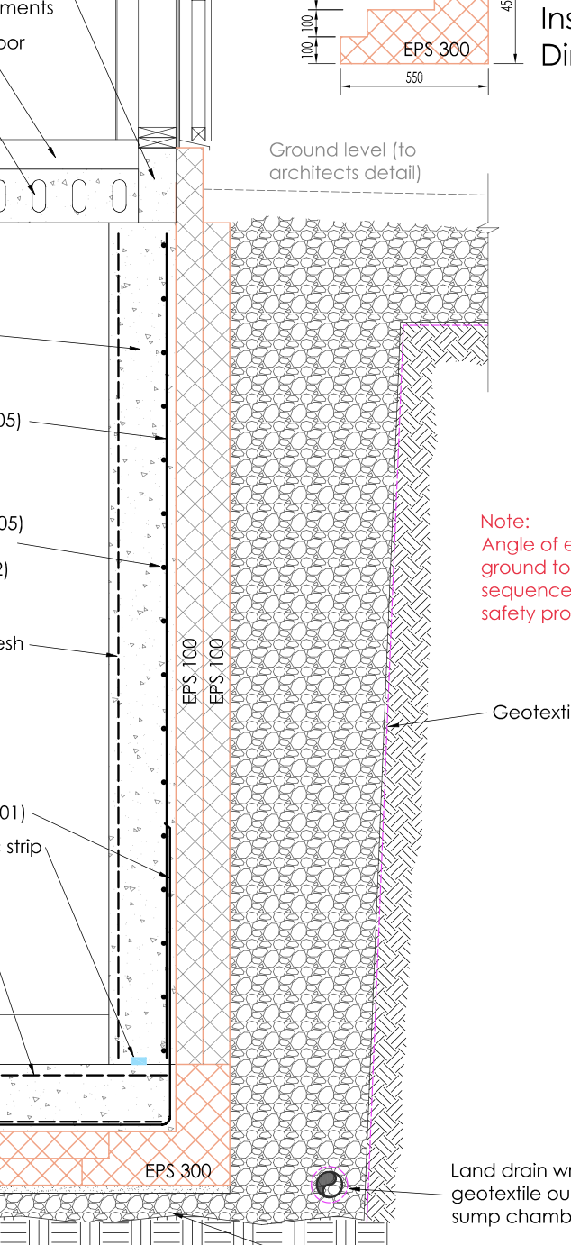

Thorfun Posted June 20, 2021 Share Posted June 20, 2021 the structural engineer has designed free-draining stone as our backfill material for around our basement walls. The groundworker is giving me an option between shingle and graded crushed rock chalk. the rock chalk is cheaper. what are peoples opinions of which is best to use and why? I will ask the SE but as it's Sunday that will have to wait so I thought I'd ask the knowledgeable folk on here to get opinions as part of my own research. Link to comment Share on other sites More sharing options...

Thorfun Posted July 8, 2021 Author Share Posted July 8, 2021 (edited) hi all. I have another question on the backfill and am also looking for opinions. How high should the free draining stone be filled to? i.e. should I top it off with site spoil? if so, how much? 40cm? 60cm? 100cm? or should the backfill stone be taken up to the top of the basement walls? The SE drawings show stone to the top of the walls in places but also says "Ground level (to architects detail)" which isn't that helpful. we're not exactly sure what we're going to do around the perimeter of the house yet but maybe some small shrubs, or maybe a path, or maybe just laid to lawn so it's hard to know exactly what to cater for. we will have some drainage for the roofs where the backfill will be and that is approx 600mm below FFL (FFL is approx 275mm above the top of the basement walls). At the moment I've told the groundworkers that I'm happy with 60cm - 80cm of site spoil (i.e. clay) above the backfill (on top of geotextile of course) and I can then put topsoil on top of that if gardening or just dig it out down to the backfill if patio/path. too much spoil? not enough? can you tell I'm confused as to what to do? Edited July 8, 2021 by Thorfun Link to comment Share on other sites More sharing options...
Oz07 Posted July 8, 2021 Share Posted July 8, 2021 Think I'd be taking up to ground level but not familiar with the standard practice Link to comment Share on other sites More sharing options...
Thorfun Posted July 8, 2021 Author Share Posted July 8, 2021 12 minutes ago, Oz07 said: Think I'd be taking up to ground level but not familiar with the standard practice thanks Oz. I'm also not familiar with standard practice! hoping @Bitpipe will be along soon to tell us what he did but I'm liking your thinking tbh. maybe not to ground level though, maybe to the top of the basement walls as per the SE drawing? Link to comment Share on other sites More sharing options...
Oz07 Posted July 9, 2021 Share Posted July 9, 2021 You could cap it with some decorative gravel I'd of thought. To me it looks like the drawing asks for it to come up to ground level? 1 Link to comment Share on other sites More sharing options...
Onoff Posted July 9, 2021 Share Posted July 9, 2021 Shouldn't there at least be a layer of geotextile above the bulk of the backfill with a say decorative (if the bulk fill material doesn't suit), topping over that? Otherwise, over time, small debris particles will filter down. Link to comment Share on other sites More sharing options...
Thorfun Posted July 9, 2021 Author Share Posted July 9, 2021 1 hour ago, Onoff said: Shouldn't there at least be a layer of geotextile above the bulk of the backfill with a say decorative (if the bulk fill material doesn't suit), topping over that? Otherwise, over time, small debris particles will filter down. I’m putting geotextile on top of the backfill. Link to comment Share on other sites More sharing options...
