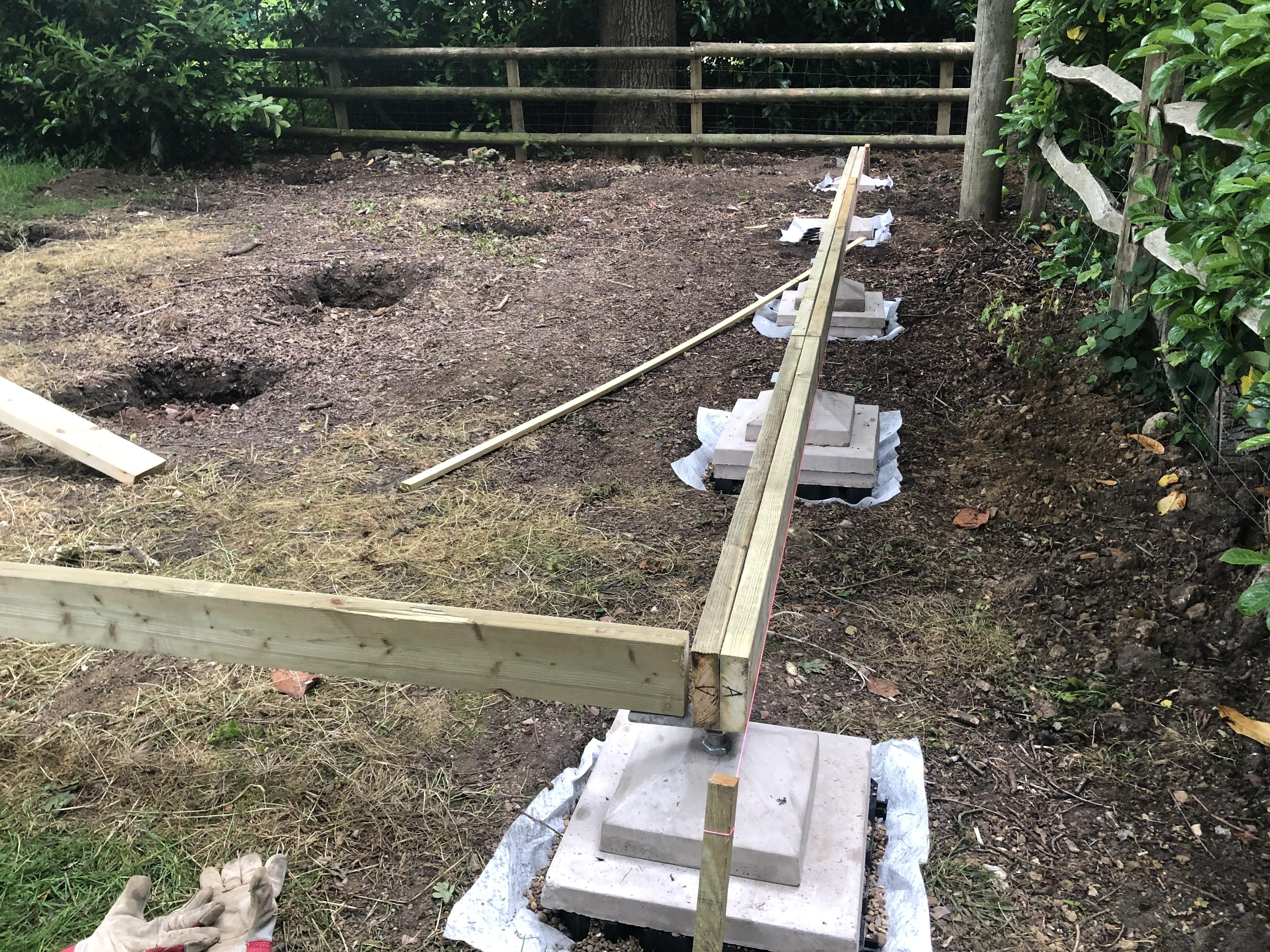

I've build a plinth-based base that's off the ground with frame and joists etc. + reinforced membrane (to keep pests off my PIR) and then PIR.

Got any pictures of the base so far?
The "wet" shouldn't be getting anywhere near the ply floor edge if you've got a good wall detail.
Worst thing you can do it make it up as you go along.
Post some pictures and people here will chip in with good ideas.

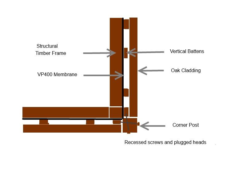

I designed and built my own outbuilding on a concrete slab. Put a lot of thought into keeping water out. What I did was arrange for the slab to be the size of the frame but smaller than the clading. I laid two courses of engineering blocks on the slab then a DPC and the frame sits on top. The cladding extends down over the brick. Any water running down the cladding drips onto gravel surrounding the slab. Any water blown under the  bottom edge of the cladding is stopped by the brick courses. This one doesn't have an insulated floor but i could lay a sand blind on the slab, DPM lapped up the wall then PIR topped with OSB flooring.

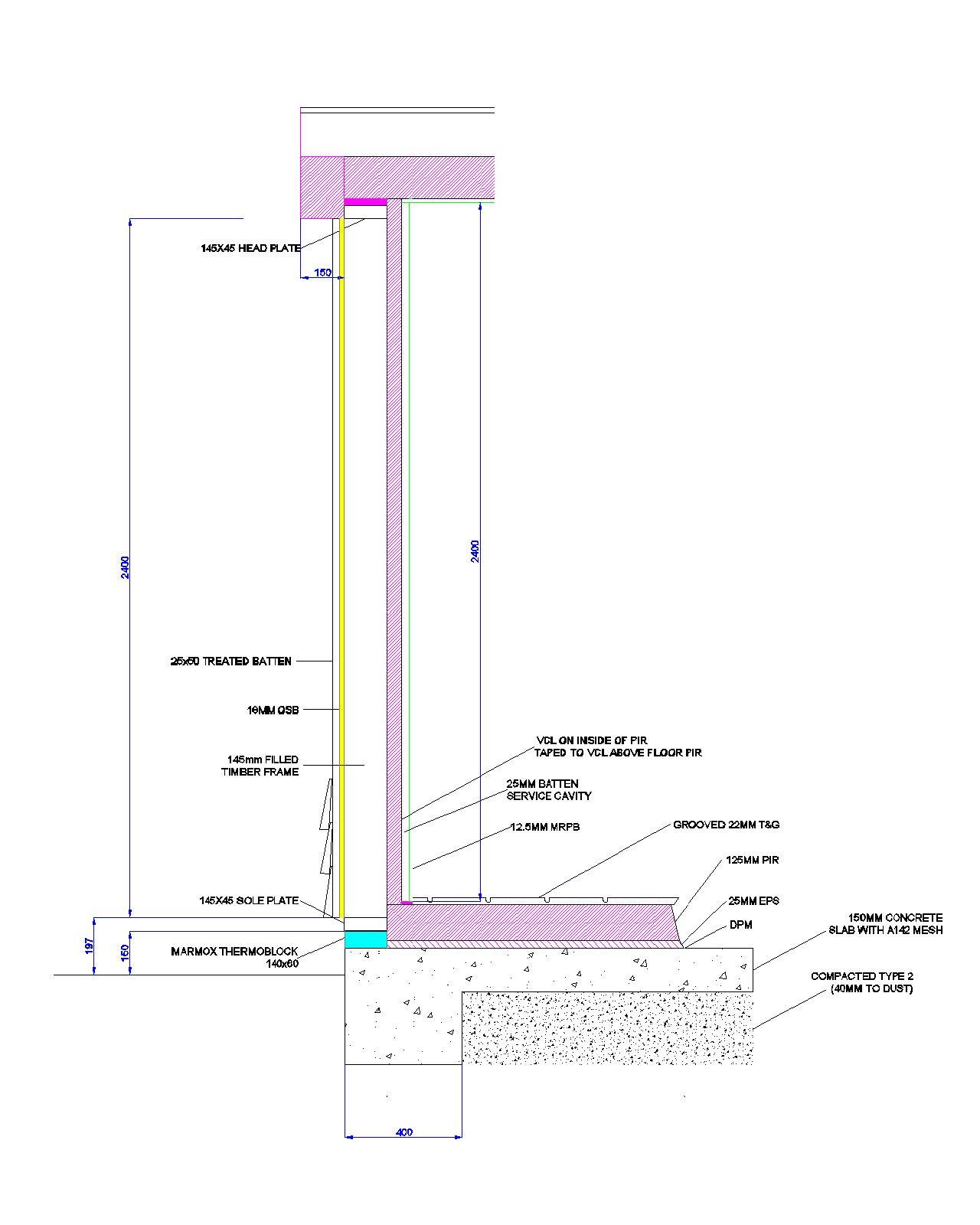

have you got any drawings / detailing, i am struggling with my floor detail and getting it to work, as below

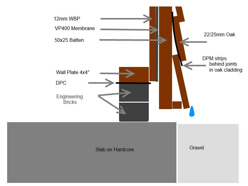

I can't find my old sketchup drawings but made this sketch. Think the construction is similar to yours.
Some details...
* When I laid the slab I pushed 12mm stainless steel threaded rods (with nuts on) into the slab so I could bolt down the wall plate later. Mostly because we are in a windy location near top of hill. (Caution: These are very dangerous until covered up. I nearly fell onto one!)
* I extended the vertical battens down until they are about 30mm off the top of the slab so the lowest cladding plank hides most of the brick. I used gravel around the slab to reduce splashing and haven't had a problem with the bottom planks (but they are oak).
* I didn't bother with rebar mesh in the slab but probably should have done. Not been a problem though.
* I used 12mm WBP rather than 9mm OSB because mine has a pitched tiled roof. Some of the frame (eg corners) was also made from 4x4 rather than 2x4.
* Where there are joints in the cladding boards I put strips of DPM behind to deflect water to the outside. These were trimmed back flush with the bottom of the planks later and can't be seen unless you peer into a joint. Not sure if this is essential or not. To support the joints you can either use wide battens (so nails aren't too close to the end of a board) or fit short extra vertical battens so there are two, one either side of the joint.
* At the corners of the building I fitted (mostly decorative) posts like this (Plan view). These corner posts were also supported 30mm off the slab using stainless steel bolts in holes drilled into the ends. They were also screwed to vertical battens and the screw heads plugged to simulate pegged construction.
My unfinished (that's an in joke here ?) attempt at a garden room section. As this is an infilled stud wall I'd plan to put a continuous insulation layer inside to mitigate cold bridging. Similar detail at the ceiling and floor detail
One big thing is you want your cladding to stop 150mm above the "ground". Then pay attention to whatever's below that to protect it. Missing from my drawing is "cladding"  over the sole plate and thermoblock. I'd likely use aluminium. Some have used black uPVC cladding which looks great.
The age old premise is that an average raindrop hits the ground and bounces up about 6".
I'd maybe look to move the OSB to the inside of the studs, better for screwing things on walls.
