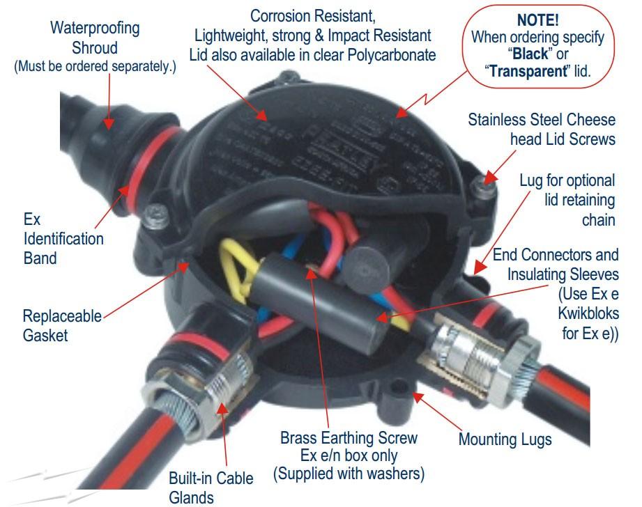

ash_scotland88 Posted September 18, 2021 Author Posted September 18, 2021 (edited) Lights finally ordered - yay! Still need to order the joints though. Need 4x 3way and 1x2way. Doesn't need to go underground, can be attached on the back of walls. So looking at: 1x https://www.tlc-direct.co.uk/Products/PRUBX02.html 4x https://www.tlc-direct.co.uk/Products/PRUBX03.html And some conversion kit as I presume the lights will come on 1.5mm HO7 cable, but struggling to find the suitable size. Edited September 18, 2021 by ash_scotland88 more info
TonyT Posted September 19, 2021 Posted September 19, 2021 (edited) Forget about the pratley boxes Use plastic Ip box, fit with CW glands and IP washers, bottom entry on cables into joint box and it will look smarter and be cheaper. Edited September 19, 2021 by TonyT

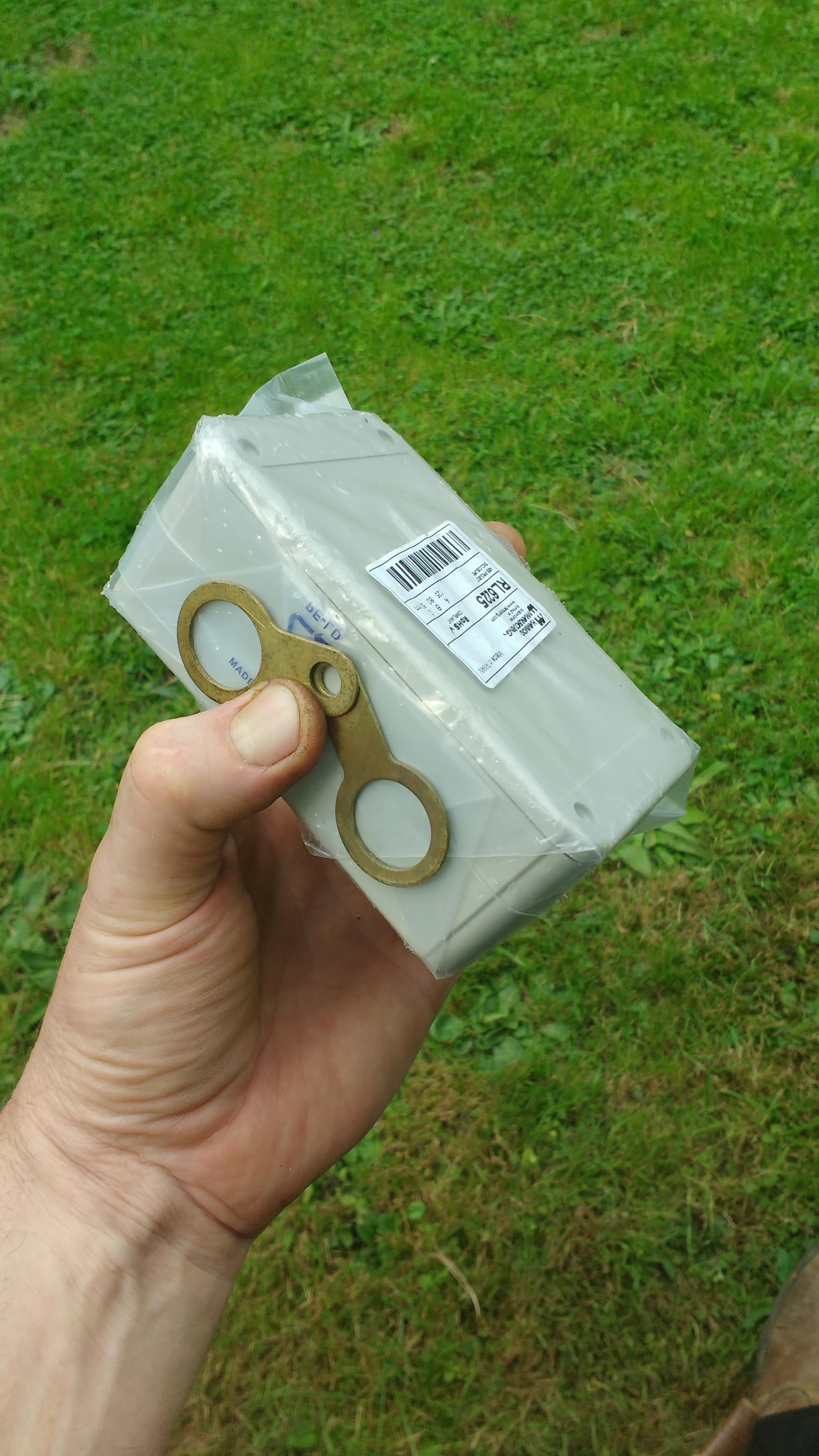

ash_scotland88 Posted September 19, 2021 Author Posted September 19, 2021 Is this still an expensive option? https://www.medlocks.co.uk/avenue-swa-junction-box-black-32a-5-terminal-earthing-plate-ip66 Or just this: https://www.toolstation.com/moulded-pvc-box-ip65/p91800 And https://www.screwfix.com/p/tower-brass-exterior-gland-kit-20mm-2-pack/25996?kpid=25996&ds_kid=92700055281954475&ds_rl=1249401&gclid=Cj0KCQjwv5uKBhD6ARIsAGv9a-zFC6YP_83l1uPAb1_uYxkQ3aCZwb5dmAHHEtFX2dO3fx042MPO7fEaAtafEALw_wcB&gclsrc=aw.ds Guessing I would need some spare earth cable and crimps to link all earthing, and would small screws come as standard with the SWA glands?
TonyT Posted September 19, 2021 Posted September 19, 2021 You want a box with enough space to bland all the cables in the bottom. you get a 20mm hole saw and drill the holes to suit yourself.
Onoff Posted September 19, 2021 Posted September 19, 2021 If you get a plain, IP6x rated box and drill the gland holes yourself, you can arrange the 2 banjos so they "meet" and you can use x1 6mm brass bolt. Take an earth fly lead off that with a ring crimp. Just use Wagos inside to connect everything together. Sort of like this, bits grabbed at random in the shed:
ash_scotland88 Posted September 19, 2021 Author Posted September 19, 2021 I want a shed filled with bits and pieces to grab at random ☹️ Cheers guys. I get it now.
