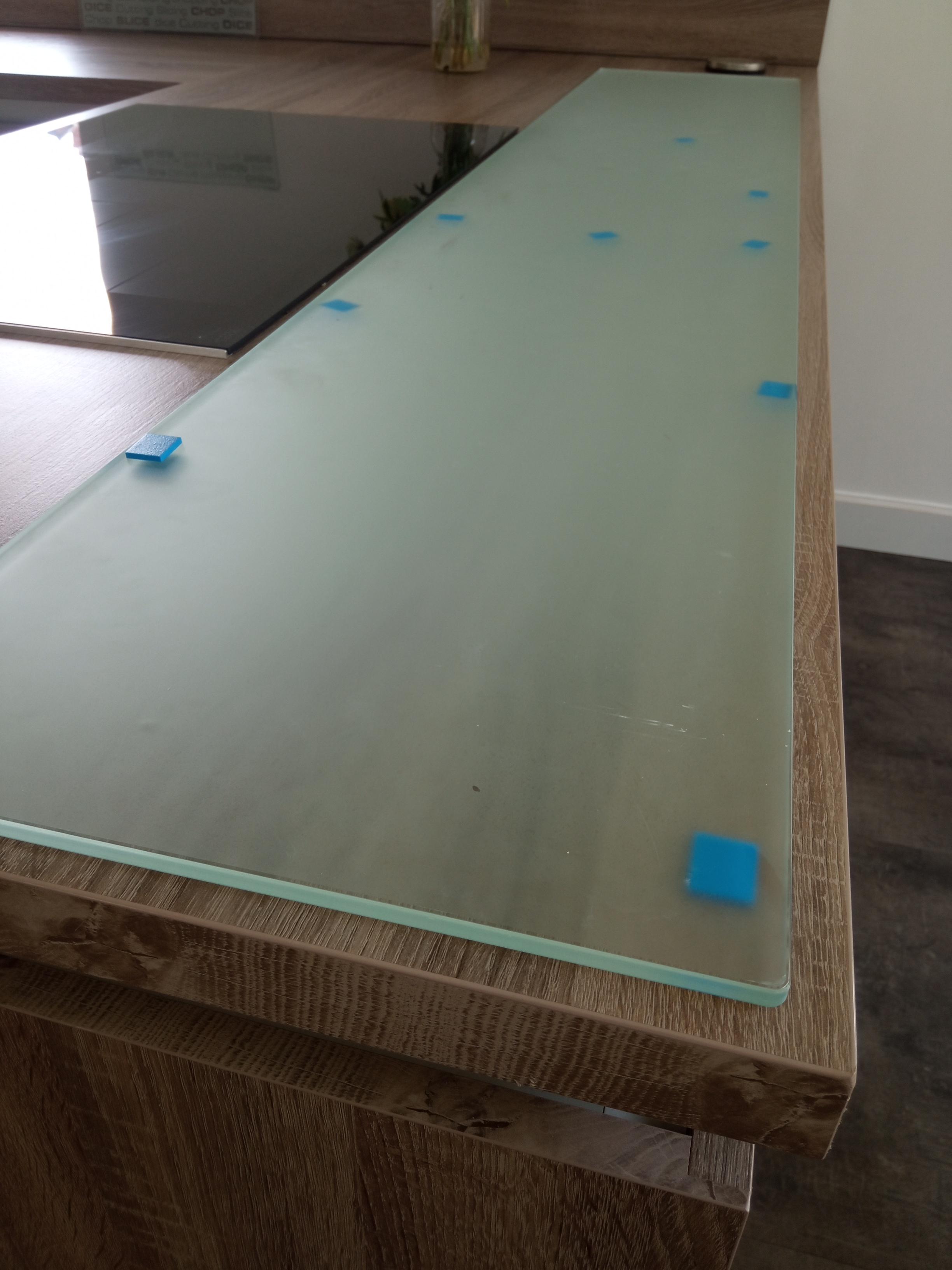

canalsiderenovation Posted June 14, 2021 Posted June 14, 2021 I didn't measure it so taking no responsibility for this! It's around 2mm too big. It's frosted glass. Any way of sorting this out rather than having to buy another? If anyone could pinpoint me in the direction of any suitable products to sort this that would be amazing.
markc Posted June 14, 2021 Posted June 14, 2021 Is it toughened? if not then you can `sand` it down with a diamond sharpener. or rebate the opening it has to go into 1
canalsiderenovation Posted June 14, 2021 Author Posted June 14, 2021 13 minutes ago, markc said: Is it toughened? if not then you can `sand` it down with a diamond sharpener. or rebate the opening it has to go into It's 8mm toughened safety glass with 5mm radius corners (frosted).
markc Posted June 14, 2021 Posted June 14, 2021 19 minutes ago, canalsiderenovation said: It's 8mm toughened safety glass with 5mm radius corners (frosted). Frosting is ok but as its toughened you have to be careful with the edges. at 8mm it will grind/sand down pretty quickly with a diamond plate
Temp Posted June 14, 2021 Posted June 14, 2021 Good luck but from what I hear toughened glass is likely to shatter. Would it fit another window? Can you modify the window opening?
canalsiderenovation Posted June 14, 2021 Author Posted June 14, 2021 (edited) 1 hour ago, Temp said: Good luck but from what I hear toughened glass is likely to shatter. Would it fit another window? Can you modify the window opening? Our plasterer says not as it's metal under the plaster but for the sake of 2mm I'm wondering whether to try and sand down some of the plaster. Unfortunately not, we only had glass ledges for two bathrooms and the kitchen the rest are MDF and it's a large kitchen window. Edited June 14, 2021 by canalsiderenovation
Mr Punter Posted June 14, 2021 Posted June 14, 2021 Definitely easier to sand down some plaster. If you accidentally gouge a bit out you can always fill it. 1
ProDave Posted June 14, 2021 Posted June 14, 2021 The metal will only be the corner beads. Cut that away with a fine tooth hacksaw, then chisel into the plaster with an old small chisel to allow the glass in. then make good with filler. 1 1
canalsiderenovation Posted June 14, 2021 Author Posted June 14, 2021 Thanks @Mr Punter and @ProDave sounds a bit better. Perhaps I'll add this to the dad list when he gets sick of motorway barriers ?
