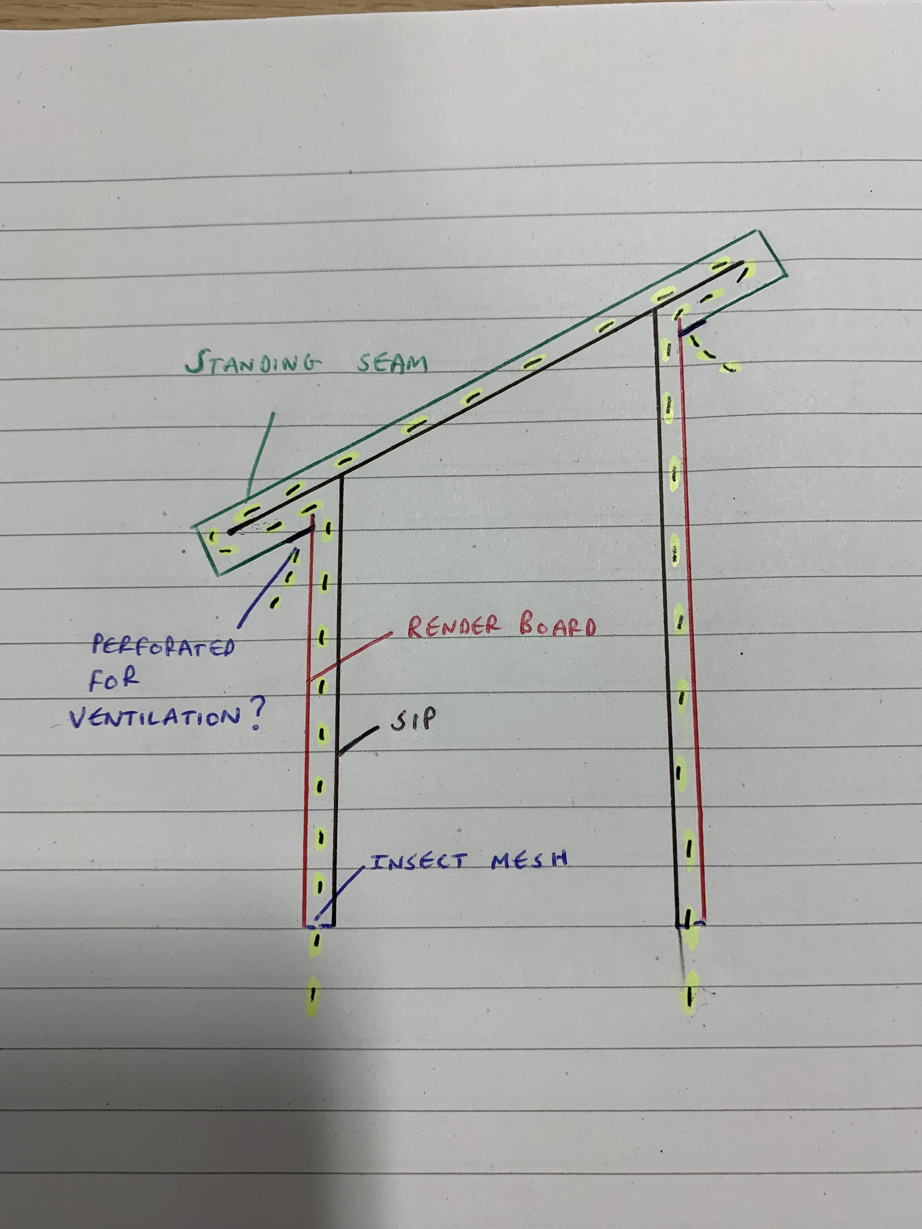

Ryan Bazeley Posted June 25, 2021 Author Share Posted June 25, 2021 Hi, do you guys have any photos or drawings showing how to finish render board where it meets the soffit to keep a ventilation gap? My roof is standing seam with a metal soffit and I am struggling to know how to finish where these meet without it looking rubbish? Link to comment Share on other sites More sharing options...
Bitpipe Posted June 25, 2021 Share Posted June 25, 2021 On 14/06/2021 at 19:30, Mr Punter said: Often a warranty is worthless. Yes and no. If it's issued by the render manufacturer (Weber or Parex) then the installer needs to submit a design, which is approved, and there is some liability if the system fails. You can also fall back on your latent defects policy if there is a materials issue later. If it't not insurance backed or just issued by the installer then yes, likely worthless. Link to comment Share on other sites More sharing options...
Mr Punter Posted June 25, 2021 Share Posted June 25, 2021 6 hours ago, Ryan Bazeley said: Hi, do you guys have any photos or drawings showing how to finish render board where it meets the soffit to keep a ventilation gap? My roof is standing seam with a metal soffit and I am struggling to know how to finish where these meet without it looking rubbish? It you post up a detail someone could help. If the soffit is vented, you could use this. You will either take your render up to meet the soffit or render first, then butt the soffit up to this. Link to comment Share on other sites More sharing options...
Ryan Bazeley Posted June 25, 2021 Author Share Posted June 25, 2021 1 Link to comment Share on other sites More sharing options...
SimonD Posted June 25, 2021 Share Posted June 25, 2021 On 14/06/2021 at 18:08, Ryan Bazeley said: I was going to vent the walls out through the roof void, it is a SIP roof and I was planning on 25 x 50 battens with 18mm ply on top before the metal covering, Will 25mm be a big enough space? No, you need minimum 50mm ventilation gap below the ply supporting a metal roof. 7 hours ago, Ryan Bazeley said: My roof is standing seam with a metal soffit and I am struggling to know how to finish where these meet without it looking rubbish? Speak to your metal roofing contractor for their recommended detail as there isn't necessarily a need to use soffit vents as you can 'hide' the ventilation behind/below certain overlaps in the roofing/fascia/soffit buildup, or alternatively use verge ventilation instead. All depends on the whole picture. Link to comment Share on other sites More sharing options...
Ryan Bazeley Posted June 25, 2021 Author Share Posted June 25, 2021 (edited) Thanks Simon, Is it best for 50 x 50 or cross batten 25 x 50? cheers Edited June 25, 2021 by Ryan Bazeley Link to comment Share on other sites More sharing options...
Ryan Bazeley Posted June 25, 2021 Author Share Posted June 25, 2021 (edited) Decided it was best to use bigger battens for the render carrier board, gone for 38mm x 63mm treated CLS, the 50mm fixing face has been bothering me. The extra cost is insane!! Edited June 25, 2021 by Ryan Bazeley Link to comment Share on other sites More sharing options...
SimonD Posted June 25, 2021 Share Posted June 25, 2021 17 minutes ago, Ryan Bazeley said: Thanks Simon, 50mm x 50mm I take it then, will be fitting 18mm ply so will 50mm fixing face be enough. cheers This would be fine. Link to comment Share on other sites More sharing options...
