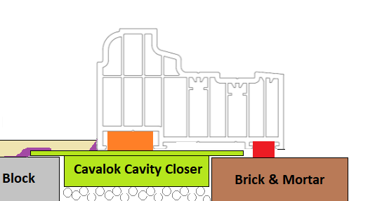

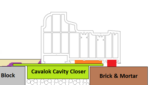

On 09/08/2021 at 11:18, MortarThePoint said:
Thinking about the ORANGE tape, there are two other obvious options below. It could contribute to air tightness, but ultimately the cavity closer also needs to be sealed to the blockwork which obviously can't be achieved by any tape on the frame.
Make it wider:
Move it to where there is another 'pocket' which I think is for the fixing lugs:
 Would you use tape for the orange section? The data sheets for the windows I have specify squirty cream (aka expanding foam) for the bit in the middle (assuming your pinks items are the airtightness seal).
P.S. on the width of expanding foam tape, I used 20mm throughout, I think you may get a good seal with less, but with 20mm you can misalign slightly (virtually impossible to get a really straight run in narrow gaps). I think to some extent the gap size of the tape also determines the widths available (i.e. larger tape widths for bigger gaps).
Most people use low expansion spray foam I think, but I'm going to try an expanding foam tape. As you say the airtightness is then done separately.
Thanks. Did you take your tape yo flush with the front face of the window or still recessed behind? The second being either filling a groove or overflowing behind. If not groove, I guess its a matter of how close did you get to the front face of the frame?
Link to comment
Share on other sites

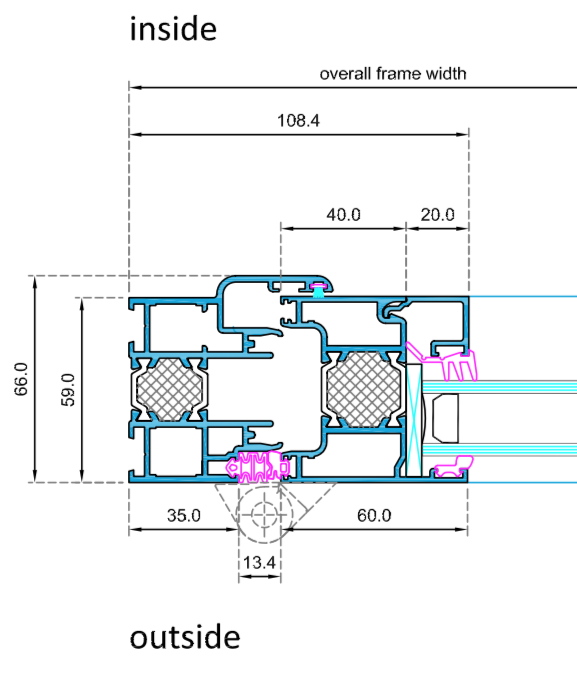

Some frames did not have recesses as such, so I set back circa 10 mm to make any non-straight runs of tape less visible. Other frames did have recesses - of circa 25mm width which needed to be missed and the tape placed on the wooden frame behind the recess (see pic above on V200E). I'm still deliberating how to seal the bifolds which do have a recess at the front that the tape would need to sit within (see pic below). I'm sure in practice the recess is deeper than shown in the pic and if the tape does not site neatly in the recess (i.e. parts in and parts out of the recess) we'll see a wavy line of tape as the recess is so close to the front on the frame.
Sorry forgot that. So that leaves a pocket 12mm by about 40mm around the window. Are you sealing that off with anything or leaving it open to the outside?
Link to comment
Manufacturer spec says leave open to the outside for the V200 Energy "No sealant material beyond the dotted line":
But differs depending on the type of window.
Link to comment
Interesting, so is that an Aluminium/Plastic/Aluminium sash with timber frame? Makes sense to have no sealant past the end of the timber frame. Does leave a bit of a spider home, but spiders are good.
