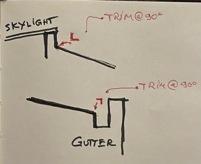

The shell of my ground floor extension has been built. It has a gable roof, more or less, with an 18 degree fall. I say "more or less" because it is rather bespoke and has some unusual features so as to conceal a gutter and skylight behind a parapet wall.
My builder has done the external deck with weatherproof ply, I think it's 18mm thick. We were then going to cover this with GRP before putting down trays for a seedum roof. Engineer has specified the rafters for this, structurally no problems. Because the roof was quite bespoke, my architect - who designed it - mentioned that it might be worth running the design by a specialist. I did and the specialist (who is a RICS surveyor and building engineer) made some tweaks which were quite sensible and also recommended we outsource the GRP and Seedum installation to a specialist roofing contractor that could give us a 20 year guarantee. Also sensible I thought. That contractor has now come and surveyed the roof. He has put the cat amongst the pigeons with the following:
He does not think that the "non-standard" angles we have where our concealed gutter and skylight connections are will work with GRP. As the cross section below shows, we have an obtuse angle that is probably about 110 degrees just to the right of the skylight and reflex angle that is probably about 250 degrees just above the gutter.e8a74ce6-aa32-4a54-a255-90983f3d2270.jpg.0ceb73a24d7c73f9d8d1b5984a57bb30.jpg
In both cases, I think the plan had originally been to use a 90 degree trim and bend it slightly to fit the angle, even though in both cases it would be out by about 20 degrees. The GRP contractor doesn't agree. He says:
I have not quoted for a GRP system due to the angles as the preformed trims are all set at 90˚ and will not work with this angles of the upstands / downstands. If GRP trims are forced into position there is a risk of them cracking when thermal movement occurs.
Instead he has quoted for the following:
The Triflex product is a latest generation PMMA resin system that forms a monolithic membrane that is elastomeric when cured and is the same waterproofing that we use on curved garage roofs. Triflex resins are more expensive than GRP but in my opinion Triflex is the correct product for this project.
My architect is quite surprised by this, because he thought GRP was very tough. Reading up on the forum, i see that others like @nod and @SteamyTea think it's tough too (e.g. here and here), although @markc did think it would crack if severely twisted. Does the forcing something designed for 90 degrees into a 110 degree situation, or perhaps even a 120 degree situation, count as severe twisting? If so, can't I lay the trims without twisting them and just have a slight air gap because it won't be flush due to the mismatch of angles?

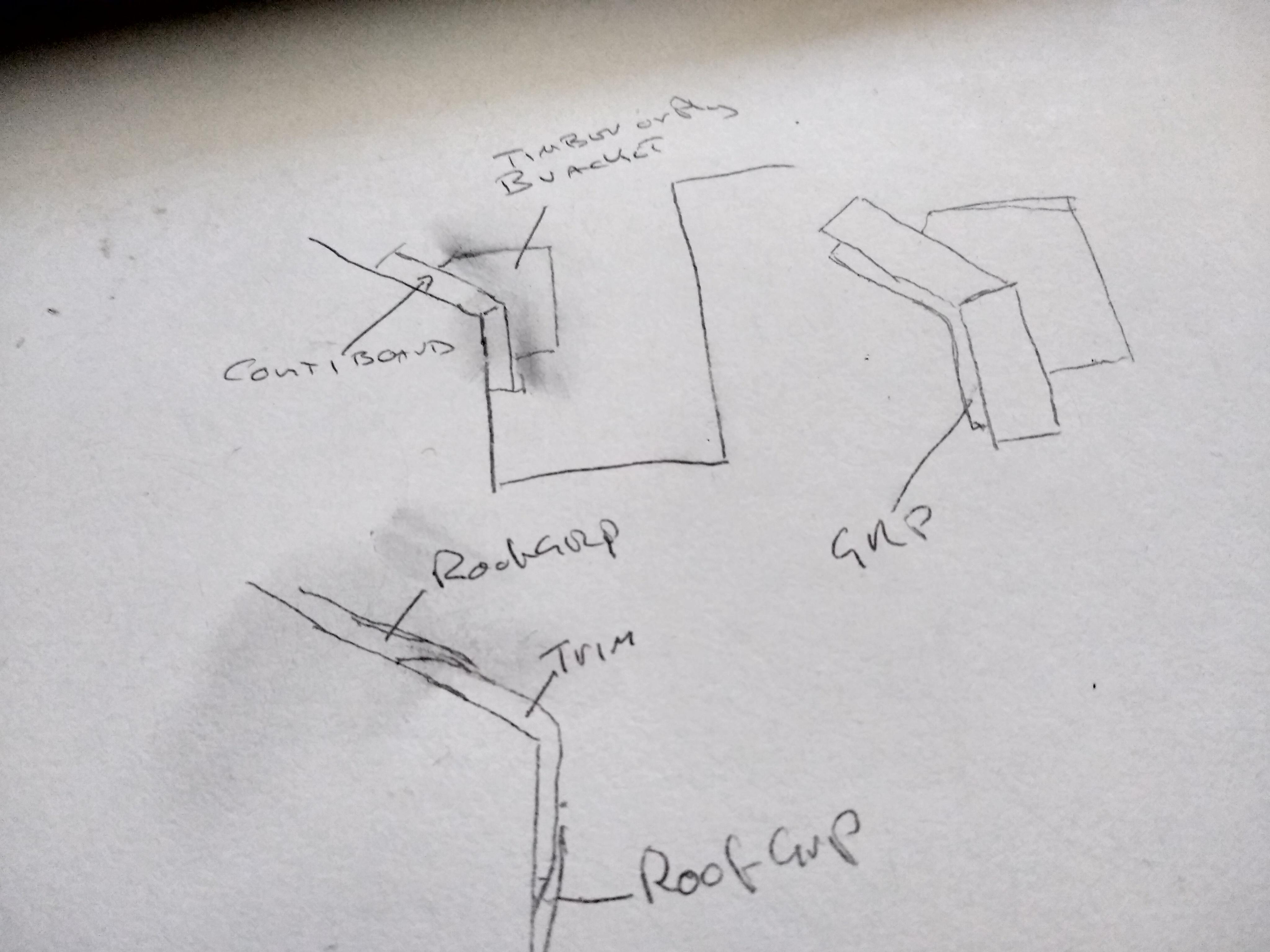

It is easy to work 'into an angle" but not over one.
So it would work fine with the top picture, but would fail with the bottom one.
Cured GRP will always be under stress if bend it, so using pre-moulded 90° angle is out on the lower diagram.
The ways around it are to radius the eternal angle, a 50mm radius should be OK.
Alternatively, get some trip made up that is the right angle.  A simple mould can be made on site by place a couple of strips of Contiboard over the angle and joining them together.
Then laying up on the inside of that new mould, release and stick in place.  Then the roof layup overlaps he edges.
