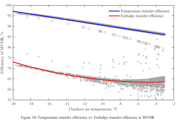

MortarThePoint Posted May 28, 2021 Author Share Posted May 28, 2021 (edited) Thus far I have only found the graph below which is in someone's academic thesis and based on Stockholm where it is much colder. The temperature transfer efficiency is looking pretty linear and taking it as 87% at -4C and 95% at -16C it would be about 80% at 6C. These curves are suspiciously absent from the sales literature of MVHR systems though to verify. Blauberg Komfort Ultr 64-72% I can see heat recovery efficiency vs flow rate: Edited May 28, 2021 by MortarThePoint Link to comment Share on other sites More sharing options...
saveasteading Posted May 28, 2021 Share Posted May 28, 2021 You are right that it was that calculator: probably not very accurate but was enough to show me the logic. That attachment of yours shows the same, that the efficiency is 90% (more like 80% really?) when it is 0C outside. None of the sales literature I had seen mentioned this. Do you know what the downward curve is? I would like to see the graph extended into positive temperatures. I am now almost decided that to spend £8k on a heat exchanger is not for me, whether it ticks boxes or not. That buys an awful lot of insulation, for example, with no running or maintenance costs. If it is stuffy I will open some of the trickle vents. If it is cold I will close them. Fortunately, the air is pure and filtering is not an issue. Also, for a conversion we only have to take 'reasonable' steps to efficiency, and that includes cost. In my opinion the next best thing for energy saving, after airtightness and insulation, comes entrance porches for an air-lock when doors are opened in a howling winter gale. 1 Link to comment Share on other sites More sharing options...

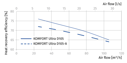

MortarThePoint Posted May 28, 2021 Author Share Posted May 28, 2021 16 minutes ago, MortarThePoint said: Blauberg Komfort Ultr That was a pretty weedy and cheap system. Looking at a more expensive Blauberg unit the numbers are better (below). The blue shaded text suggests the efficiency is quite flat with outside temperature, varying much more with flow rate which makes sense as that is what impacts the 'thermalisation' time. Blauberg EC S5B 270 £1250 Link to comment Share on other sites More sharing options...
