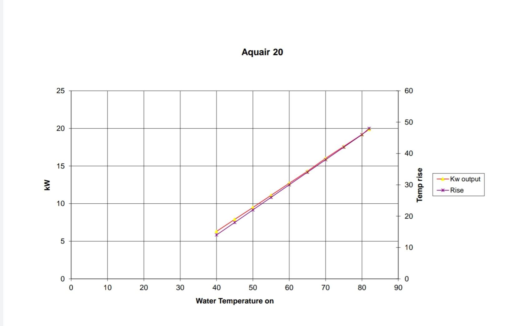

I contacted Johnson Starley about heat output using ASHP. They provided this graph, so at 40C water temp it would mean upgrading the Aquair unit. But ASHP could provide option for mixing with DHW and wet heating in extention. I am not sure how ASHP will work with multiple Zones requesting heat. E. G. Warm air in main house and UFH in extention both running off ASHP.
Base the power calculation on the same flow temperature i.e. 40°C, then adjust floor insulation in the extension, along with pipe spacing, to suit.
