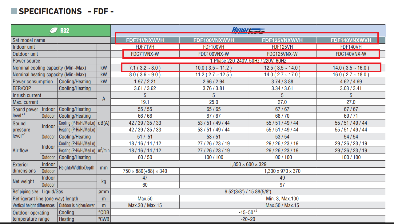

These units do modulate a lot so overspec is not bad, e.g. our 14kW Mitsubishi can modulate 5.0 to 14.5kw
Do you mean that it can modulate by a ratio of 5:1 ie. a 14kw could modulate down to 2.8kw? Reading other posts about ASHP's it seems that the modulation ratios are normally quite narrow (ie. 2:1). A 5:1 ratio would be brilliant.
That should be 5.0kw to 14.5kw so approx 3:1 modulation

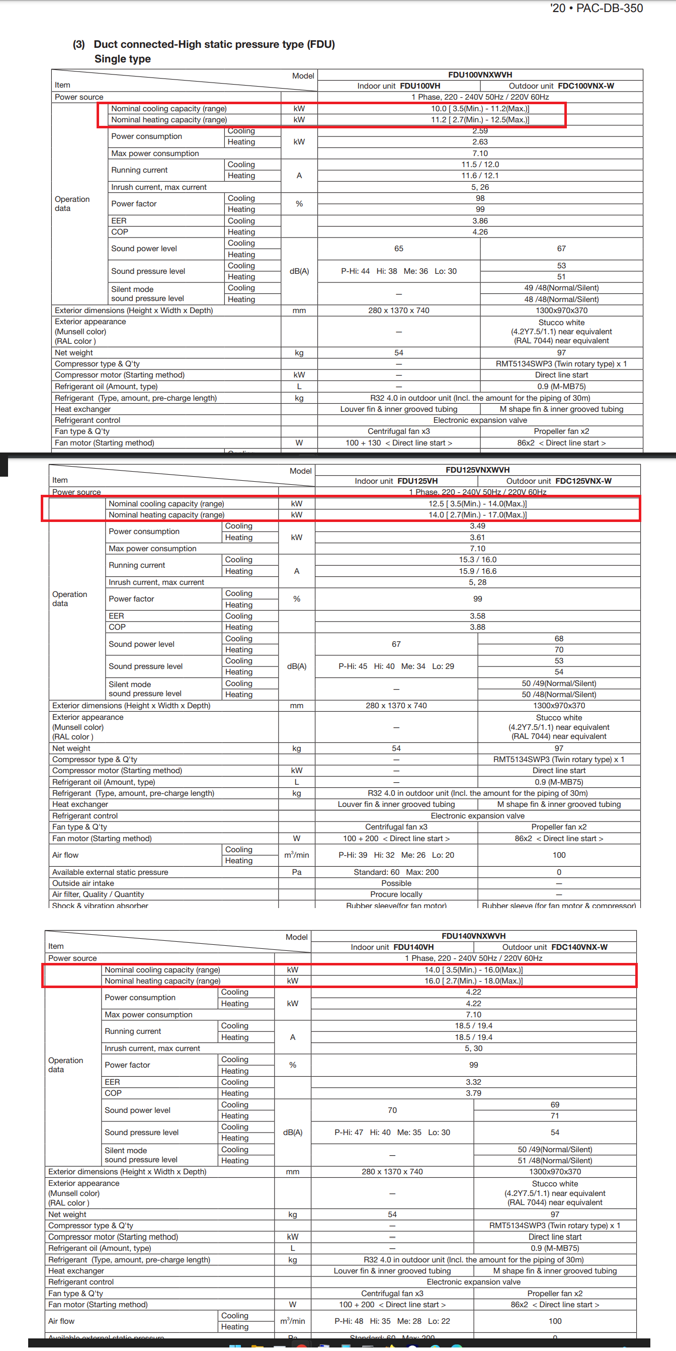

Check the data book
https://www.hrponline.co.uk/media/pdf/a5/7f/f2/20_PAC_DB_350_Data_book.pdf

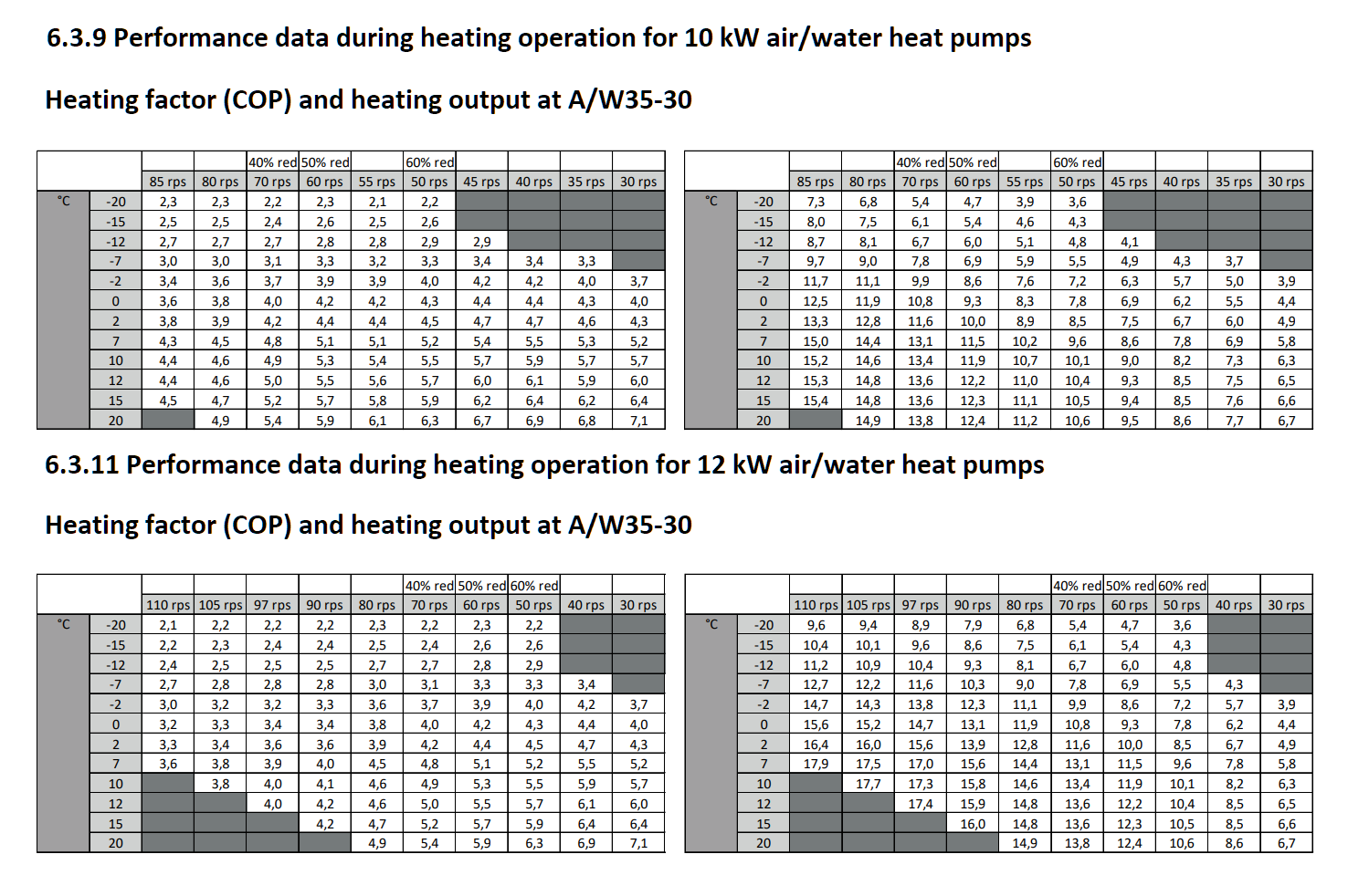

Keep in mind the 2:1 modulation you read about is from the air/water hp topics, the A/A has to deal only with 20C air in which the refrigerant has to condense, whilst the A/W refrigerant has to condense in range of temperatures from 20 to 50 ish. Thus make it impossible for the A/W to use the whole range modulation of the compressor/refrigerant pressure.
The 10-12-14 kW A/A discussed here have the same compressor, basically being the same double fan unit. The data sheet says it's minimum can be 3kW.

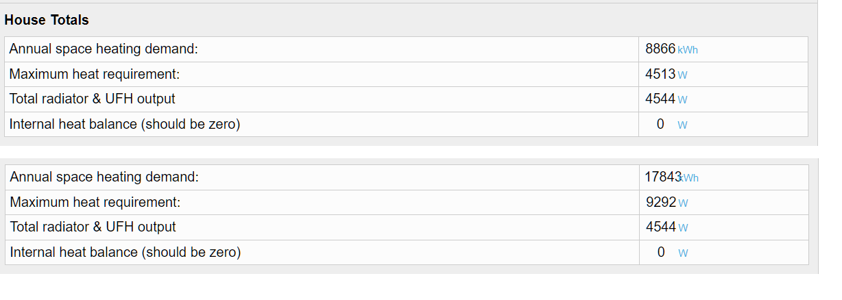

Before anything else you should focus only on a proper professional heat loss calculation, only then look for quotes. Without that it's like trying to put a V8 in a Mercedes A class. So what do you have A, C, E, S class?
Getting quotes from ANYONE has been so painful. I don't know if this is others experiences, but we've approached so many engineers and just found it really hard. The 2 quotes we now have actually both seem very good, both guys seem to really know their stuff (but not so much the MCS side - it's more commercial air con). I'm sort of torn because by having two different ducted zones - the upstairs and downstairs (now after talking to him again this will be a 12kw downstairs and 8kw upstairs) - there should be some ability to further control the overall energy use by just turning on one zone - so cooling the upstairs only or heating the downstairs only for example.
I did have a stab at trying to complete @Jeremy Harris's Heat Loss Spreadsheet - I've inputted for just the ground floor - I've made an assumption at 5 ACH (no idea if this is right, but it's not going to be a very airtight building); using pessimistic assumptions - ie. running at -5 degrees with a 20 degree indoor temp... that gives a Total Energy Required per day of 259kw/h. I don't really understand what I'm doing, but have assumed that a 12kw pump x 24 hrs gives a total output of 288kw/h - therefore is sized about correctly for the floor, given that it can modulate down as well in milder weather? If anyone wants to jump in and check that spreadsheet or my basic logic above that would be appreciated.
@DanDee - the other interesting thing from the HRP manual you posted above  - which I hadn't fully grasped - is that the output for cooling and heating is rated differently. Do you know which of the output's is used to "label" the  unit model? ie. would they call it a 12kw unit because it delivers max 12kw of cooling (but it would deliver max 14kw of heating)?

I didn't know that there was such a difference between the A2A and A2W units... so am I reading it correctly that the larger units (ie. the 14kw) can effectively modulate to a greater degree than the smaller ones (ie. because the minimum output is the same on them both) - That would be pretty neat giving a ratio of 6:1 in cooling mode for the 14kw? It sort of supports what my engineer has been saying - that there are less downsides to oversizing than undersizing the ducted A2A unit in this case. Appreciate that a full set of room heat loss calcs is the proper way to do it, but AC engineers don't seem to use them / seem to go off a rule of thumb approach
Keep in mind, the A/W albeit limited in modulation, it runs in a range where the COP is at its best. It might even be designed as such.
The A/A is free to use the whole range, but the portion toward the maximum is at a lower COP that rated(10kW).
Always look at the output data of the unit for the -5..-7..-10C it is lower than rated a 7C.
This is an example from the Vaillant A/W of two sizes using the same unit, with the extra compressor speed modulation at the top, putting out the extra power.
Yes with A/A is always like that, the rated  label matches the cooling rated capacity
Have I got the basics of the heat loss spreadsheet right - ie. pick a given Delta T (outside & inside temperatures) and then compare the "Total required energy per day" to the output of the pump x 24(ie. 24 hours)?
I've put in all the correct u-values, window sizes etc.
I don't have experience with this in order to give you a proper answer.
From what I've seen around, the wrong number(ACH) can drive up(double) the required capacity. The general number(if rule of thumb) of ACH is quite high vs the reality. Just to give you my understanding of 5ACH=1air change per 12 minutes, I doubt your house goes from 20 to whatever temp is outside in 12 minutes, with all windows closed and no active heating.
https://trystanlea.org.uk/roombyroomheatloss2
https://openenergymonitor.org/heatlossjs/
I've changed the ACH to 5 in this table and it doubled the requirement
